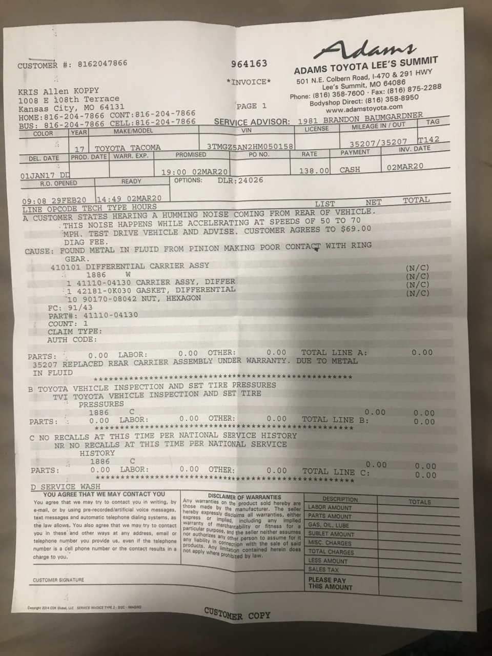

    Mine was just redone and quiet as a mouse now. Hope it stays that way.

    High probability it will come back after the gears break in. Just be prepared!

    JK. I know we've seen that happen nearly every time so far I think. Here's to hoping.

    He's right though, had 2 whole diffs replaced in my 16 and still came back a few thousand miles later.
