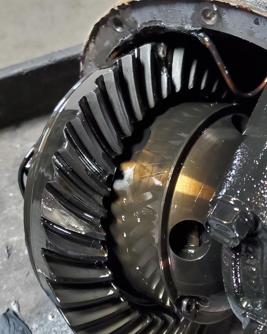

    Mine has been howling on decel at 65+ for a long time. Barely louder than the MT's. I haven't thought much of it, I knew my pattern and BL was perfect, but I started to hear a light clunking at low speeds. Pulled the diff to inspect and found a couple of broken teeth. I think maybe 35's, offroading, and the 8" diff don't love each other :rofl:
    I'm stunned at how little noise this was making though.

    You don't have stock ring and pinion though right?
  12. Mar 12, 2020 at 11:39 AM
    #5792
    monkeyevil
    monkeyevil Victory 4x4
    Sep 12, 2016
    #197124
    953
    Daryl
    Kalamazoo, MI
    No, I don't. But they were properly set up and high quality. I'm wondering if the housing design or driveshaft has something to do with the noise people are hearing. Maybe the cuts of these gears (stock and aftermarket) make noise at a certain mesh and something is amplifying it.
    I've set up a lot of gears and checked a lot of OEM setups and I've seen some HORRIBLE setups in new vehicles. So I wouldn't be surprised if there is some weird variance.
