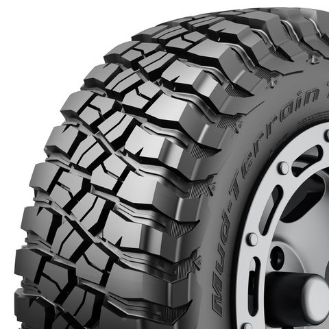

    For months I jokingly said this is nothing a good set of mud tires won’t fix! But, sadly, my truck had a lot of other issues so I decided to bail, but stay on top of this issue in hopes it’ll get resolved because I’d like another one.
