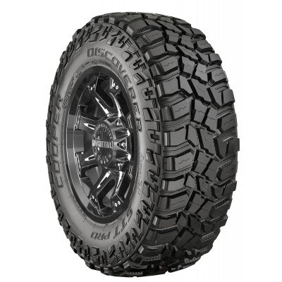

  14. Apr 14, 2020 at 4:55 PM
    #5854
    StillNoPickles
    StillNoPickles Well-Known Member
    Dec 14, 2013
    #118564
    1,011
    2020 RAV4 Hybrid LE
    Metallica and mud terrains.
