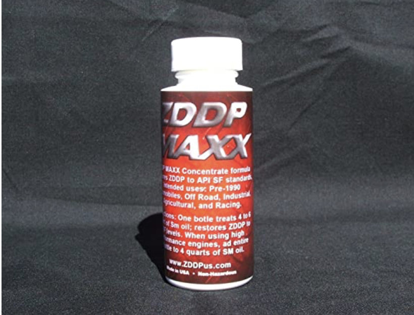

    I'd like to do a little follow up on my 2020. My 2013 , which I loved, never had any type of wind noise/whine. So when I bought this one, it was upsetting to hear the "whine". I then did the research here on the rear diff noise, I decided to let the dealer service dept. know my concerns. At the dealer, and I was very prompt for the appointment time of service, I went through the explanation of my concerns regarding the fluids. All of them. I ask for them to check and verify that they were filled to proper levels. I was also there because the trans was constantly hunting for gear and it drove me crazy. Truck had around 2000 miles on ODO. The next morning I was notified the truck was done and ready. OK, picked it up and read over everything that was supposedly done. "reflashed" trans. (or something to that extent), All fuids check normal. Hmmm, I looked at the rear diff, no residue, no wiped down areas, Hmmm. I had doubts of anything being done except for the trans digital reflash whatever.
    Truck now has almost 6K on ODO.
    Raining here today and thanks to CV19 I have no work. So I decided to check fluids myself. It still whines.
    Rear diff accepted one full quart of synthetic gear lube before filled to bottom of hole. (thats a 25% addition).
    Front took almost 1/3 qt. (25% addition)
    transfer case was full.
    I have my doubts on the transmission being filled to recommended level.
    Since I dont have the experience to check it (properly) ( ok, Ill admit I just dont have the desire to go through the B.S. to check it as described here on the forum. And , it doesn't seem to be a very precise way of doing it.)
    I'm debating on just adding 1/2-2/3 qt. and calling it a day. Most here have reported about +-1/2 qt. low.
    if its a little low, it should help, if its at the correct level now, 1/2 qt shouldnt hurt.
    my .02.
    I'm going to drive the truck at whine speeds later and (fingers crossed) , it may help with the noise.
    next step will be the "zddp maxx" snake oil.

    Ordering some snake oil today. Worth a shot since I’ve lost all expectation getting it fixed.

    Is this the stuff?
