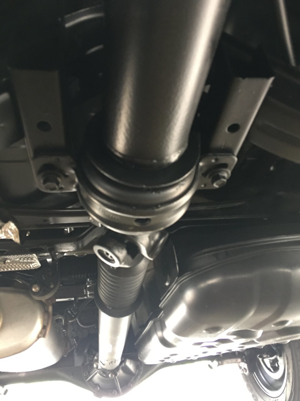

    Just for S&G's I'm going to throw this out there...
    2020 TRD Pro, our first Taco and we love it..
    Inspecting the underside I notice a 2 piece driveshaft with a carrier bearing.
    Conclusion: the carrier bearing, while unloaded (coasting), transfers rotational reverberations which are transmitted through the bed, which acts as a speaker, which amplifies the sound.
    Anyone with a cap or bed cover notice this sound?

  11. Jun 23, 2020 at 8:03 AM
    #6091
    OverlandExpress
    OverlandExpress Well-Known Member
    May 24, 2020
    #329187
    398
    NE Ohio
    2020 Taco TRD PRO
  12. Jun 23, 2020 at 8:15 AM

    zoo truck
    zoo truck Well-Known Member
    Apr 21, 2020
    #325379
    8,950
    2020 quicksand sr5 tacoma
    None
    For what its worth i had the same driveshaft arrangement on my 01 tundra as i do on my 2020 taco. The tundra never had a bed cover and the new taco has. Both do not howl. However the tundra had some vibration which was cause by poor factory alignment of the center carrier driveshaft bearing which was corrected by the dealer in warranty.

  14. Jun 23, 2020 at 5:57 PM
    #6094
    dash7510
    dash7510 Member
    Jun 6, 2020
    #330576
    8
    D
    2020 White Tacoma SR 4x4
    UPDATE: I picked my truck up from the dealer this afternoon. The ride home was very quiet. I checked under the car and all looks good. I thought they were going to replace the whole rear end and man was I wondering how they were going to get it back to me so quickly. However, they only replaced the center portion that comes out the front and attaches to the drive shaft. I believe it is called the carrier section. Let's hope it stays quiet.
