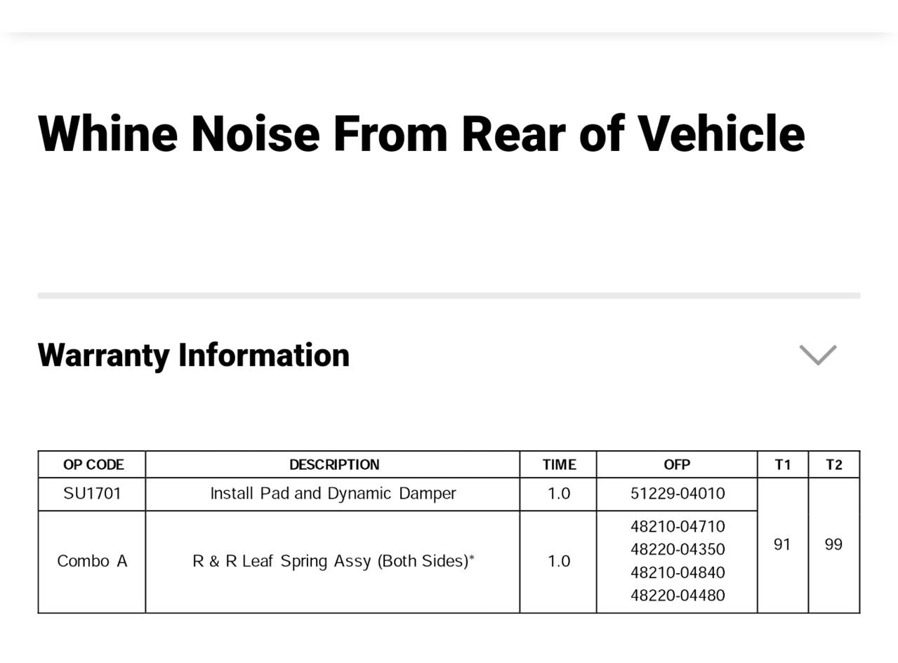

    Anyone have the part numbers for the dampers?
    Shades_Of_Red[QUOTED] and 05 4x4 like this.

    Thank You.

    Did Toyota cover the warranty work for installing the dynamic damper?
    For a 3rd gen Tacoma? Most importantly did the dynamic dampener help at all, they go for about 100 each online.

    I recently installed the body mount dampers on mine that are part of the tsb. In my case I havent noticed any difference at all. I feel that I wasted $200. It might possibly vary from truck to truck which area is causing it since they also replace the leaf springs also with the tsb.

    The tsb im aware of replaces the leaf springs and adds dampers to the rear cab mounts for this issue. Tsb 0013-18
