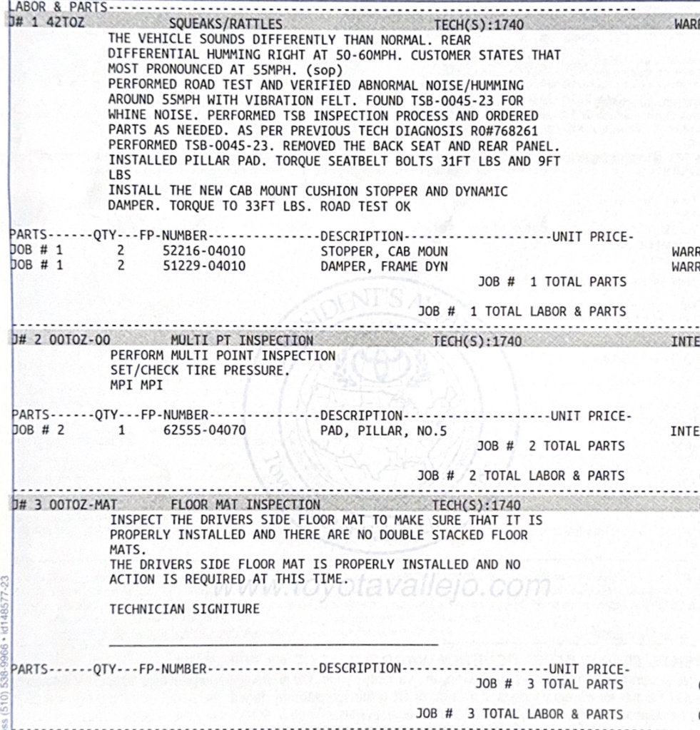

  18. Sep 7, 2024 at 2:56 PM
    #6378
    emacTR4
    emacTR4 Member
    Feb 6, 2024
    #443283
    16
    I just got my truck back from the dealership after they completed the TSB, and I can confirm that the vibration noise is indeed coming from the cab. While it’s not completely gone, I'd say about 90% of the noise has been eliminated. You won’t notice it unless the radio and AC are off, and you really make an effort to listen closely.
  19. Sep 12, 2024 at 4:24 PM
    #6379
    NE-Taco66
    NE-Taco66 Well-Known Member
    Apr 12, 2021
    #362433
    206
    2023 TRD OR DCSB MGM
    good to know, thanks for posting this. I haven't had the chance to call them. Some days the humming is worse than others but it really isnt horrible, just sometimes annoying. I'm surprised its really coming from the cab it definitely sounds like its coming from the rear of the truck.
