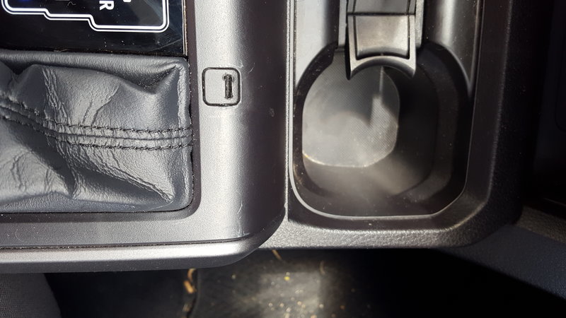

    I got my new diff installed yesterday. No noticable howl at first but with the a/c off and the radio off right at 55mph you can hear it change pitch when you feather the throttle. It's very faint. On top of that the service department scratched the plastic around my gear shift. I called this morning to notify the service writer and have another appointment set up for Monday. I am more pissed about the scratches in the plastic than the diff still making noise. Looks worse in person.

    Why the f--k did they mess with your gearshifter

    No clue. I noticed it today when I got in the truck. I can only assume they popped that piece out to put it in neutral for some reason. Either way it was unnecessary and I have called and complained.
