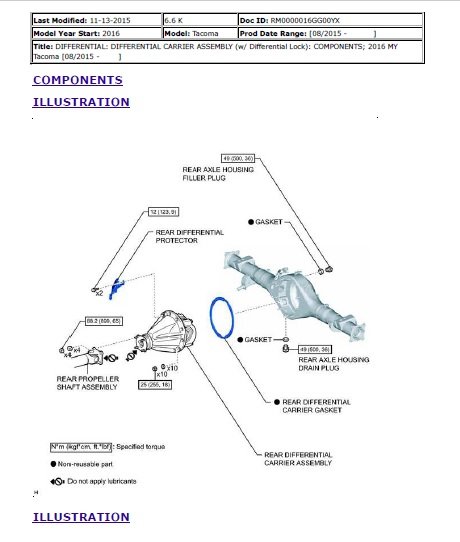

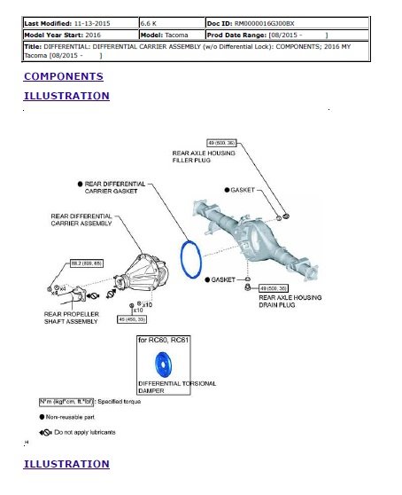

    Found this comparison interesting; middle one shows a torsional damper.
    I wonder codes RC60 and RC61 are?
    With locker
    Without locker
