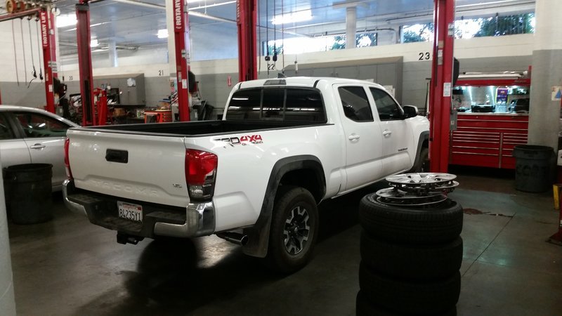

    They test drove my truck today and were able to replicate the howling sound. They changed the diff fluid and are test driving it again.
    And they changed the engine oil under Toyota Care. I didn't want this done because we are going wheeling tomorrow but my wife took it in this morning and agreed to it. Ehh

    So the dealership won't let me leave in the vehicle. They serviced it today and test drove for the differential howl. The tech didn't like it so he lifted the truck on the hoist and drove the wheels between 50 and 60 and the noise was much louder. They haven't spoken to Toyota but they would not let me leave in the vehicle. They said it was too much of a liability to allow me to drive it.
    They gave me the max allowance for a rental because I told them I needed a truck. They had an Enterprise guy come pick me up. I assume they could not give me a loaner either because they don't have any left or because Toyota hasn't approved any work.
    So I don't have a truck now. We were supposed to go on a sweet run tomorow with a Facebook group but that's not possible now.

    I didn't add that Toyota told them to change the rear diff fluid. They changed it and test drove it again and it wasn't any better. They will be calling monday morning to get a new differential approved. I hope they can get me a diff quickly so my truck isn't unusable to me for very long. I can only imagine the wait time
    I didn't pay 39100 dollars for my truck to sit in the shop while all my friends are on a fun wheeling trip that I was really looking forward to
