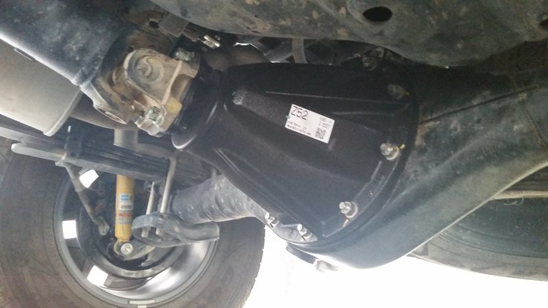

    Picking it up now. We'll see.

    All done. They said the howling won't come back...

    what did they say they did to fix it?

    Only drove 2.5 miles home. Never got to highway speeds. I'll be driving tomorrow to work and it always does it down two freeway hills, so I'll see
    Replaced carrier, gasket, and diff fluid. Test driven by mechanic and no noises.
