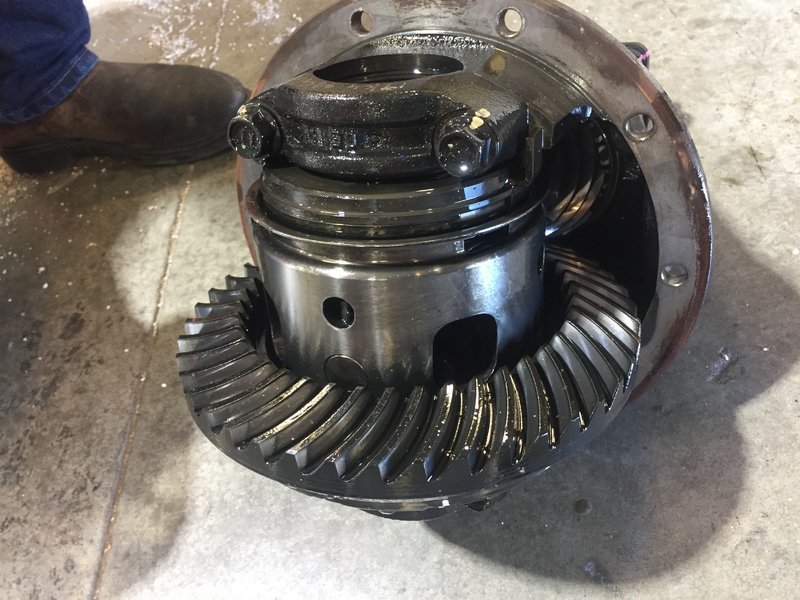

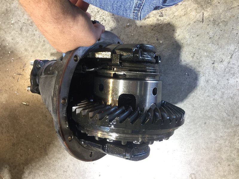

    Well I got mine replaced today. Broke it in the way I have always done new gears. 15-20 miles cool down for 30-45 minutes then another 15-20 and cool down to work harden the gear faces. Seems to be good but time will tell. Really wanted to bench test them but was not able to. Did inspect the gear pattern with some grease and it was good on the original differential. Both gear sets were factory checked in 3 locations for gear pattern. You could still see traces of the yellow check die on the original differential believe it or not. All the bearings that we could see with out disassembling looked pretty good as well. The housing was also clean with no more metal than normal break in would cause.
    Few pictures of the 4.30:1 8.75" / locker for y'all IMG_2608.jpgIMG_2610.jpg IMG_2609.jpg
