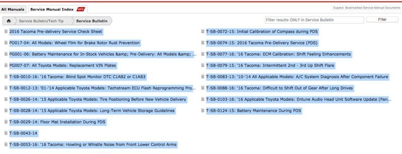

    I'd like to see the TSB PDF before I get excited. It seems like this one is a bust--and its a heat shield issue with manual tranny tacos. It doesn't even sound like they are addressing the same concern as we all have. (which is even more frustrating..you'll fix that?? Some BS heat shield manual tranny issue no one has complained about, but not this major issue that hundreds of people on TW are complaining about?? JFC)
    shakerhood likes this.

    Thought id share all the updated tsb as of now...
    smitty99[OP] and AdventureKid like this.
