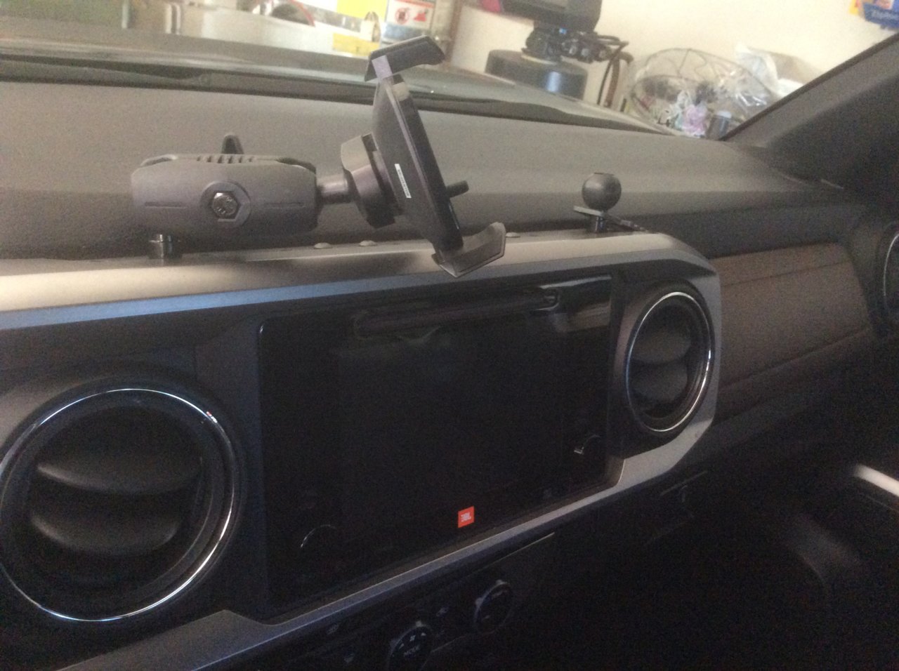

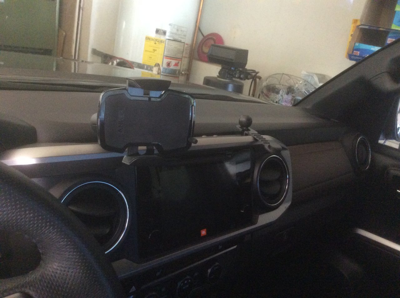

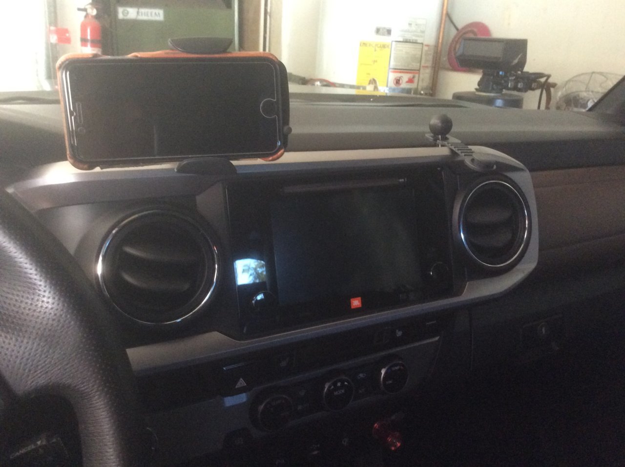

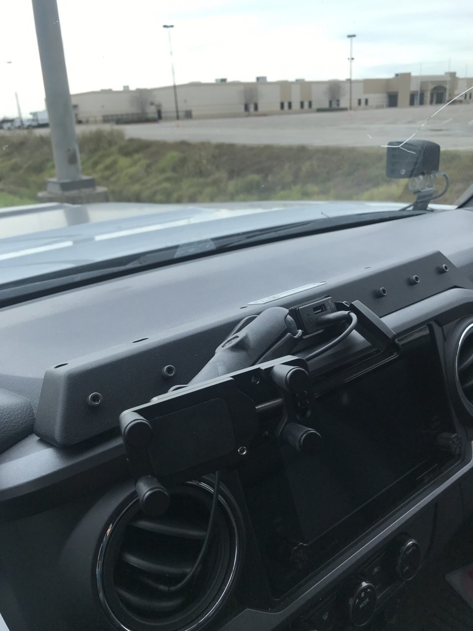

    AF101AB1-CC22-488E-8E74-9045BEABFA26.jpg BD157434-7A95-46E7-982E-5C98DB1351FE.jpg BA9CD5F2-83BB-47AE-BE5B-A5887A4D5489.jpg I also installed Taco Garage dashtop multi mount with Anker phone mount. It is clear of the vent and touch screen and probably 2-3 inches clear of the steering wheel with the short double ball Ram mount.

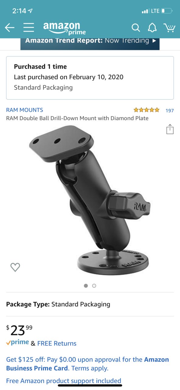

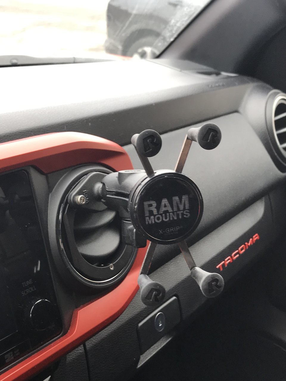

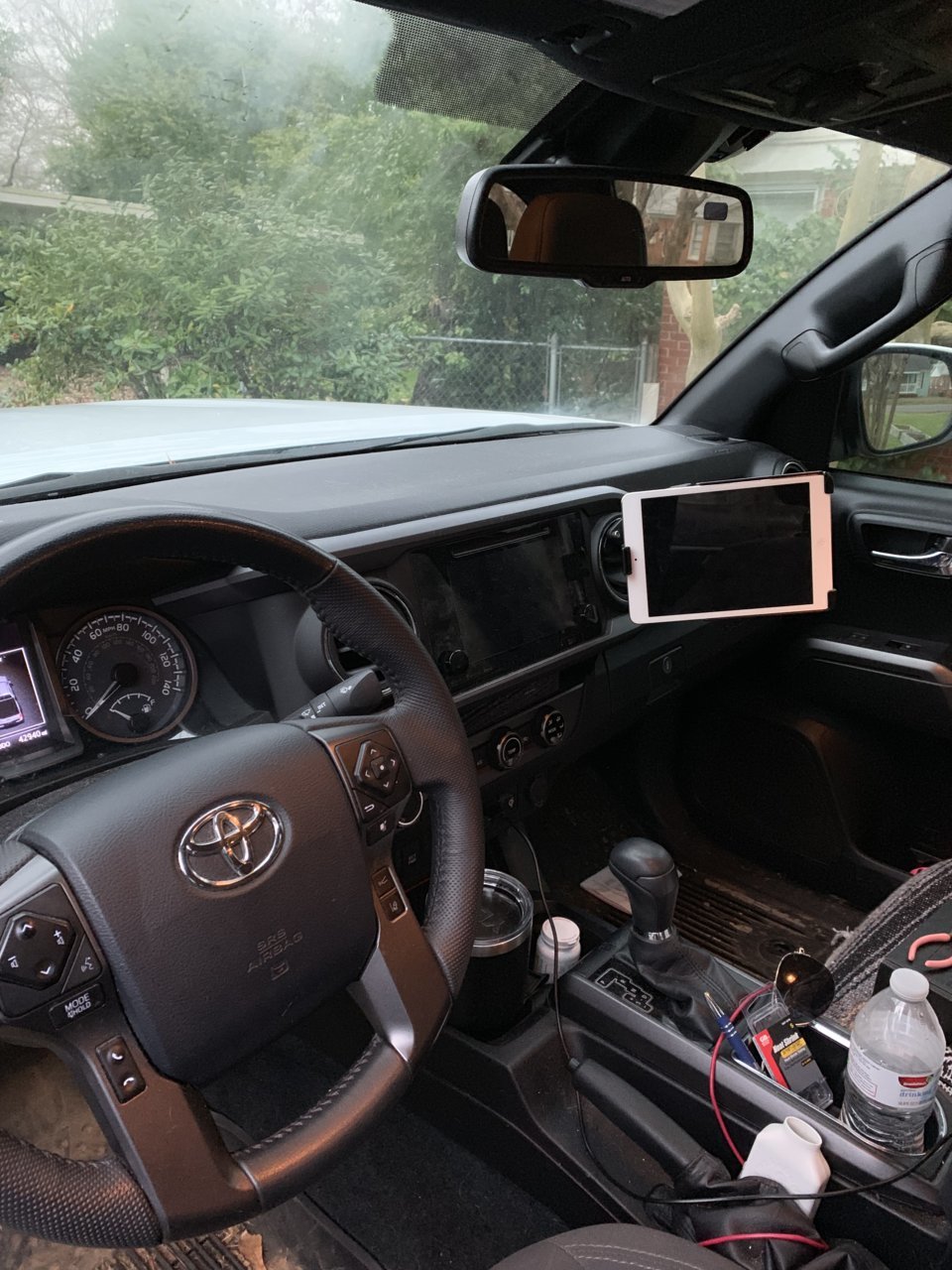

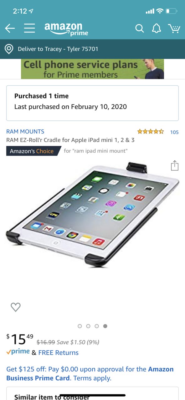

    I just caved and ordered the Hondo vent mount. Can’t find anything else less invasive that looks as sturdy. Ordered a mount(the part of it that actually holds the device) specific for the iPad I’m gonna use on Amazon for cheap. 757661B6-E008-493D-BA27-A829305FD1EA.jpg 228D8D7E-3D12-45BD-81B6-9A055283396B.jpg Couldn’t stomach the $159 tablet option from hondo.

    Mounted and it works like a charm. May get a more articulated arm2721BC55-9A41-4D5D-A119-5E4EA9217970.jpg

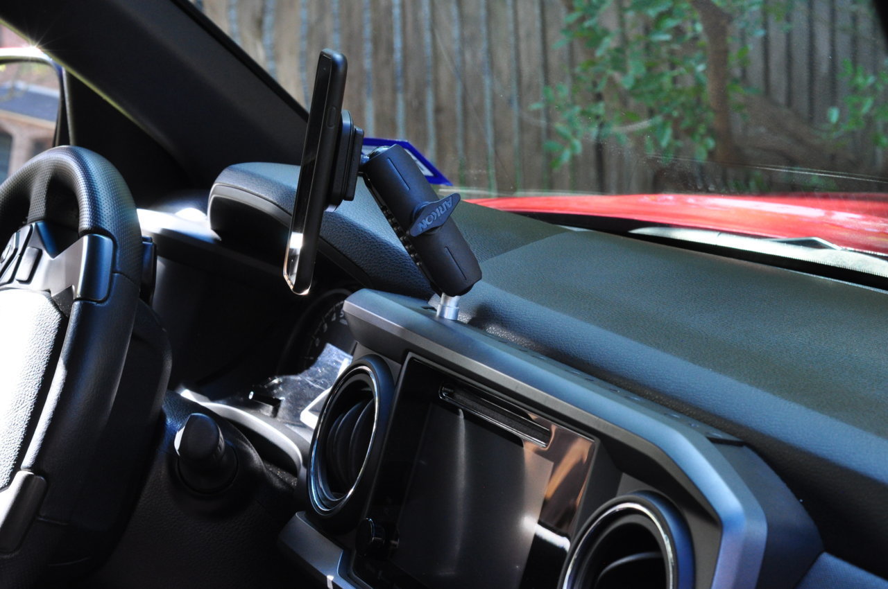

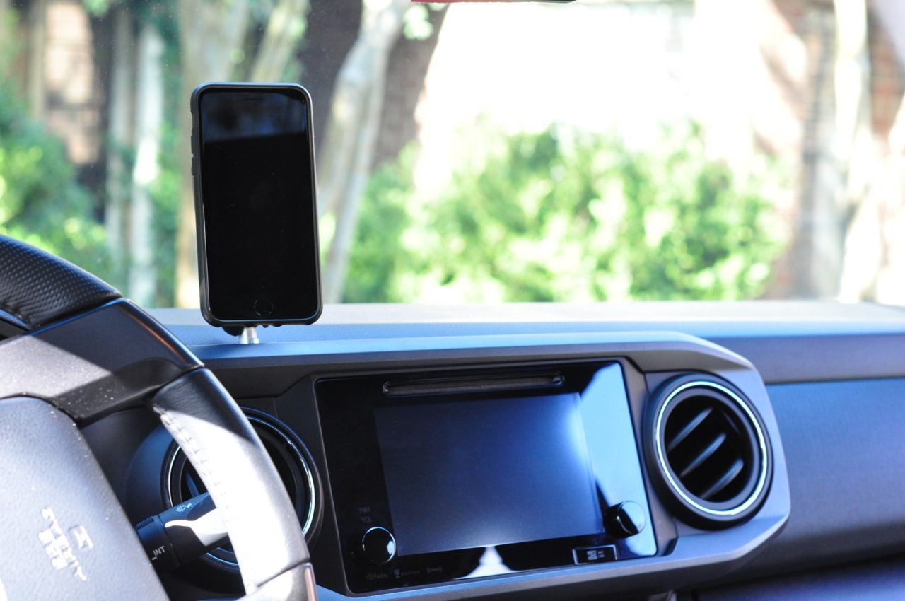

    I just drilled a hole in the infotainment bezel. The hole really is out of the way and if I have remove the Ram ball, I have small flat black push in trim buttons that would make it look factory. I'd likely drill a 2nd hole spaced equally so they look like it was intended.
    I did cut a piece of sheet metal and epoxied it under the hole. It was fairly stout w/o it, but now it's very stout. Zero worries about the benzel cracking from any stress. I also painted the shank of the ball black vs. the raw aluminum they come in.
    I like the location of the phone for viewing and it doesn't block either my vent or view of the infotainment screen. I can also turn the vent towards my phone to cool it on hot Florida travel days.

    Would you be comfortable with a lock nut and lock washer without a piece of sheet metal? I’m considering doing the drill into the bezel method like you did if my DSM doesn’t come in before my trip in a few weeks, but I don’t have any spare sheet metal.
