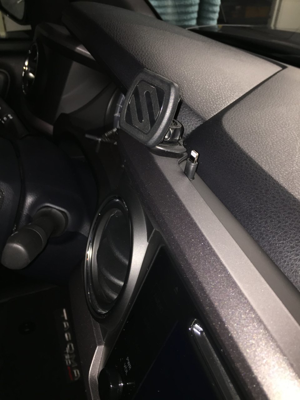

    Where did you plug the wire into?

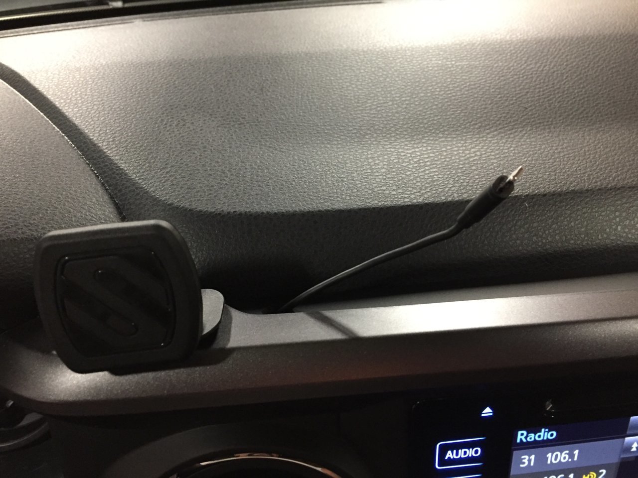

    I did not eliminate the original USB, I just left it behind the dashboard with the wire plugged in and just added a new USB for other things. Doing that I don't have to have wires going up in the front.

    How did you tie into the existing power?

    Just a regular splice to the original USB outlet
