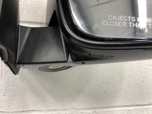

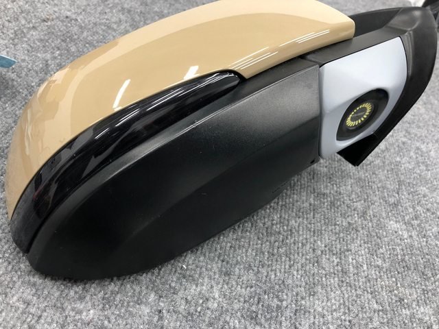

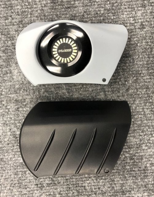

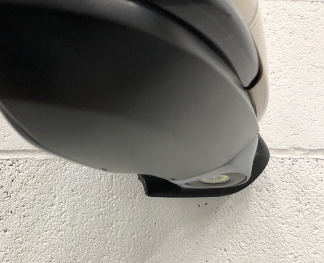

    It is but my vendor actually makes kits for other vehicles with just the needed parts to make the Power Folding feature. They just don’t make them for the Tacoma because there hasn’t been a need until “Now”. Therefore, that is why I am working with them to get something going so there will be something that I can get and provide to all of you :) Therefore, a whole new mirror set is not required for this mod. Internal wiring and space is the same. You will see when I post up all of my pics the similarities and how this works.

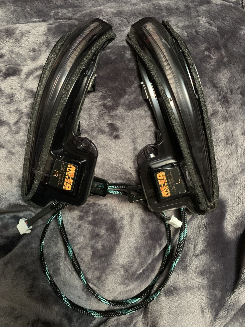

    My Ultimate Side Mirror Build
    I too started off with ME-SO Customs V4 Blacked Out Ultimate Turn Signals myself. Then I opened those up and made the ME-SO Customs Blacked Out Ultimate LED Switchback Turn Signals with a collaborative effort with ME-SO. He decided to go with Diode Dynamics LED Strip and I stayed with The Retrofit Source LED Strip. I didn’t really care to have the dimmable feature in my mirrors. However, I have finally reached my last version for my Mirror Turn Signal. I call it the ME-SO Customs Blacked Out Ultimate LED RGB Turn Signals - Thanks to @mesojdm for making his Blacked Out Turn Signal Cover Housings. I absolutely love the blacked out look. It’s so clean and sleek. However, I took it a step further and going off the previous modification with the LED Switchback Turn Signals where I used the Profile Pivot Strip w/ Driver (Switchback) 6”, I decided to go with the Profile Prism Strip w/ Driver (RGB) 6”.
    I can now match my Mirror DRLs with my Headlight DRLs and my three Raptor Lights in my Grill. I absolutely love how ALL my DRLs and my Raptor Lights in front match. It was starting to bother me when I would have my DRLs Amber with my Raptor Lights in my Grill Amber for Morning Fog, but my Mirror Signals are White. I thought, god I would love to be able to have my Mirror Signals match my DRLs and my Raptor Grill Lights. With this modification, I will be able to program them to turn on with the ignition White or I can use my Bluetooth XBT App Controller and program them to any color on the color spectrum wheel, while also having the Switchback feature for the Amber Turn Signal. This means, I will not be using the OEM White and Pink Turn Signal Wires as I will no longer need them inside the Mirror Housing.
    I will also be adding MESO Customs Puddle Lights
    These pics are prototypes so I’m sure there will be some design tweaks before the final product gets released to fit the new smaller LED as well as a “cone” taper to help with light dispersment for more coverage like the 4Runner.
    My last mod I will add to my Ultimate Side Mirror Build will be Side Cameras.

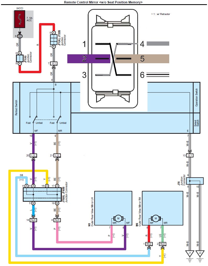

    Using the schematics of a 2007 Tundra for a taste of what's to come...(simplified)
