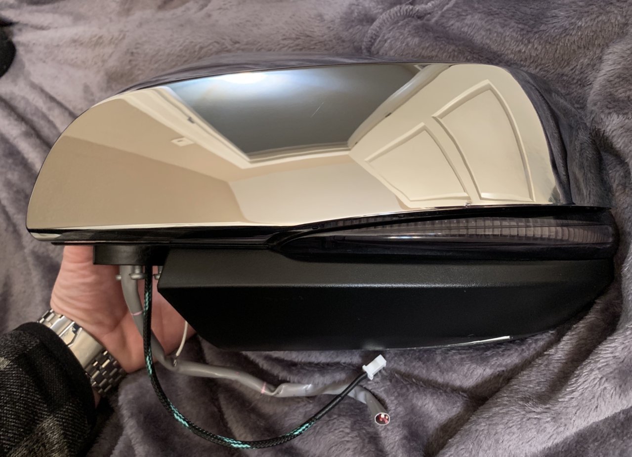

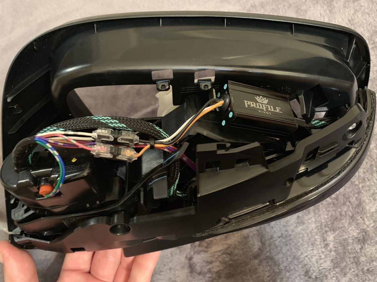

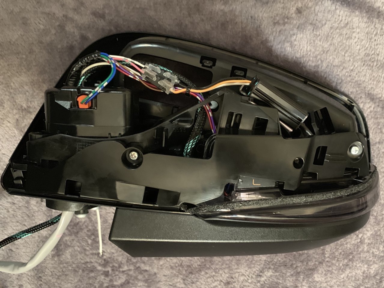

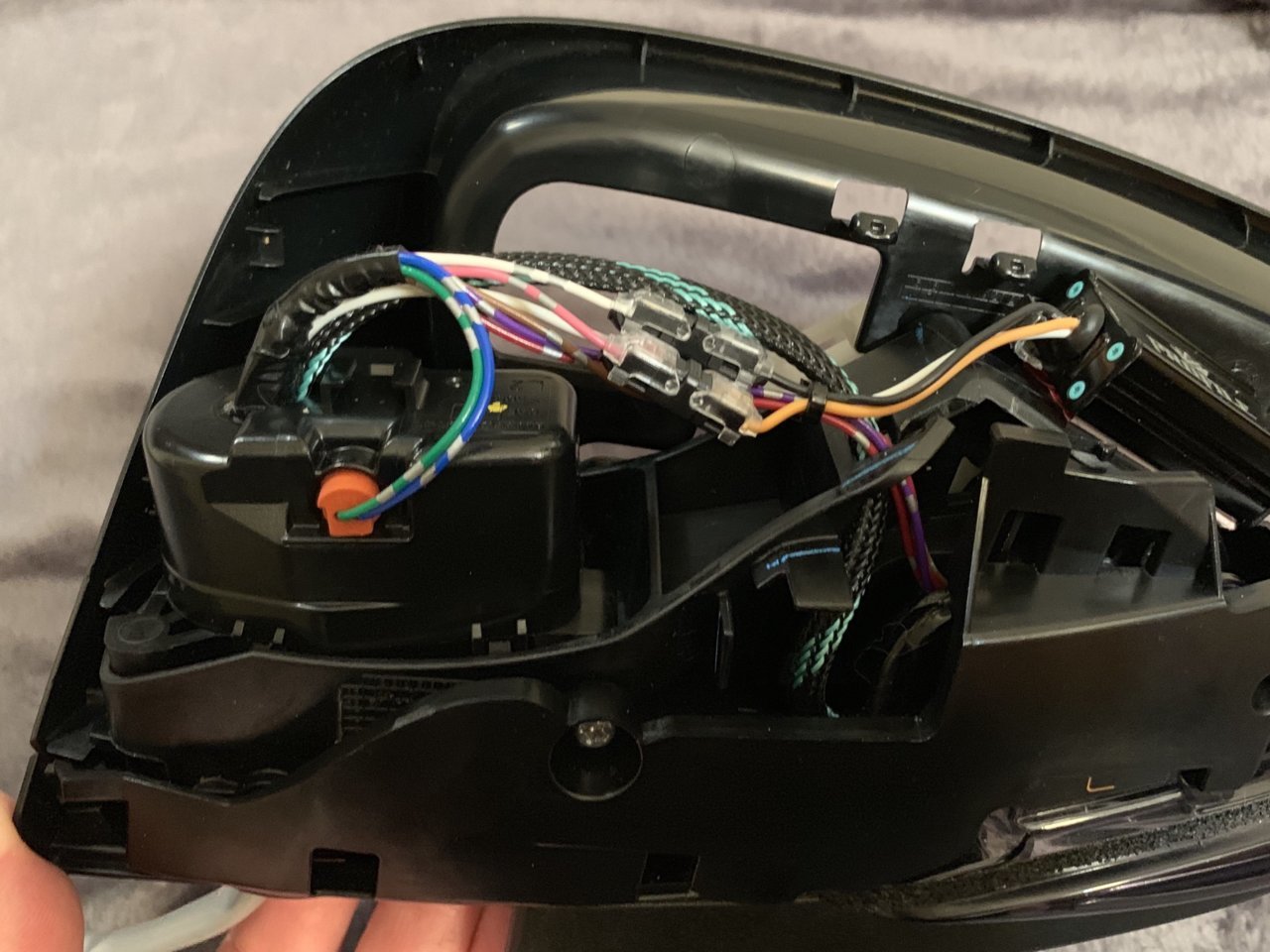

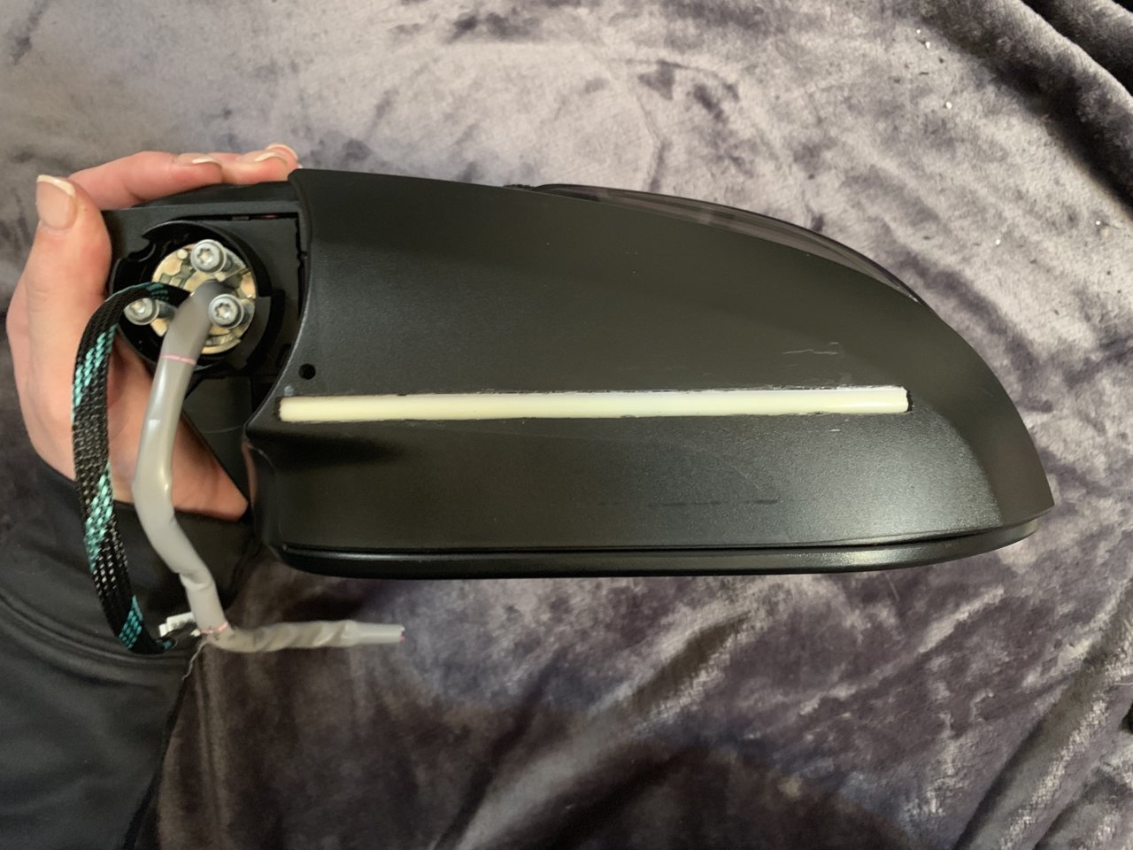

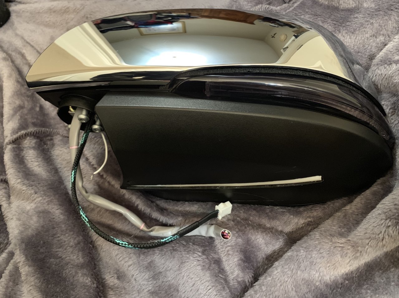

    Alright folks, here is a sneak peak of what I have been able to come up with this weekend in my spare time between going out riding with some friends in my RZR and the Super Bowl Party today.
    Temporary Puddle Light until ME-SO Customs releases “THE” Puddle Light.
    OEM look when the Cover is on. I do not have this cover snapped on as I do not plan on using the Chrome Cover. I may get some Black Vinyl and wrap it to see what it looks like wrapped, but I will for sure have my Barcelona Red Cover when I get my truck back from Toyota.
    I’m waiting to connect the hinge and mirror until the last part. Just makes it easier. Next up is installing the camera into the hinge cover location. That area just seems like the best place. When ME-SO finally comes out with his Puddle Lights, I may have to reconfigure this setup or I might just leave it if I absolutely love how it is. For now, this set up is going to work. :)
    The Puddle Light is Switchback. I have it tapped into the DRL White and Pink Wires so when I use my Blinker, it will flash Amber on the Ground like my Turn Signal in the Mirror. This way if there is a car right beside me, but not far enough up to see my Turn Signal in my Mirror or Headlights, they will see it flashing on the ground. Total awareness is key. The White Wire I will run inside the truck and tap into the Dome Light somewhere. I haven’t decided where. Either the A pillar or I will tap into my side LED Strip Lighting that already comes on under my truck with my Dome Light as Courtesy Lights. My current Courtesy Lights do everything other than fade in and out. When I get close to the truck they come on. When I lock they shut off. When I unlock they turn on.
    My Turn Signal is now RGB so it will match my Headlights and Raptor Lights in my Grill at all times but still have the Amber Switchback for when my Blinker is on. It has its own wire harness that will plug into my XBT Bluetooth Controller. When I turn on my ignition it will come on White, but then I can connect to Bluetooth and change the color to whatever color I would like on the color wheel. Usually it is White, Amber, or Red. When I turn on my Blinker, Amber will cut in from being tapped into my Headlight Turn Signal. When my Blinker goes off, my Mirror Turn Signal will go back to the RGB color I had programmed.
