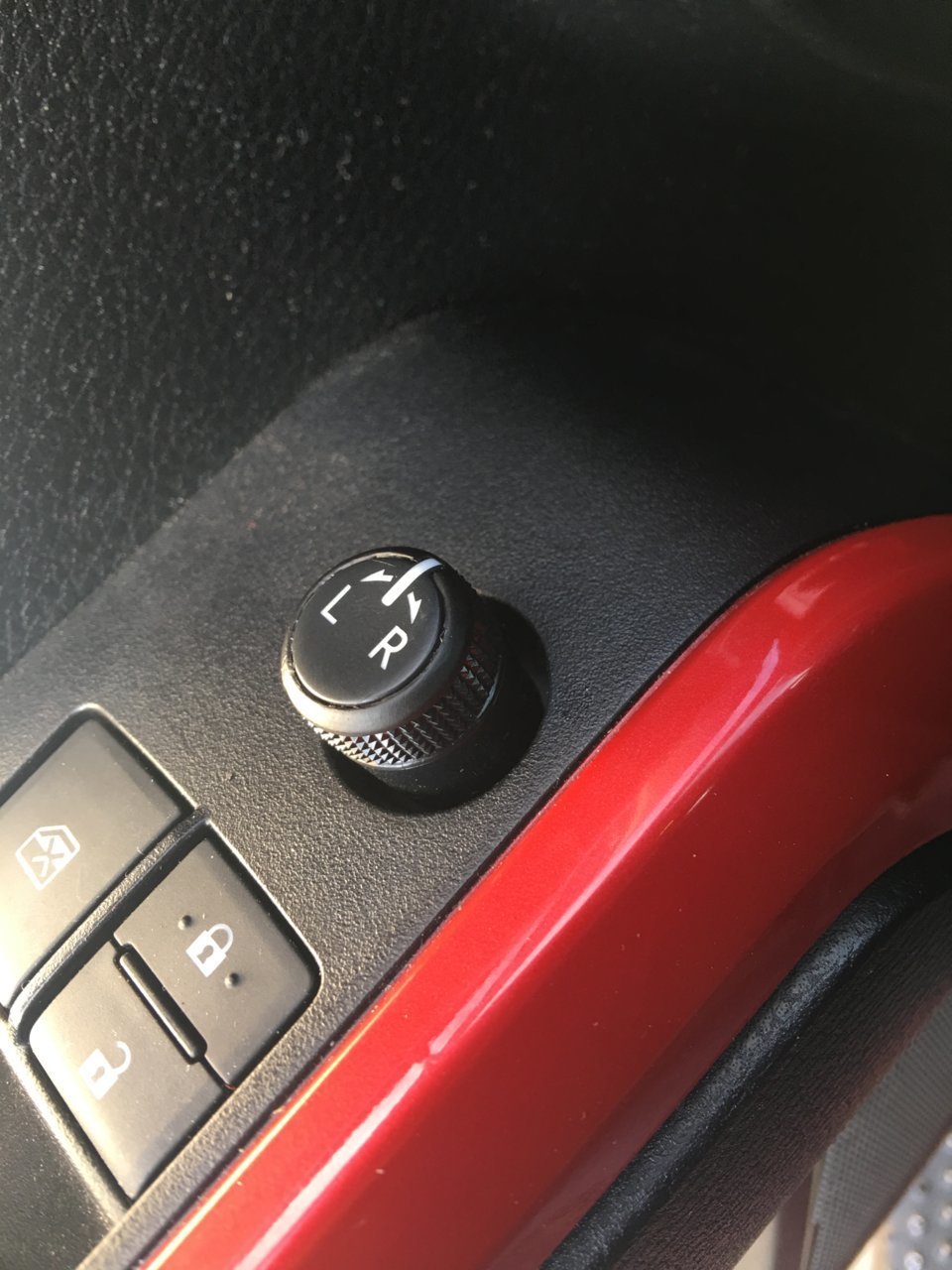

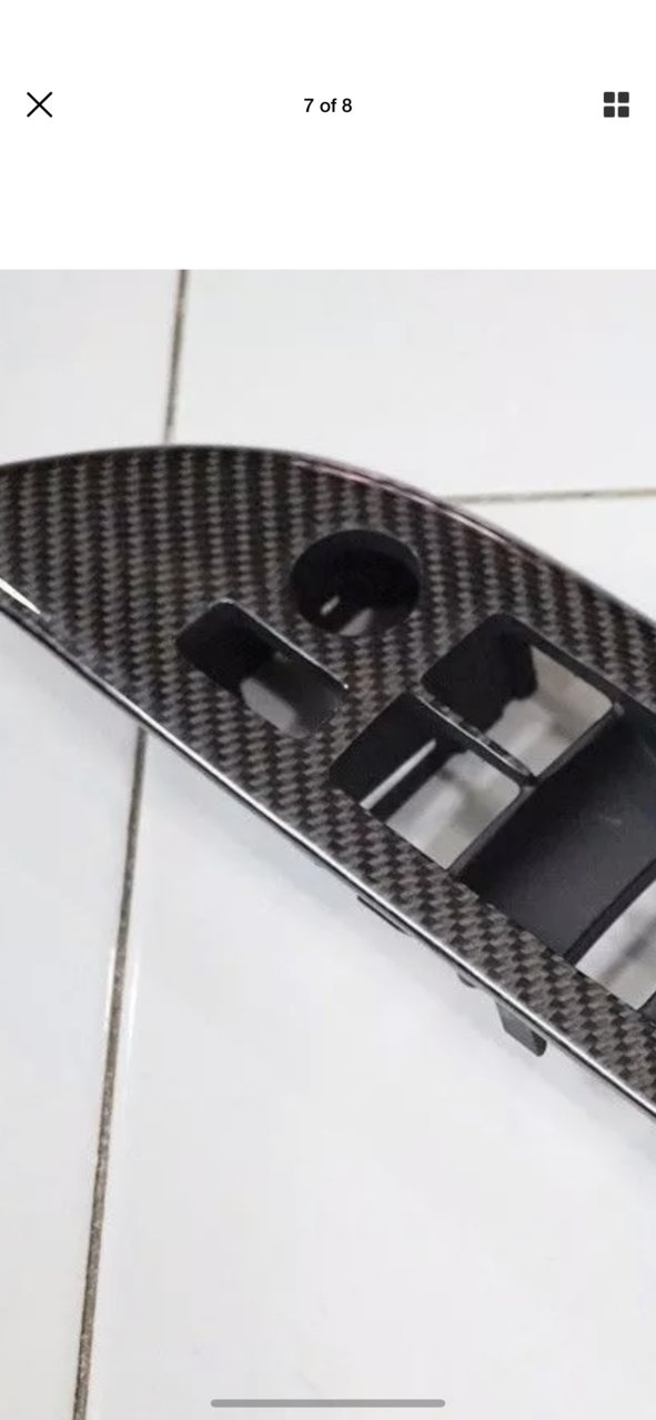

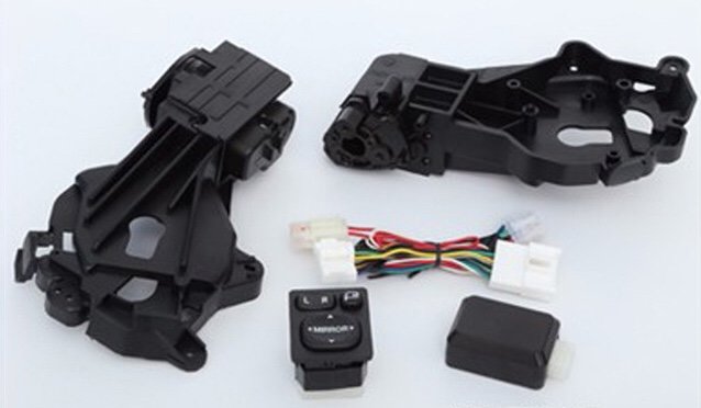

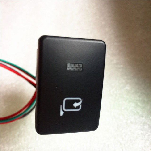

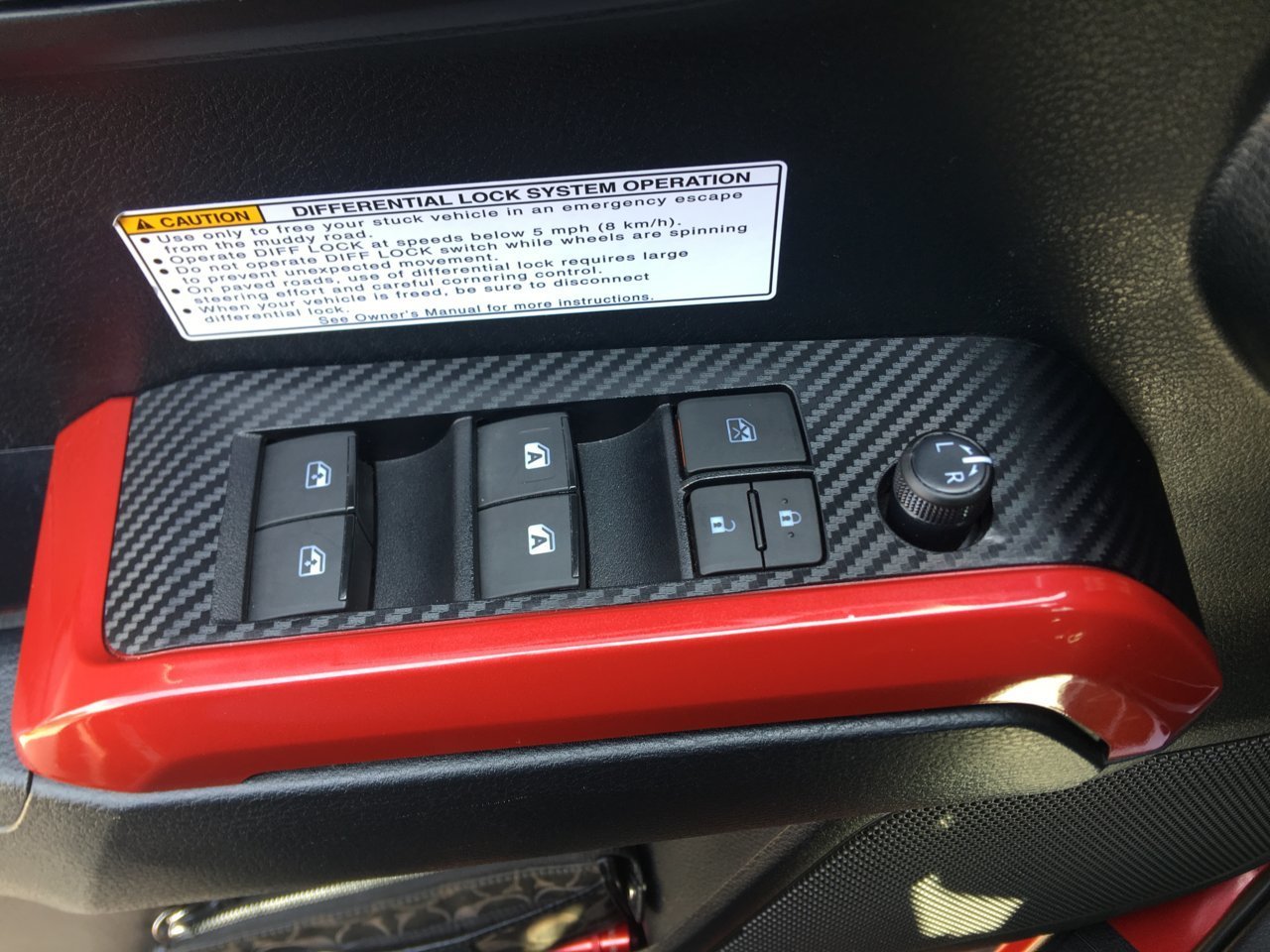

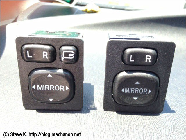

    I do have an inquiry out about getting the switch as well and including that with the mirrors. I’d like to be able to get everything that you would absolutely need for this mod so you wouldn’t have to get anything else other than this kit from me. I do have a question regarding switches. There are two switches that I have currently. I originally purchased the shorter fatter switch button that matches the OEM push buttons.
    That was the route I was originally going to go until I found the switch that is our replacement for our OEM Mirror Adjust Switch. The only problem with the Replacement OEM Switch is that you would need to be willing to make an opening for it because our current panel does not have one.
    Just like the Tundras, they have their OEM Switch (on the right) and then the replacement OEM Switch (on the left).
    Our OEM Switch looks like this...
    Well this is the replacement OEM Switch I have found for the Tacoma...
    This is what our OEM Master Switch Panel currently looks like in the Tacoma...
    This next picture shows you the modification that is needed in order to get our Replacement OEM Switch...
    Finally, this is what the outcome will look like after the modifications are made to our OEM Master Switch Panel (don’t mind the fact that the switch is on the other side in this picture. This Replacement OEM Switch is actually offered for LH and RH Side of the vehicle due to other countries driving on the opposite side of us). However, you can see that it is the exact same as our Tacoma Driver’s Side Master Switch Panel. Also, since our Mirror Adjusting Switch is located on the RH Side, we would have to get the Switch with the Folding Mirror Switch on the LH Side.
    I have personally decided to go the OEM route because I think it will look the cleanest and like it came from the factory. :yay:But....I do have the other switch as a backup if need be. My question would be, which switch would most people be interested in for this kit if I offer a Switch?

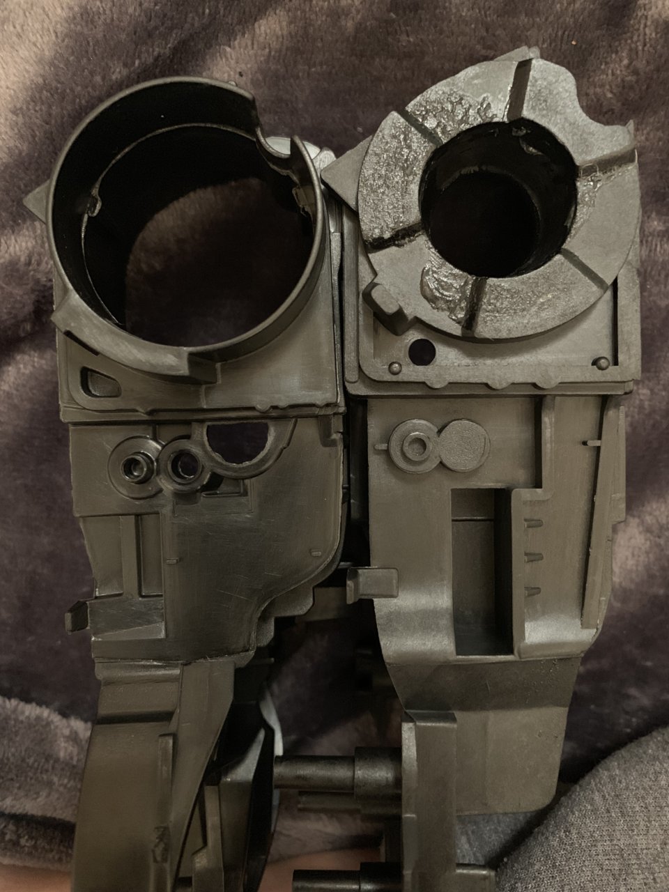

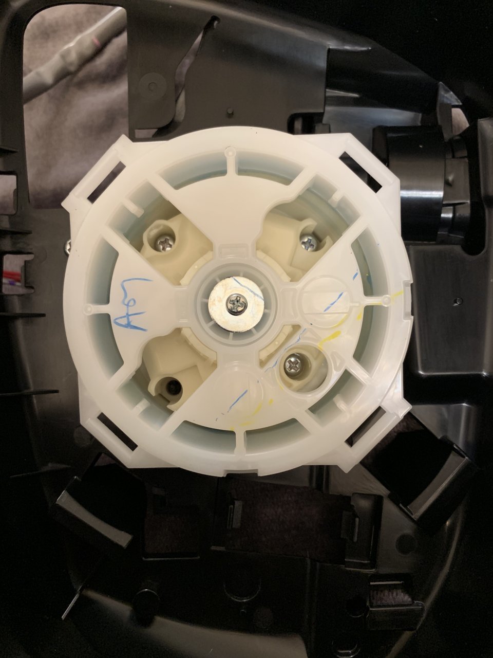

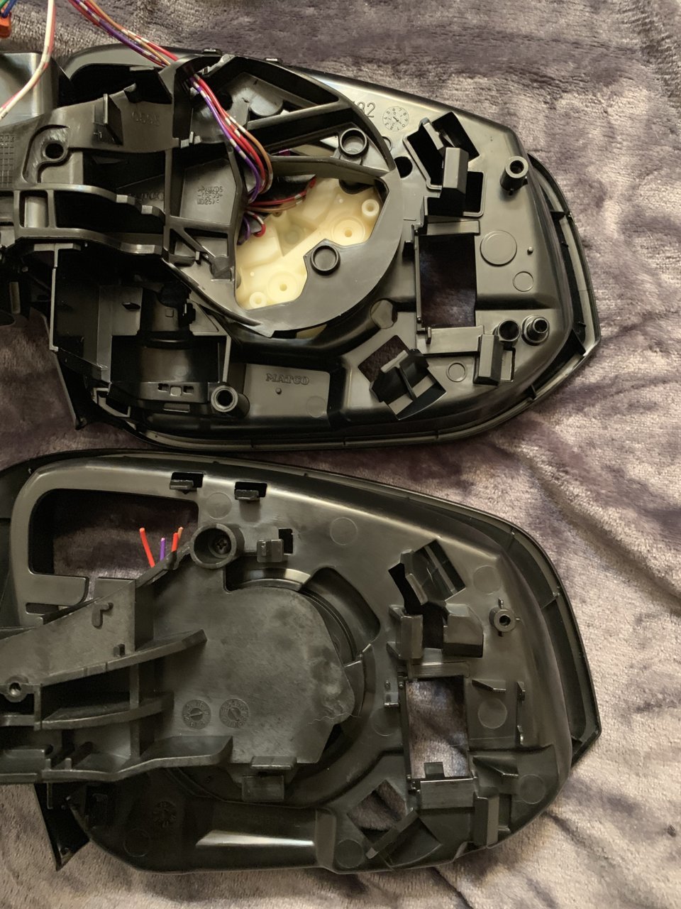

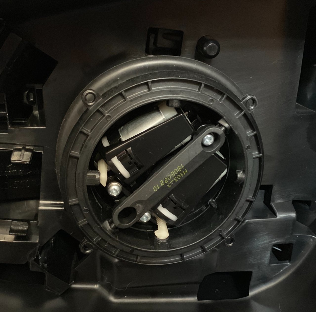

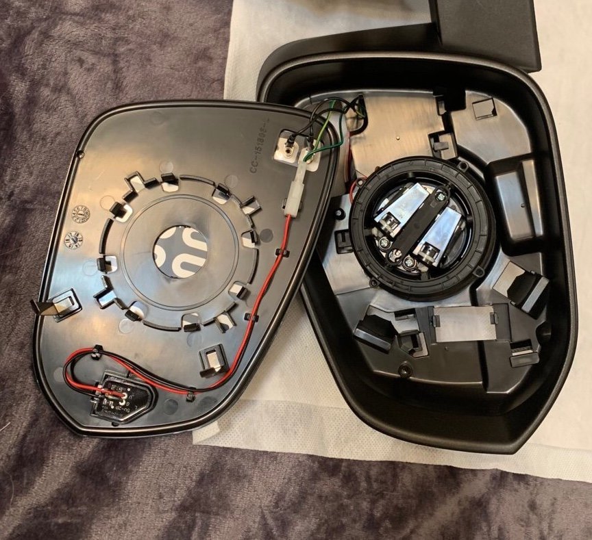

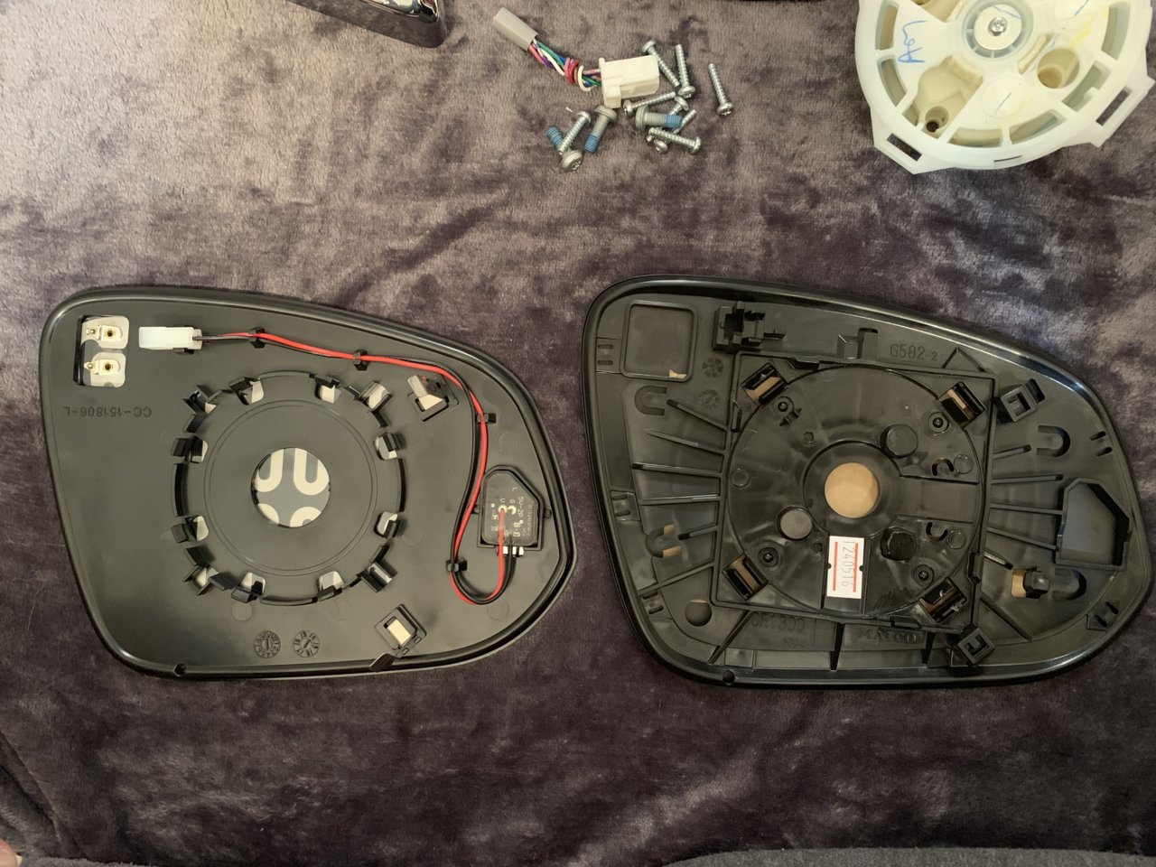

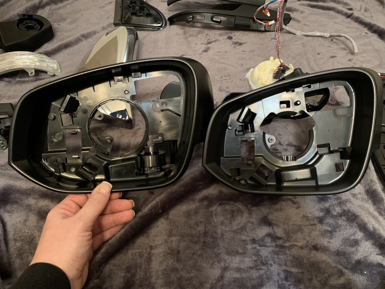

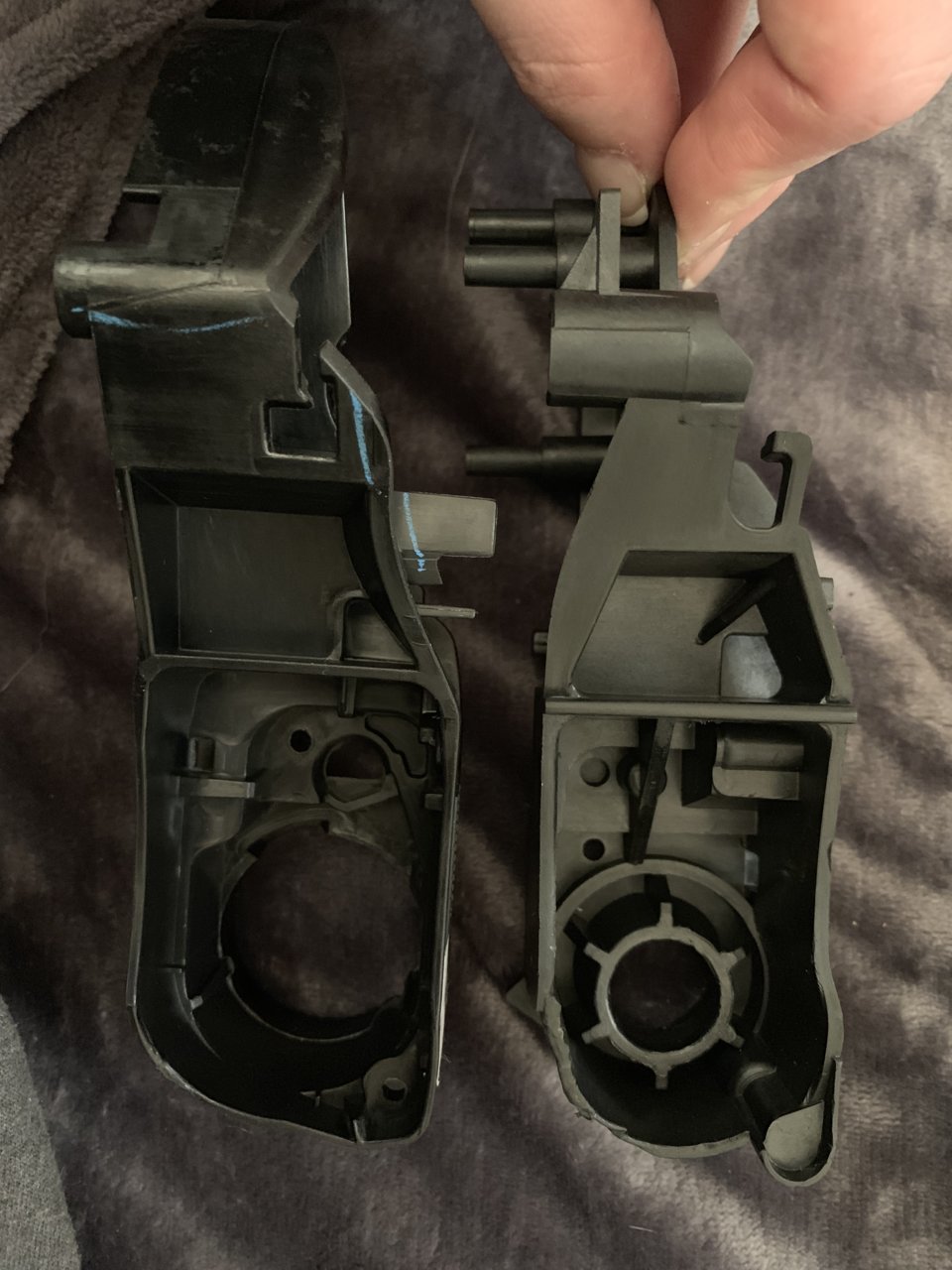

    The ONLY way I would be able to offer a DIY kit is if you had this Adjustable Actuator in your OEM Mirror
    However, if you have this one...
    It would not work because the mounting points on the Mirror Glass, the Mirror Housing, the Connection Plate, and the Powerfold Actuator location within the Connection Plate are all different. It would not be worth it. The cost of the DIY kit would be like double the cost of just purchasing the PNP Power Folding Mirrors from me.
    Here are some comparison pictures of what I’m talking about...
    Mirror Glass Side-by-Side Comparison
    Mirror Housing Side-by-Side Comparison
    Connection Plate Side-by-Side Comparison
    Powerfold Actuator location within the Connection Plate Side-by-Side Comparison
    Again, this is only two different mirrors I am showing. There are a lot of different OEM Mirrors in the 3rd Gen Tacoma’s that I never would have imagined. Before doing this project, I would have thought they all were the same. If you look at my pictures carefully that I have posted throughout this thread, you will notice at least three different mirrors. It’s definitely taken some time to try to find out what the easiest, cheapest, and most reasonable way would be to come up with a Kit for this mod that others would be interested in. There’s not a lot of people that want to spend $400 on a new set of mirrors that you are only going to use half the parts and then another $200-$300 possibly on a second new set of mirrors if you find out your OEM mirrors do not match the Powerfolding Mirror. The only other way is if you didn’t care to keep the OEM Mirror and Turn Signal, then you could just spend $400 on a Powerfolding set of Mirrors and just swap the OEM Hinge and be done. But, then again, your OEM Hinge needs to be the one that has the 3 holes in the bottom so it will screw into the Powerfolding Actuator.
    So...as you can see, there are a lot of different variables that come into play with this mod. I can offer it however people are interested in purchasing it though. I just wanted to give a little insight into some of the parts that are similar, but different.

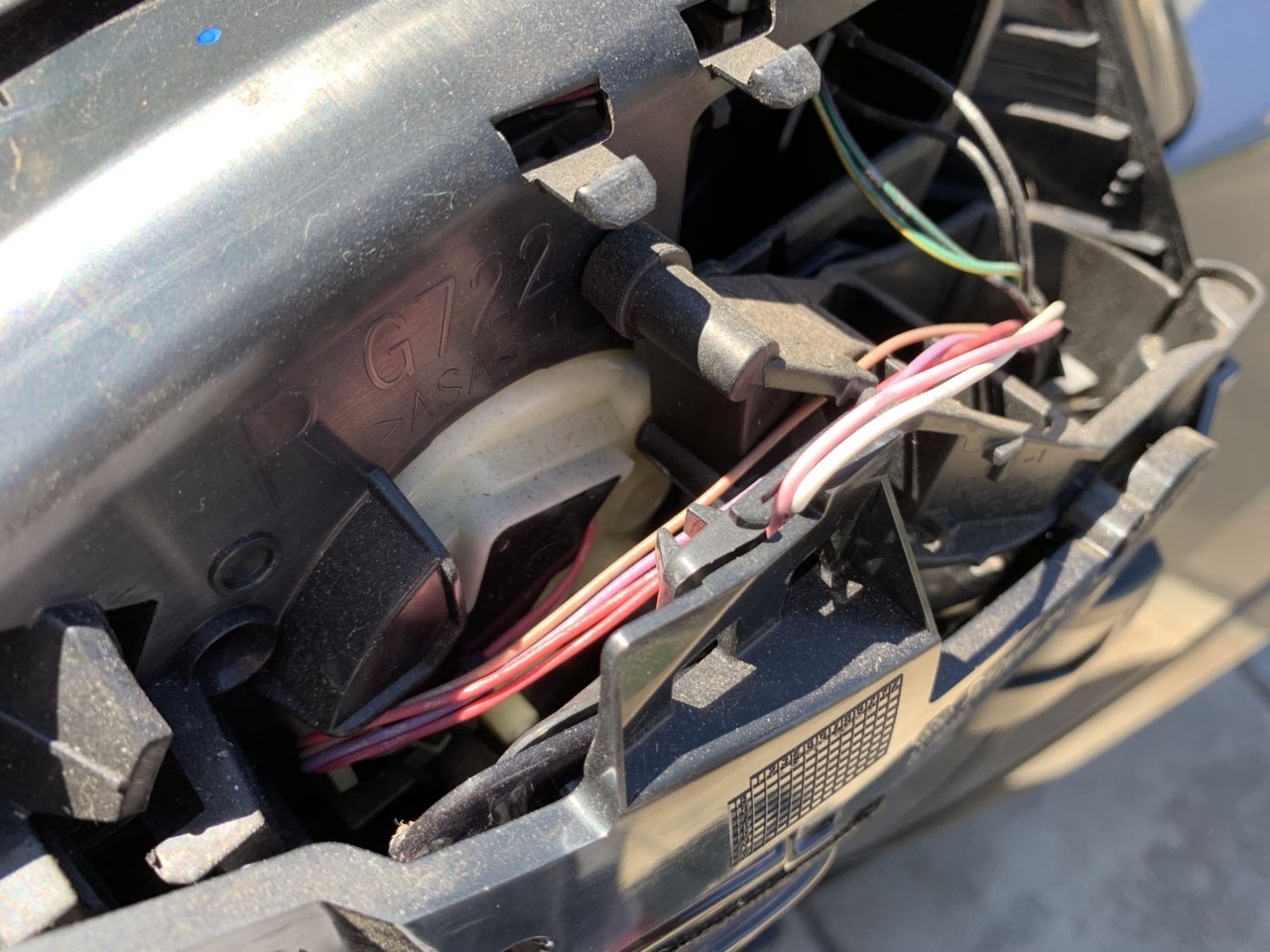

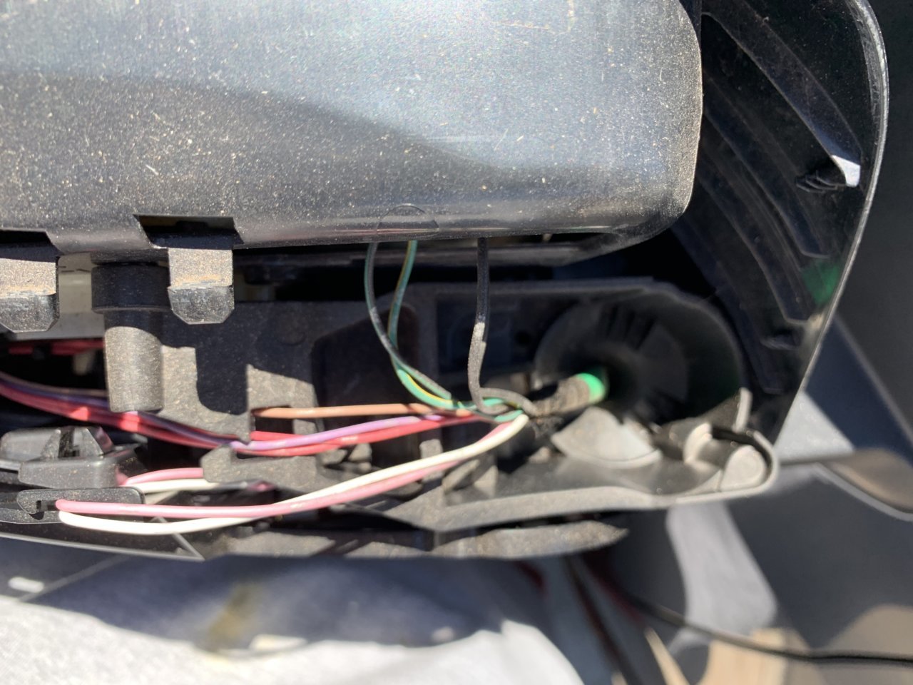

    I would like the DIY kit as well. I can remove the cover and see which one i have. Can you tell just by removing the painted or chrome cover? I have a sport with BSM.
    KTJO 4x4[OP] likes this.
  14. Feb 24, 2019 at 1:49 PM
    #94
    KTJO 4x4
    KTJO 4x4 [OP] Well-Known Member
    Oct 10, 2016
    #199424
    3,884
    Katie
    Oregon
    2017 TRD OFF-ROAD 4x4 DCSB BARCELONA RED
    Nitro 4.88 Gears OVTune 1.05 91Oct DirtyDeeds Exhaust
    Possibly. I know I will be able to see the Connection Plate which will help me. Sometimes you can also see the White or Black Actuator from the back too.

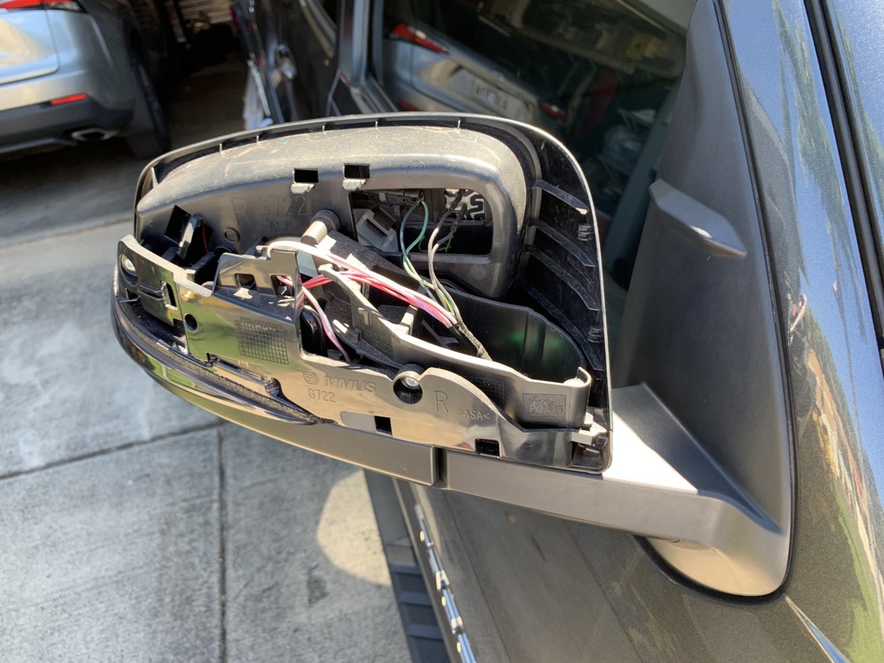

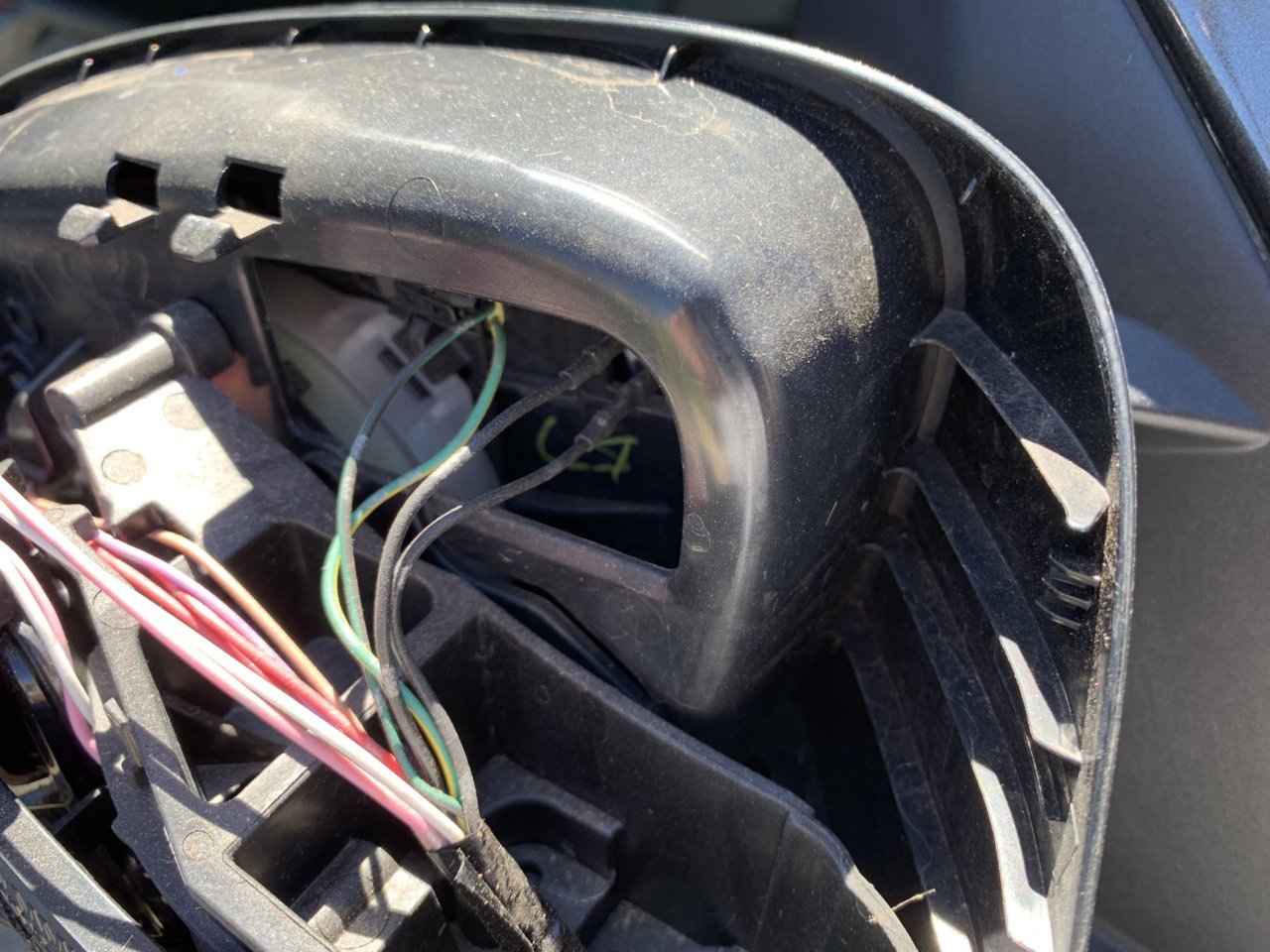

  15. Feb 24, 2019 at 2:55 PM
    #95
    TacoTruck808
    TacoTruck808 Well-Known Member
    May 15, 2017
    #219102
    2,103
    Oahu in the Aloha State!
    2016 Tacoma TRD Sport DCSB, Prem & Tech Pkg, MGM
    Heres some pics i took. Soes this help?761210D0-9596-478B-B8E9-4076677AE238.jpgDE098389-B359-4273-94CD-9FBF95EA17F7.jpg
  16. Feb 24, 2019 at 2:57 PM
    #96
    KTJO 4x4
    Oct 10, 2016
    #199424
    3,884
    Katie
    Oregon
    Yes for sure. Can you take one of the mirror a little further away so I can see the Connection Plate and one looking down where the power wires go into the Hinge? I’d like to see what yours looks like compared to the ones I have. Looks like your OEM have the White Actuator

  17. Feb 24, 2019 at 2:58 PM
    #97
    TacoTruck808
    May 15, 2017
    #219102
    2,103
    Hows this?
    71832900-8FF1-42FC-8C14-E94A2A6579F7.jpg EFD7E8C6-1A48-48CD-A846-623A67012903.jpg
  18. Feb 24, 2019 at 3:04 PM
    #98
    KTJO 4x4
    Oct 10, 2016
    #199424
    3,884
    Katie
    Oregon
    Perfect! Ok. Well I would definitely need to make sure that the Connection Plate is in the kit because your OEM Connection Plate will not work with the Powerfold Actuator. Which is exactly what I thought. So now it comes down to matching the one that does work with the one that is on your mirror. Luckily I have both options in my possession. So...if I am not able to order the Connection Plate from this company that I will hopefully be getting the Powerfold Motor, I will need to look into having a mold or 3D print made up of that piece. I already have a quote for that piece to be made. It’s not cheap but the good news is that it can be done :)
