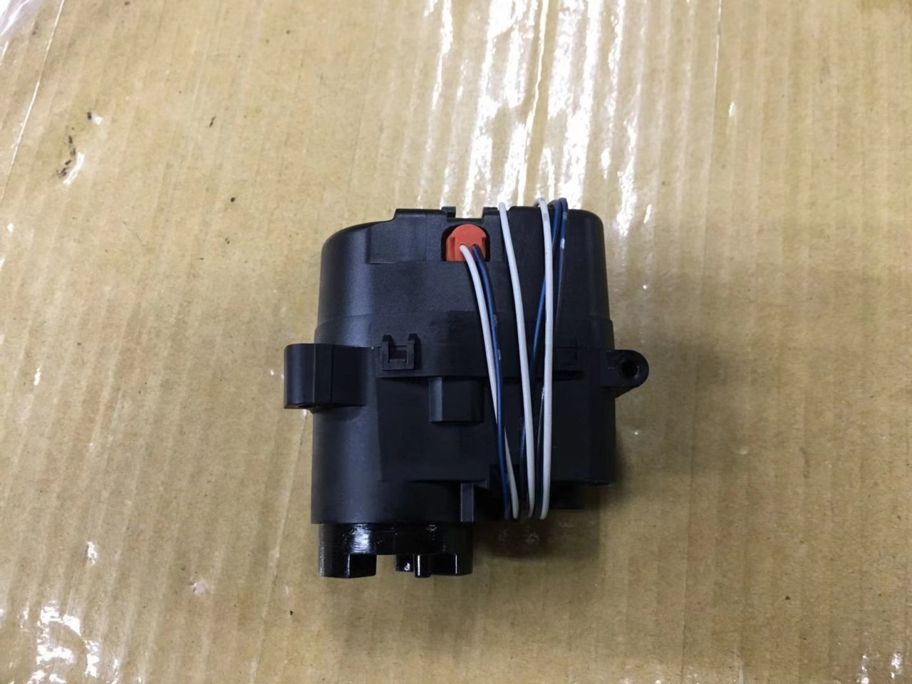

    In the process of talking with my vendor...they have located the Powerfold Actuator for me :D
    They are currently looking into the Replacement OEM Switch, the Control Box for the Folding Mirrors to be able to operate, and the Connection Plate. Hopefully they will be able to combine it all for me into the DIY Kit I would like to provide for TacomaWorld! :bananadance: Once they locate all the items I would like, they will give me a ballpark figure and a quantity size I will need to order at minimum. If they are not able to get me the other parts, I will just part those out individually.
    Still a work in progress, but it’s getting closer...

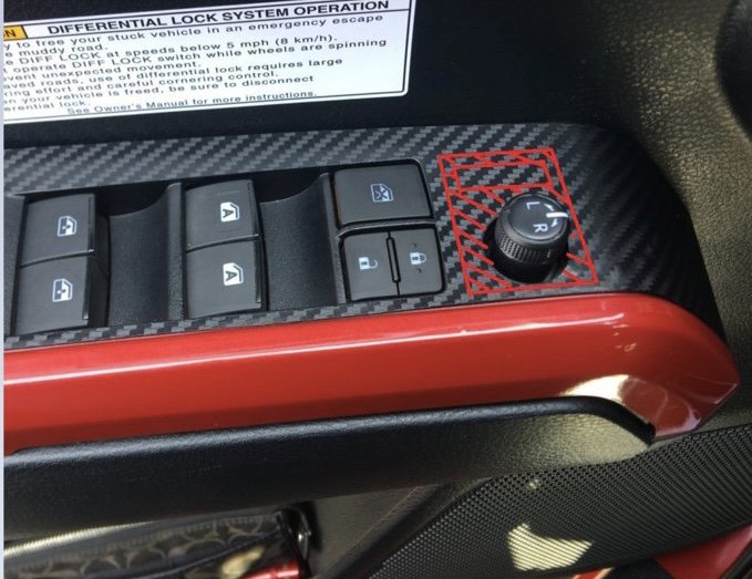

    If we were to get the OEM switch that fits in the factory location on the door switch, would we need to cut a hole for the additional mirror switch or will a new plate be part of the kit?

    No you would need to cut the opening. There isn’t a piece that I have found that would replace that piece for us. That’s why I was asking which switch would most people be interested in. The OEM Replacement Switch where you need to cut that rectangle out on our panel or the short stubby switch that matches our other switches

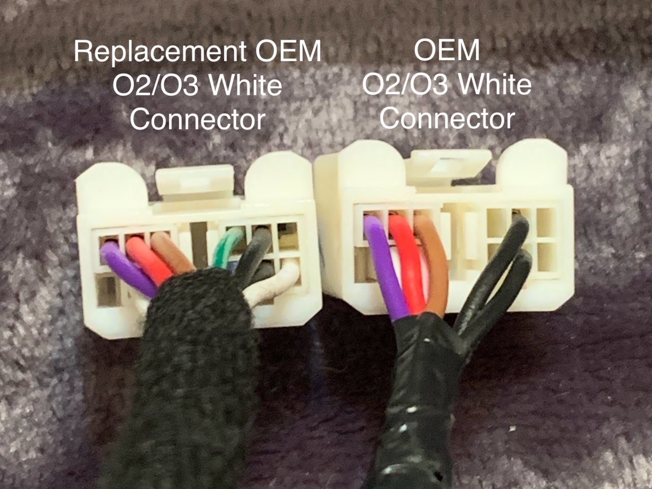

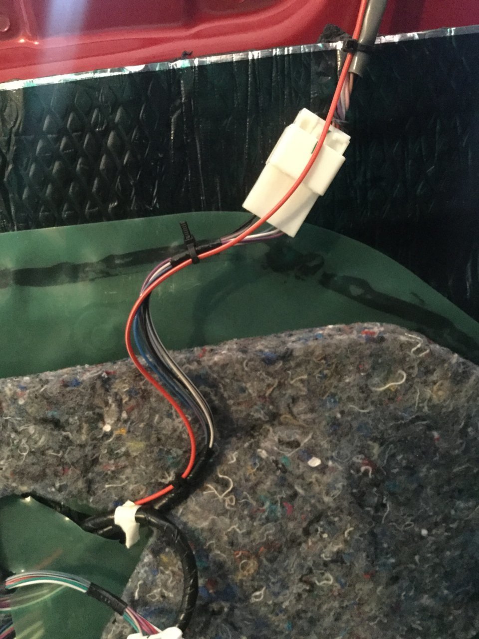

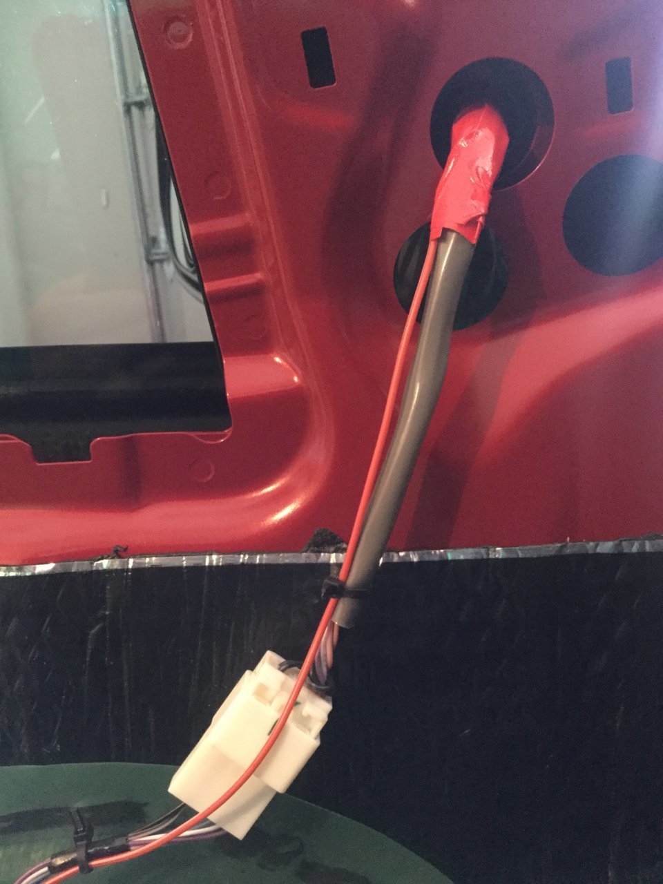

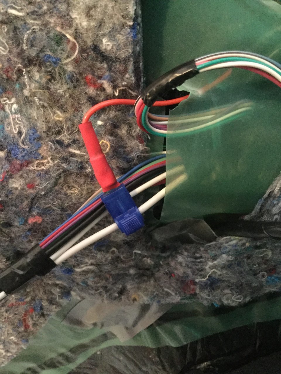

    I have Heated Mirrors, but I just don’t have the Blind Spot Monitor System in my OEM Mirrors. I was referring to the OEM Connector as far as being able to have all of my wires in the same wire harness and not have to run seperate wires or have like 5 different Connectors for all of my mods inside my mirror. This way if I ever want to remove my mirrors, I only will have to unplug the OEM Connector, my RGB Turn Signals, and Camera. People that have the BSM, all you would have to do is just run a wire right next to the harness. It just wouldn’t be inside the OEM harness. I actually have this on my current OEM Mirrors that are on my truck now. Since I don’t have my truck still, I haven’t been able to switch out my Switchback Turn Signals for my RGB Turn Signals yet.
    Extra Wire Ran Seperate:
    Sneak Peak at OEM Connector & Replacement OEM Connector with Powerfolding Actuator and Puddle Light Wired:
    Only thing I still have left to wire is my Ditch Lights which will go in the upper right-hand corner Pin #1. However, people that have BSM have a Green Wire in that location already. I will wire my Ditch Lights the same way that the Technology Package has their BSM/Heated Mirrors Wired. My Ditch Light + will go in Pin #1 and my Ditch Light - will be combined with my Heater - in Pin #8.
    As for the Replacement OEM Mirror, it is aftermarket but it is a Replacement for the OEM Mirror which means it is Plug-N-Play and has the same Connector. As for the Master Switch Panel that already has the opening for the Replacement OEM Switch, I have a message into someone about options for that piece ;) I might be able to have it included in my Kit.

    Here’s another pic of the modification that is needed for the OEM Replacement Switch
    I received news today that it is possible to have something made up for the Mirror Control, but making a whole new panel to replace this one will be complicated and costly. I can still look into it if there are people interested in having this as an option for the kit. Just know it might not be cheap to have made. However, if you look at my pic above, just like I mentioned before, you just need to make a small cut for the Fold Switch to come through the bottom like the Mirror Adjuster Switch. You can see by getting the LH side replacement OEM Switch that is offered, it will fit perfectly on our Mirror Control Panel.

    Have you tried cutting one yet? I would think you would need to have some awesome cutting skills to make it look perfect and oem. I like the look, i just think i may screw up the panel trying to cut it.
    Unless i have that $300 ultrasonic knife that @mesojdm has! Lol
