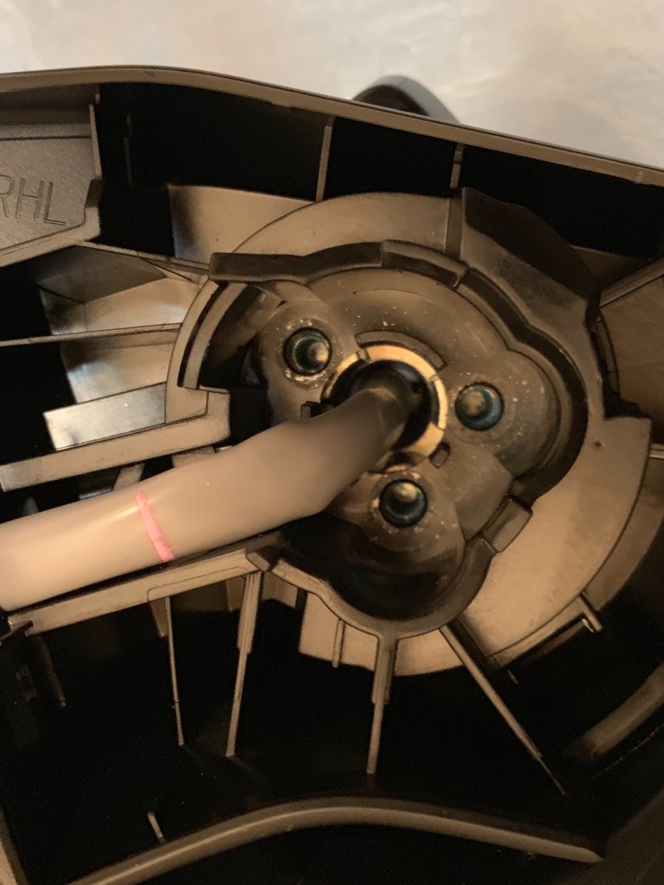

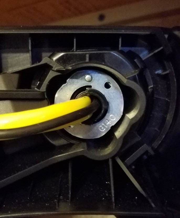

    Yes. No it will not be Plug-N-Play. It will be a DIY kit that will come with instructions unless you send me your mirrors and I install it for you. This kit will work for you and everyone else as you get to use your own OEM Mirrors if you’d like to do so. Basically, the process that is involved is taking your OEM Mirrors apart like I have shown to do and removing the stock Connection Plate by removing the hinge Spring and installing the new Connection Plate with the motor. You will need to have the bottom of your hinge look like the following photo for this to work as well.
    Once you remove the spring from your hinge, you will be left with this
    All you do at this point is install the New Connection Plate with the Motor and then use the 3 Screws to re-connect the Hinge. Then you will need to run the two new Motor wires however you choose. The motor wires will need to plug into the Replacement OEM Switch. That is all! Now for the Replacement OEM Switch, I’m hoping to have a new Panel to replace the one currently in our Door Panel. You will pop the Switch in its location, plug the new harness connector you get from me into the Switch, plug the OEM Connector into the new harness, plug the new Powerfold Controller into the New Harness, and finally connect all of the wires to their designated location that will need to tap into factory wiring in order to work properly. When I get my truck, I will have this be another one of the writeups on the first page of this thread to show you.

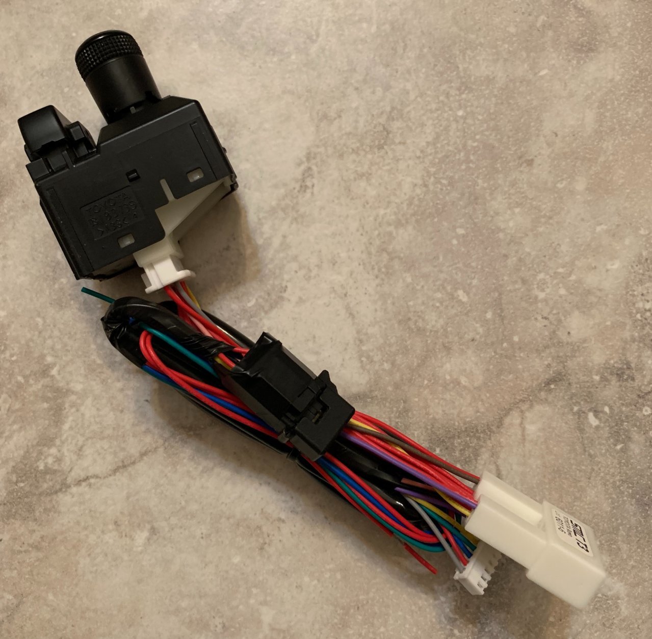

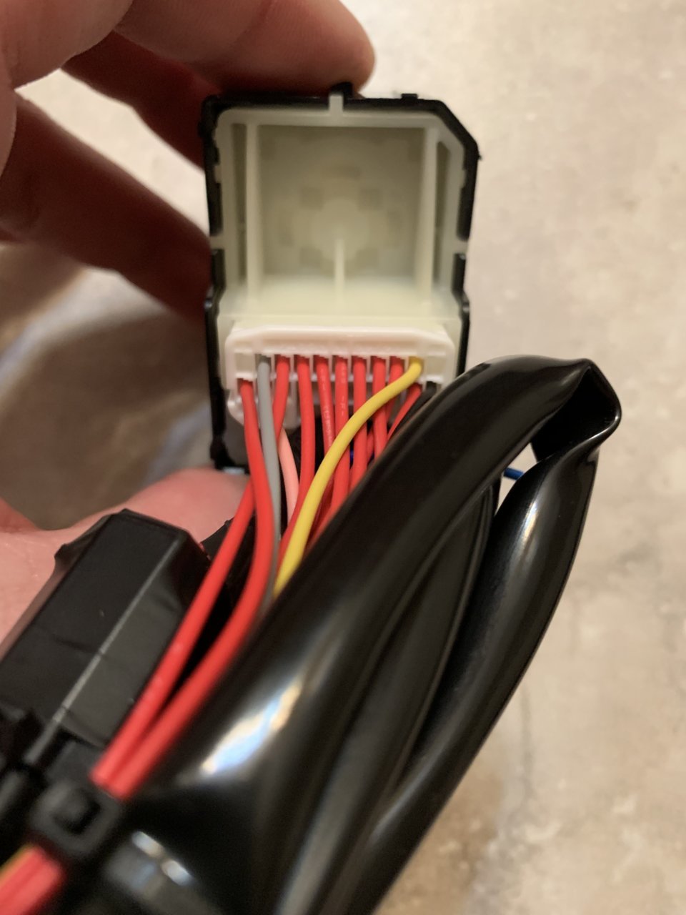

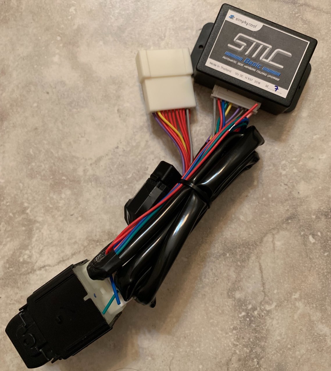

    Here are some pics of the Replacement OEM Switch with the Automatic Control Box & Wire Harness for the Powerfold Feature
    Here’s a pic of what may be another mod at the same time ;)

    Just checked out my mirrors. I have the white adjuster actuator and the same hinge spring! Hopefully those black ones are rare so everyone can take advantage of your mod.
