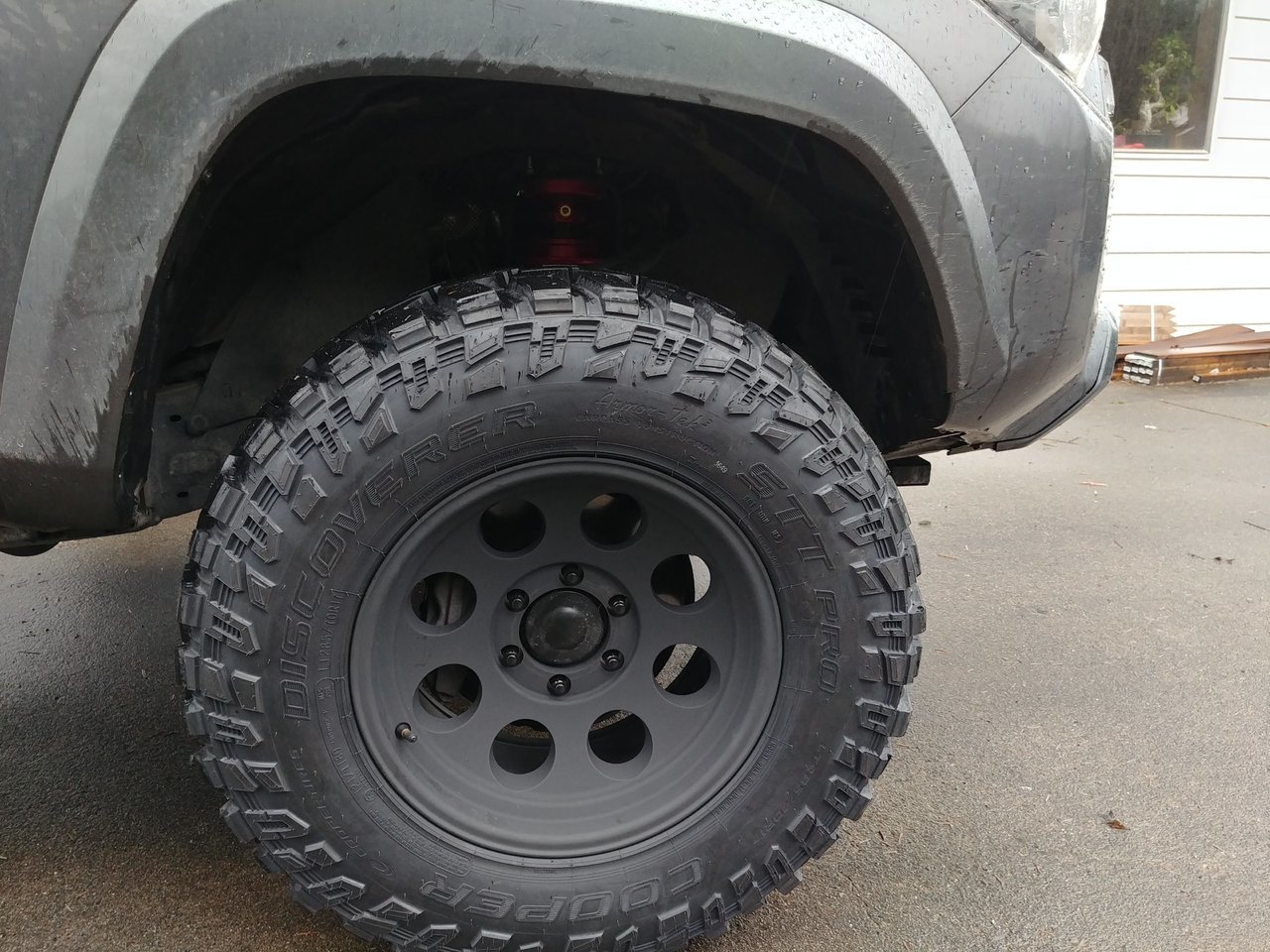

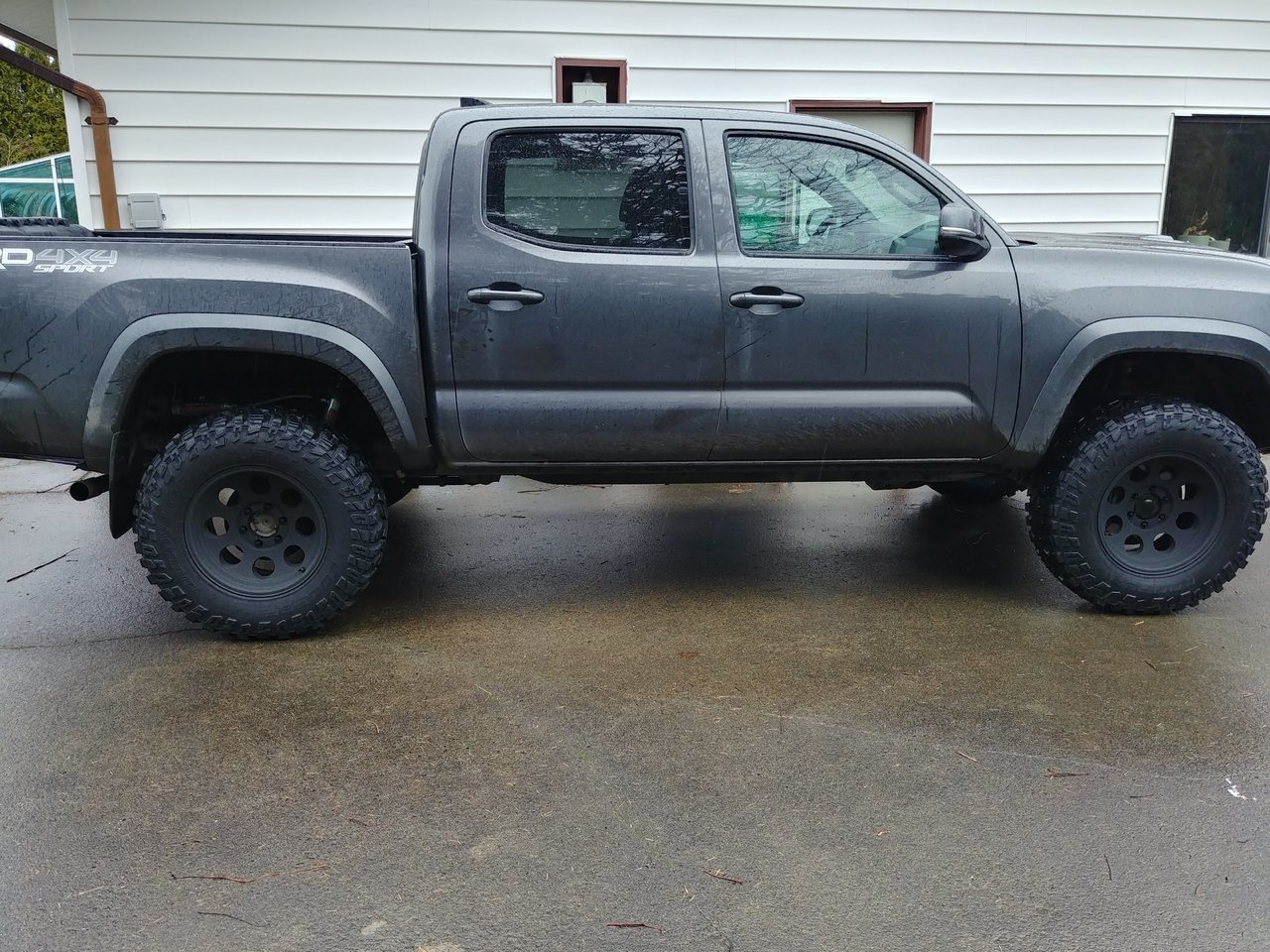

    17x9 4.5" Backspace snd -12 offset wrapped in 285/70/17 STT Pros

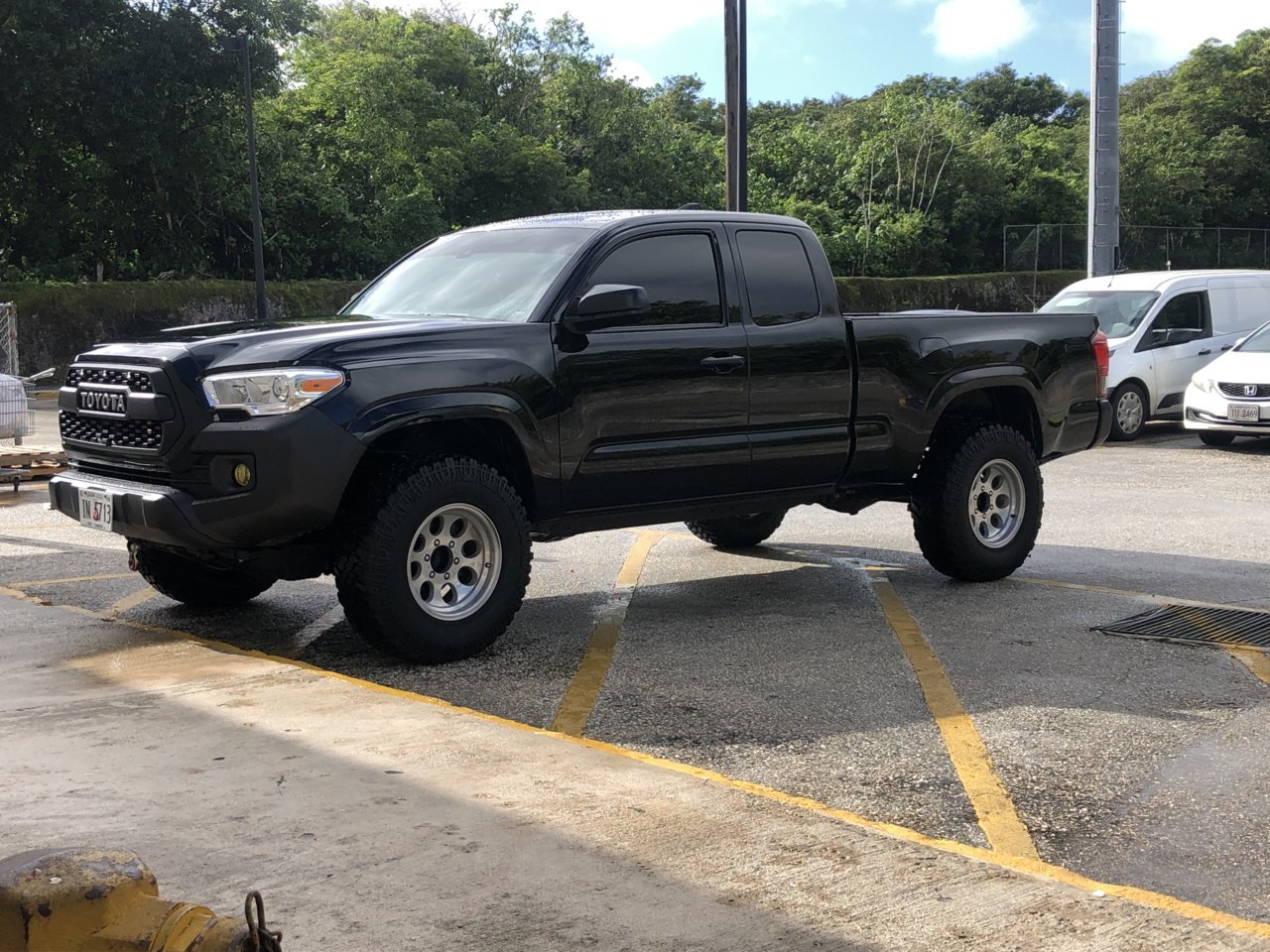

    2019 Black AccessCab

    The first time I installed them, they were rubbing on the calipers badly. Installed 1.25 spacers and everything ran great. I've put about 5,000 miles no problems.
