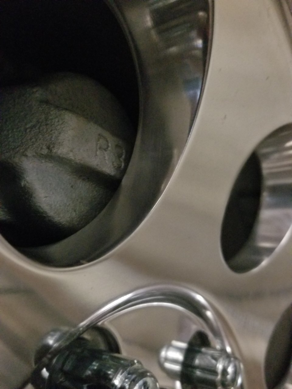

    I had these wheels on my 18 for a while. Close to the caliper, but did not touch. They were fine offroading also. Shameless plug... Need to sell mine with 6ply lt265/75r16 cooper at3 4s, about 7000miles on them. PM if interested! Mods delete my post if this isn't allowed!

    2018 OR MT

    wonder if it rubs when you put new brake pads on. that might explain the some people rub and others dont

    How would that be possible..? Our brake calipers are fixed. The pads slide on pins on the calipers. It's possible there are rub with the chromed version..?

    are these not floating calipers. ill admit i havent touched my brakes yet
    just trying to figure out the rub vs not. maybe black ones have a thicker coating
  11. Nov 17, 2019 at 7:00 PM
    #31
    basshole
    basshole Well-Known Member
    Sep 4, 2018
    #265149
    604
    chicagoland
    2018 OR MT
    They are not. They are the classic Toyota truck 4 pot caliper with pins that hold the pads in place.

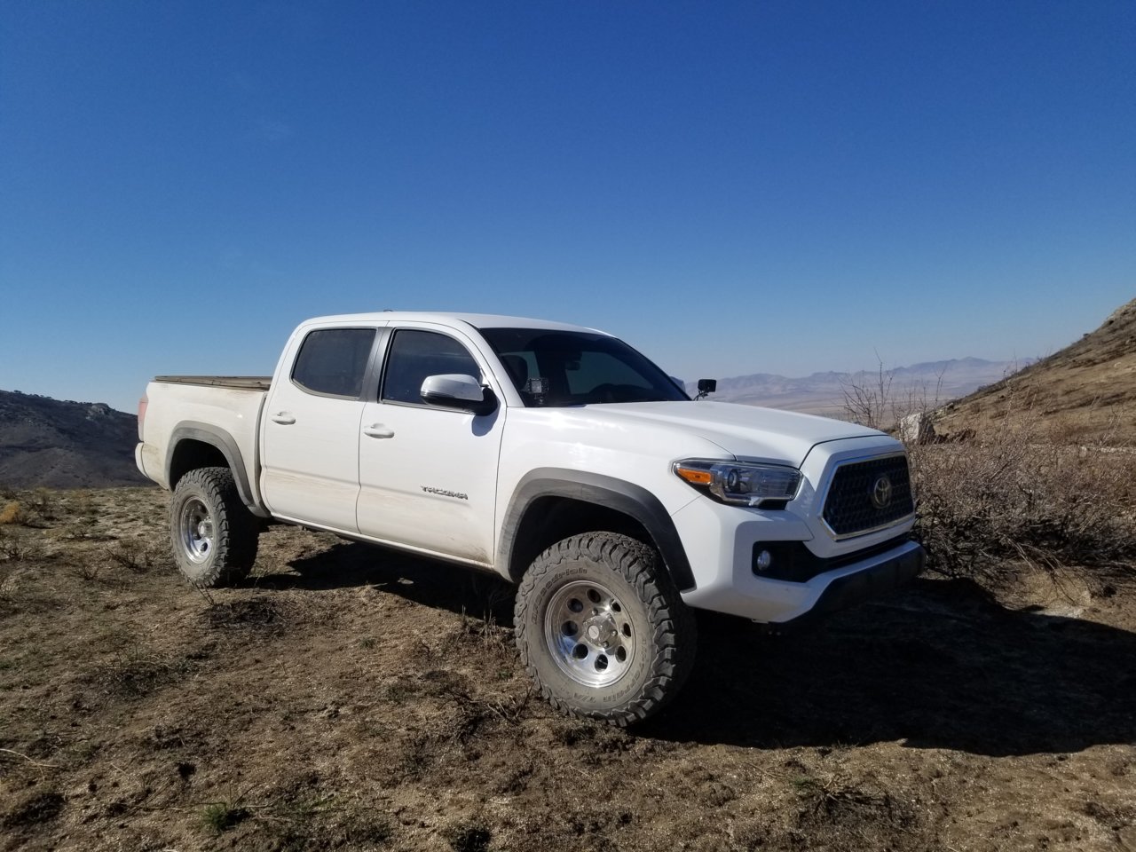

    Here's the polished 16x8

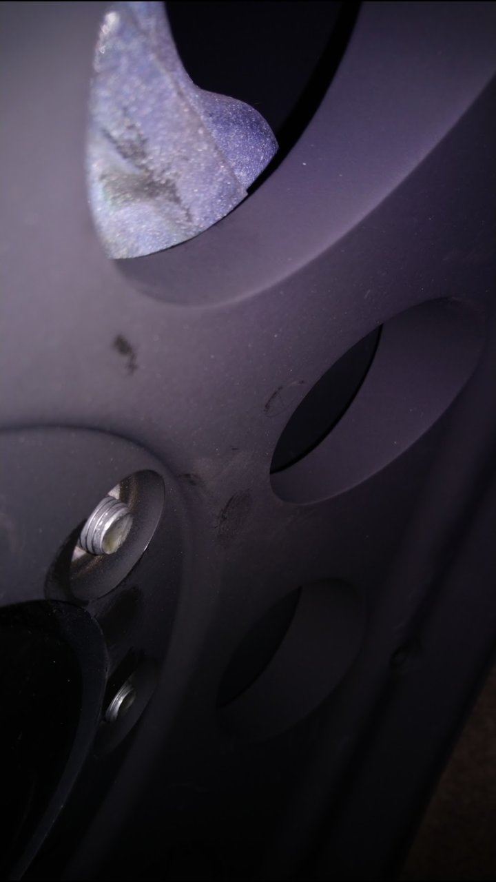

    Hey All,
    I'm getting these put on right now. No caliper rubbing on my 2019, but they are very very close.
    The lug nuts I have (the same I was using for my spacers) only catch about 4 threads on the studs. They are a generic acorn with tapered seat.
    Did anyone have new studs pressed in or run into this issue?
    **EDIT
    So the hole in the wheel is 0.629" ID.
    I ordered these which should give me a better bite. According to the specs, they are 0.60 OD, should be nice and snug.
    https://www.amazon.com/24pc-Chrome-...K0JP5NFNC3EQS&qid=1577815753&sprefix=,aps,224
