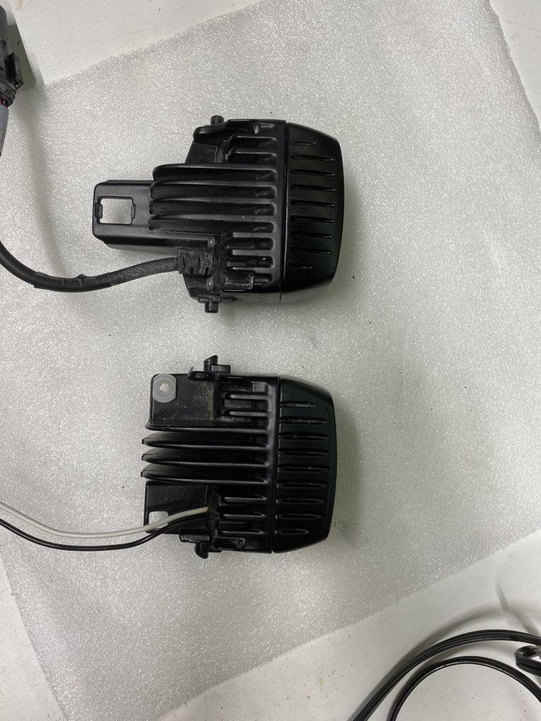

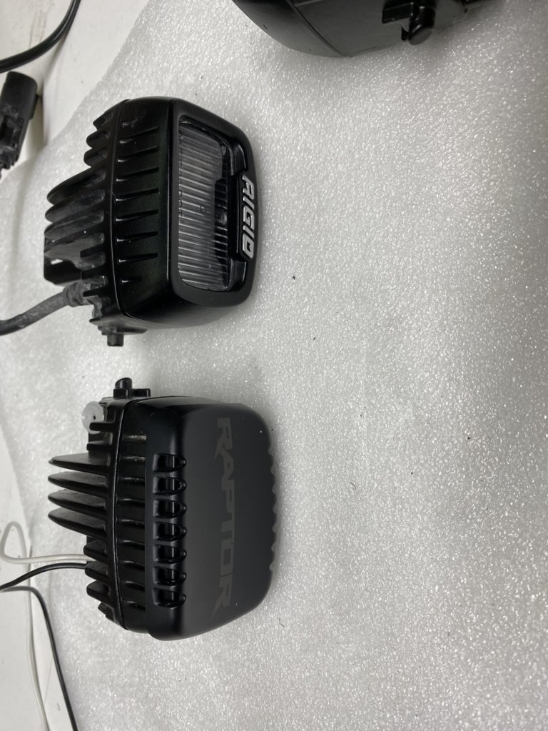

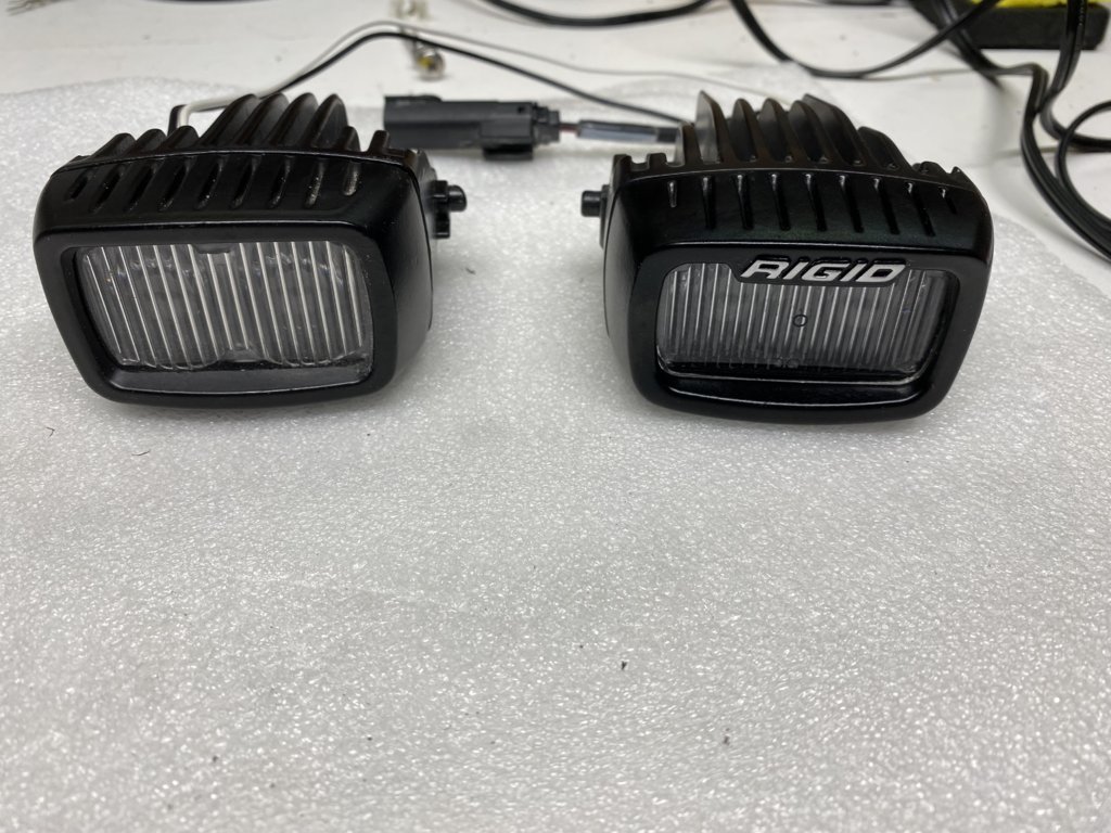

    About 7 months ago I purchased the Amazon/Ebay TRD Pro knockoff fog lights with bezels for around $100. $500 for the real deal just seemed like too much for what they are. The knockoffs Bezels fit ok, brackets work perfect, lights look good, though the light output for driving leaves a lot be desired.
    Searching for the real deal rigid light replacements, came to realize I was going to be paying waay too much for something plug and play, even used. Stumbled across the 2021-2024 ford f150 raptor fog light - familiar with this setup? Instead of two Rigid fog lights, there are four. The fog light look almost identical to the trd pro fog. Kept on eye on eBay and picked up a used left side fog setup with two lights for $130 to compare. The fog lights are almost identical, with the only real difference being the light adjustment. Even the raptor light cover snaps on the same for both. Thinking I’ll modify my brackets to accommodate for the raptor fogs - any interest out there in seeing a write up for this?
    IMG_8739.jpg IMG_8743.jpg IMG_8746.jpg IMG_8745.jpg If it works, it would cut the price in half for the real deal Rigids with knock off brand bezels and brackets

    Not sure how this was lost in translation..it’s like a game of telephone that you can see the history though
    I purchased knock off (not rigid, China brand) fog lights on Amazon. The light output it terrible, more of a parking light. I purchased the used raptor fog lights because they are actually rigid and it was $130 for two. I intended for this thread to be a DIY for those that want The TRD pro lights at 1/2 the cost.
    To answer the question, are the raptor Rigid fog lights better than the TRD pro Rigid fog light? Highly doubtful. I think they are an identical light! Would not go through this trouble for the same light output if you have ACTUAL Rigid fogs.
    if you have China knock off fogs, yes, youuuge difference

    No expectation of better light output - the Rigid Raptor fog I fully expect is the same light output as the TRD pro fog.
    Things are Tiny.. for the size they are impressive
