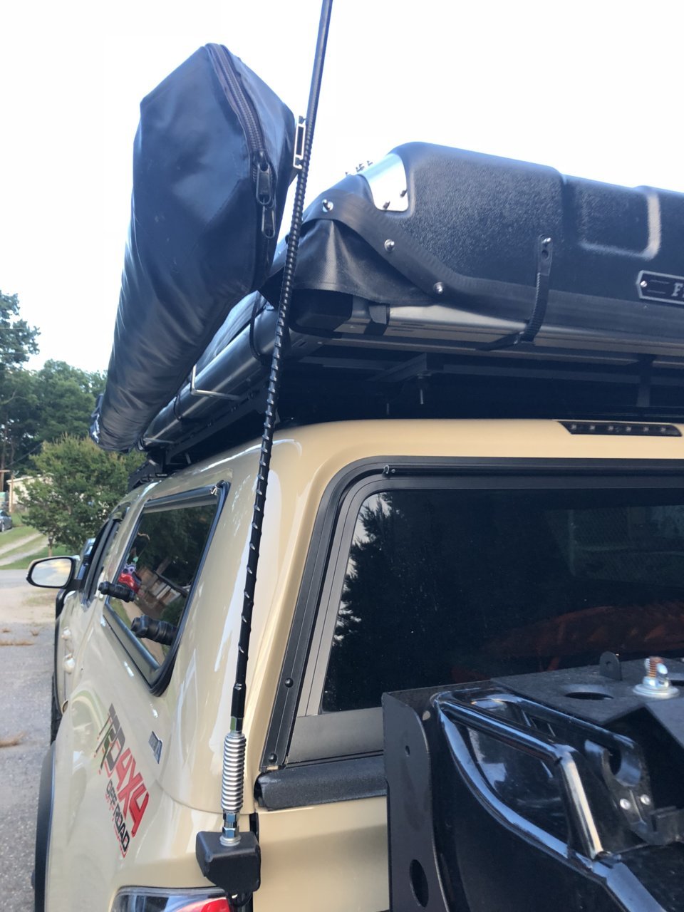

    I used two heavy duty L brackets from Lowe’s and bolted them to the prinsu cross bars. Pretty simple and cheap. You can paint the L brackets black to blend in better

    No I put the L bracket on the crossbar and butted it against the side rails of the prinsu. I’ll try to get you a picture tomorrow but the brackets don’t come past the side rails of the prinsu

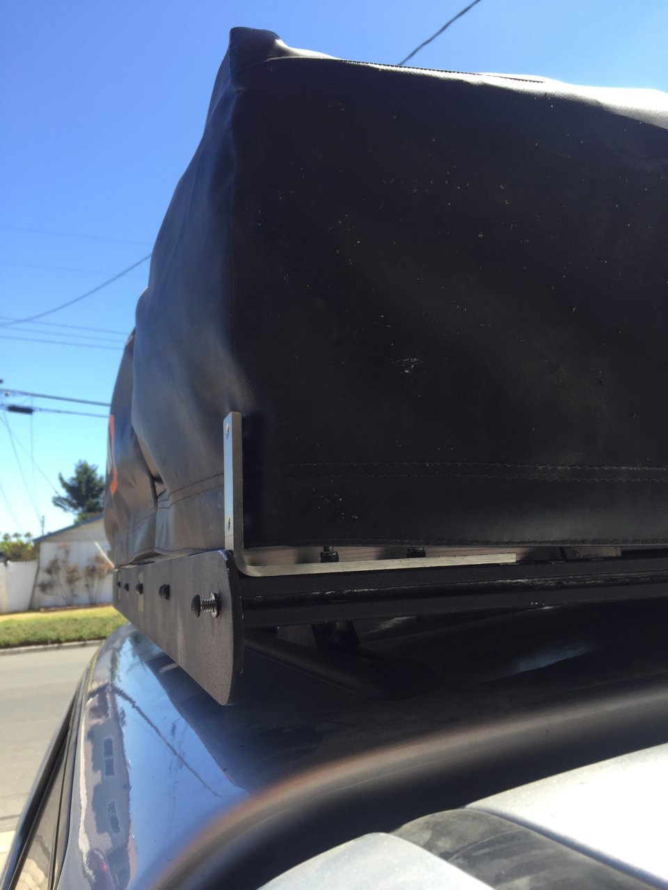

    Like this right? Im having a hard time with it because I cant shift the tent over any more so the awning is going to be right up against the tent. I think I gotta find a different way to moung it but cant find any other examples.

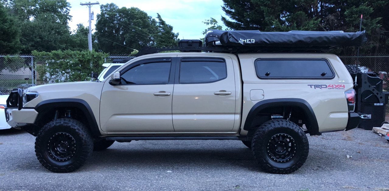

    Sorry I was mistaken. I had it flush like that when I had my tepui RTT and Arb awning. With my new tent I did have to bring the L brackets out further past the side rail of the prinsu because the tent has a lot larger footprint on top of the truck! You should be fine if you run some spacers to level it and bring it out further. You crossbars seem to sit a lot lower than mine. I didn’t use any spacers on mine but it probably could’ve used a few

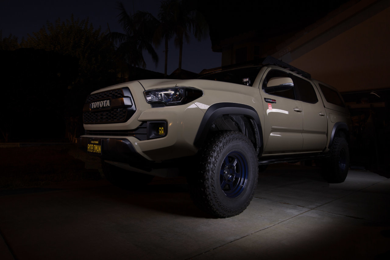

    Even at night quicksand looks good :thumbsup:

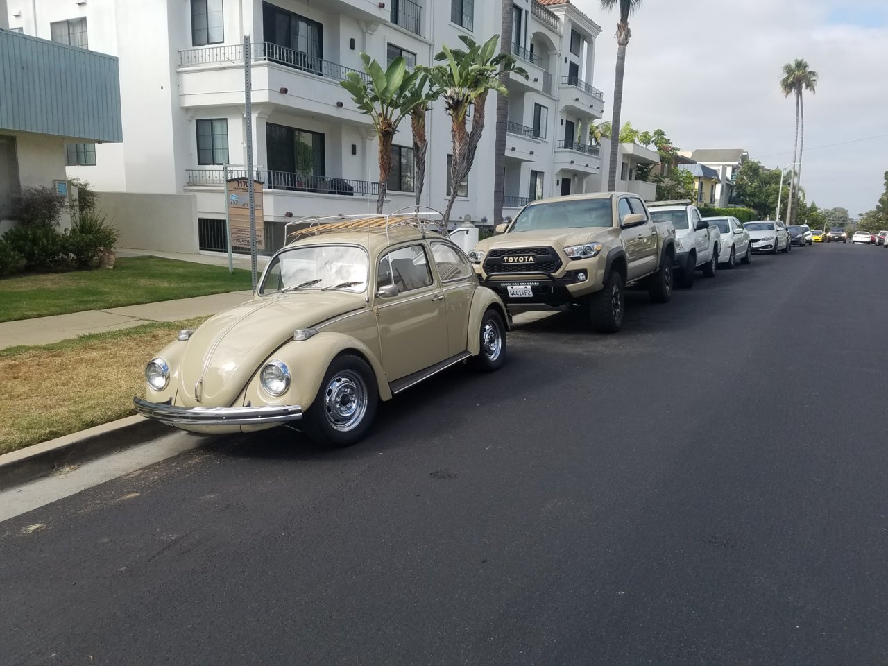

    A little contribution to the QS thread. Parked truck yesterday, came back an hour later, and this was there. Made me chuckle.

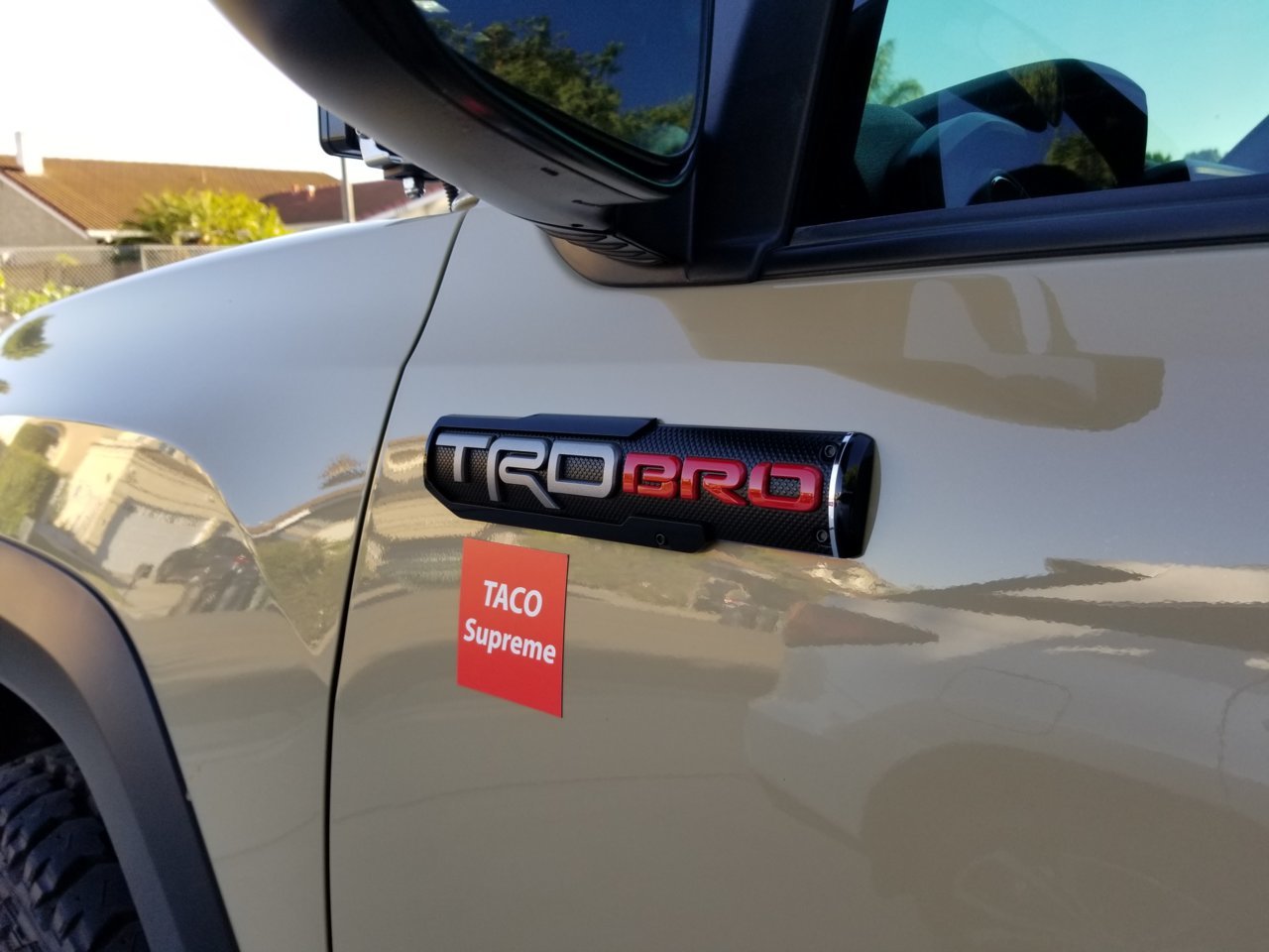

    TRD Pro badges :bowdown:

    Indeed
    Actually TRD Bro :thumbsup:
