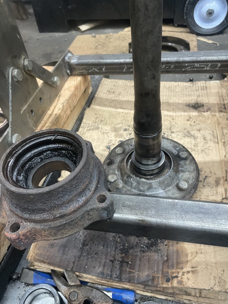

    My rear wheel bearing and axle seal are bad on my 19' Tacoma TRD Sport long story short i can't press the axel out of the hub and the only rear Axle hub assseblies i can find are the dorman 926-140 and 926-139 these say they are for gen 2 Taco's does anyone know of the compatibility of these parts on Gen 3?

    Everything I can find shows the full hub/axle assemblies as fitting Tacomas from as early as 2007 thru 2022. The Dorman p/n you found appears to have the correct brake back plate, which seems to be the main variant - not things like OAL, spline counts or bolt patterns.
    The hubs are pressable however, it just takes the special tool set and every bit of a 20 ton press.

    The rear bearings have been the same on at least all 6 lug Tacomas since 2005.
    42450-04010 - RH
    42460-04010 - LH
    42423-60050 - retainer (x2 - 1 per side)
    You need a bearing puller that works on the Toyota bearings, and a 20T press to use it. And a press to install the new. It’s a pain of a job, but doable. For the tool to work, you can’t use a recent Harbor freight press. The welded together press shelf is too narrow to fit the tool flange. I literally sold my HF press and bought a 20T from Northern Tool that bolts together, all because of this one factor.

    It should be noted that anything with the 3rd gen 8.75 diff (all MTs & all OR/Pro) has 32-spline axle shafts as opposed to 30-spline on everything else. Dorman might make something for that, I’m not sure, but definitely worth knowing. The axle shafts for all 6-lug Tacomas from 2005+ are all interchangeable.

    On several Tacoma/Tundra/4runners I have done this job. Some people cut the race off to make removal easier. I have installed the bearing and race with the pipe method and that honestly works just fine.
