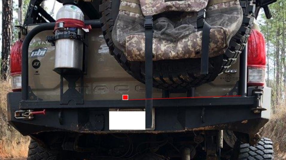

    Also, what are you doing for a rear camera? It looks like the spare blocks the view of the factory backup camera.

    SOS Offroad Concepts standard rear with swing out.

    Use the side mirrors. There once was a point in time where vehicles did not have back up cameras.

    I relocated my camera to where I put the red box. ran wires along red line and spliced / extended the existing camera wires. used the pelfrey relocate mounting bracket. Thx @Trident904 for pic, too lazy to go take a pic of mine :D

    I still have decent visual from the stock location. If I was running 33's I would be able to see better.
