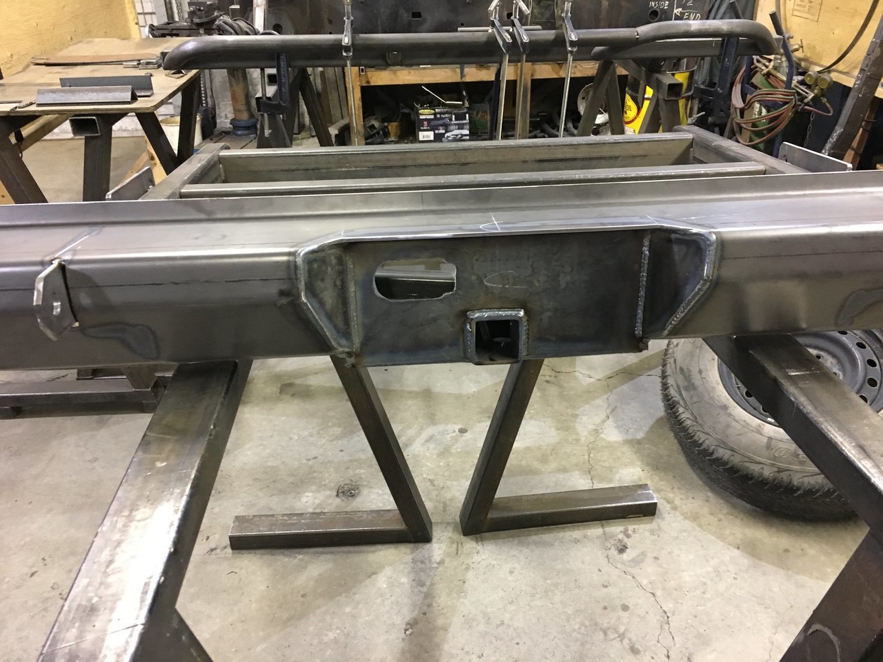

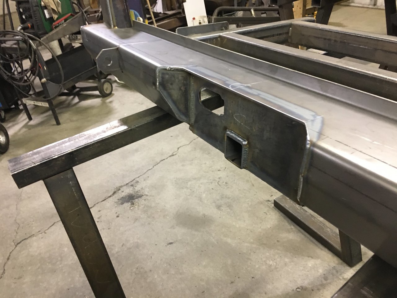

    Pictures of what my bumper will look like, still in the works, well actually it is complete, I just haven't seen pictures of the completed, but I know it will be awesome, this was prior to him grinding down the welds and beef'ing up the recovery hooks. Just waiting on my damn rigid ignite lights to come in now and a response from a company about the darn camera relocate.

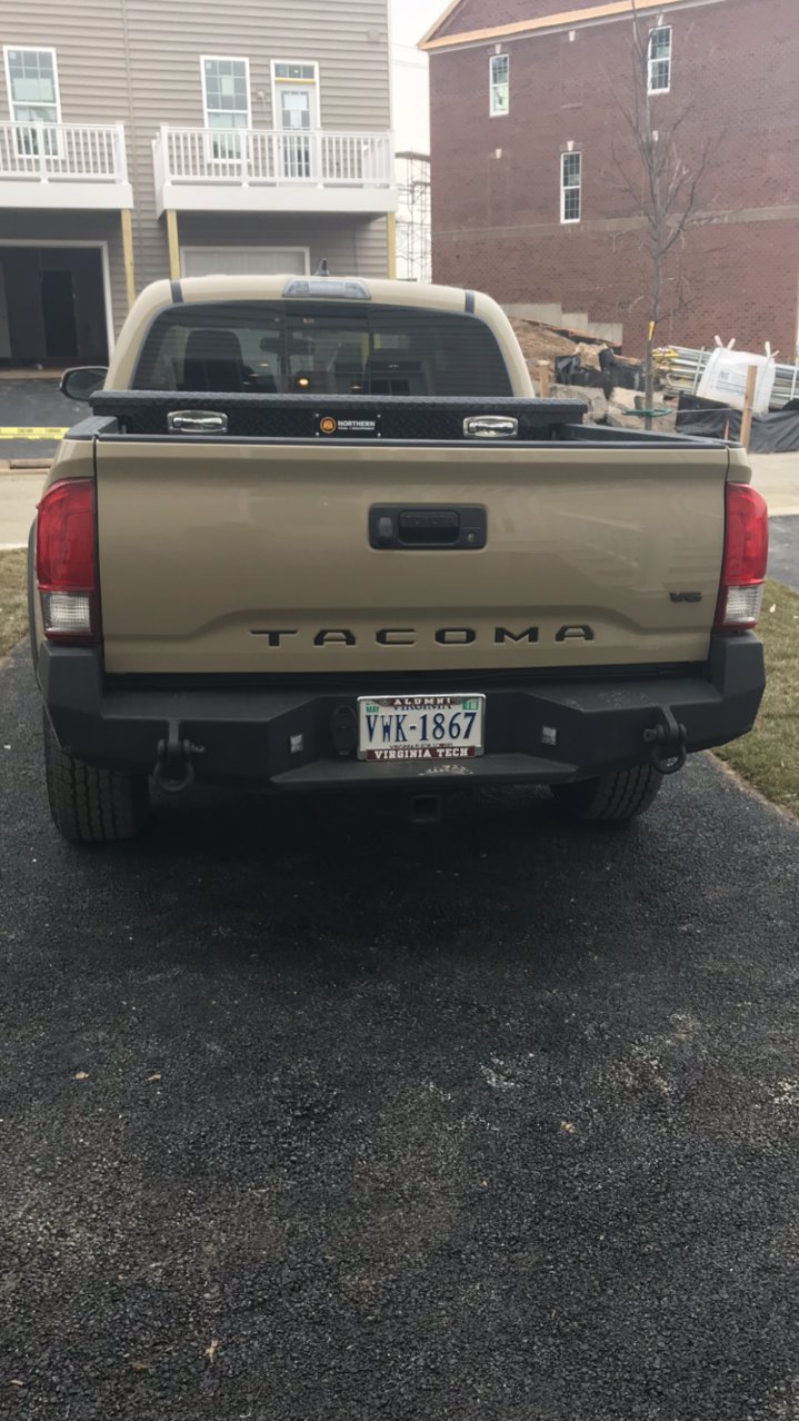

    I put the Fab Fours premium model on my 17 TRD OR a few days ago and love it so far. Fit and finish is excellent and the welds look amazing. It was $799 powdercoated and shipped, plus there are several vendors who stock it on Amazon so no production lead time. If you don’t want a swing out or high-clearance bumper, this one is worth your consideration.

    That is sexxxxxy! I love the clean, simple look. Classic :thumbsup: (referring the above Fab 4 bumper on Cleetus's truck)

    Looks great! I had the body shop install mine yesterday, went to pick up the truck today and found they didn't reinstall my receiver hitch. I guess I get to pull that beast off and do it right. Did you have to mess with your trailer plug wiring?

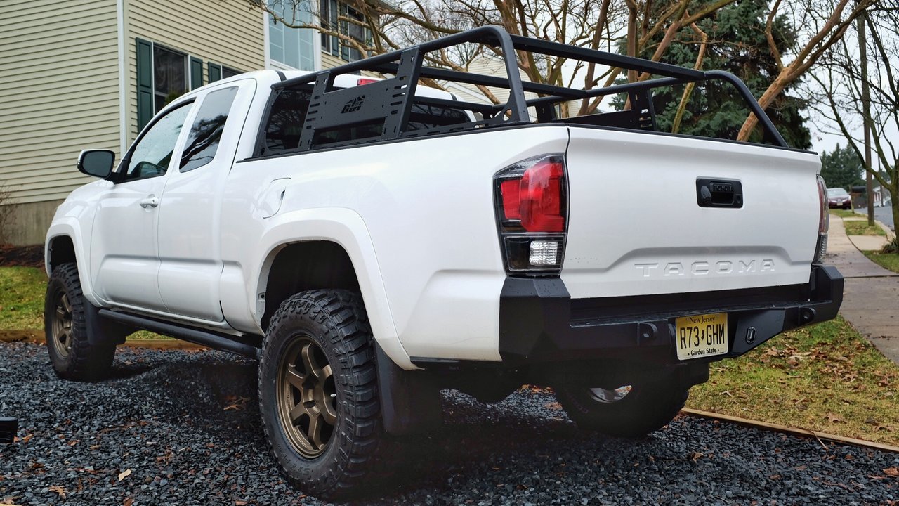

    simple rear bumper. wish someone made this for taco.

    Looks great, I also went with fab fours and love it. Did you have any issues with the trailer wiring being too short for the new bumper location? What part of VA you in?

    That’s weird installing mine I didn’t even need to remove the tow hitch. The new bumper mounts just use the oem mount location for the hitch. 3 bolts on each side.
    I did have issues with the wiring not reaching new location for trailer hookup. Had to unsecure wiring from frame about 5ft from rear to get enough slack. Then just zip tied back to frame where I could.

    Ya, they removed the stock bumper with the hitch attached, then bolted on the new bumper and couldn't figure out why the hitch wouldn't fit... :crazy:
