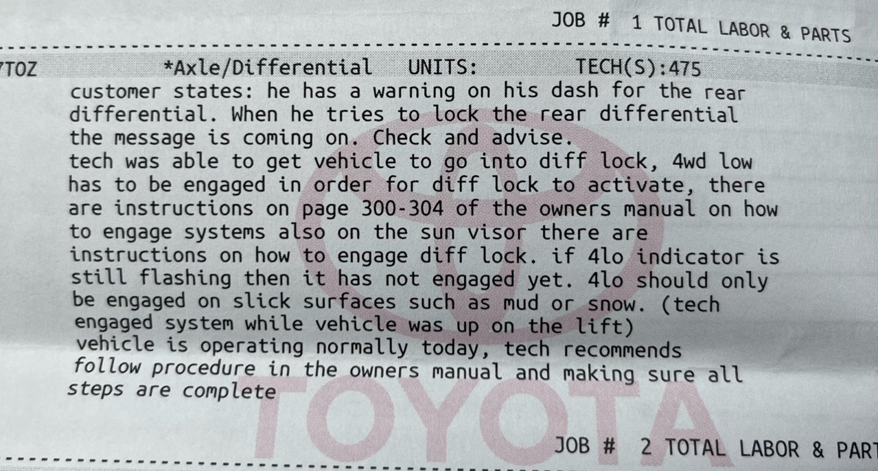

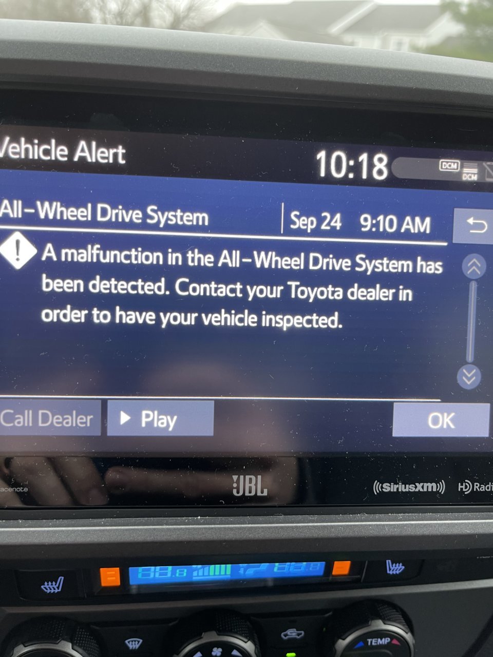

    I’ve tried the stealership who lectured me in writing on putting the truck in 4Lo and waiting for that to engage before using the locker. I hate to say it this way but I can read. I’m following exactly what the manual says to do. I even got the truck to generate a warning (pictured) on one of my locking attempts, before taking it in. Didn’t seem to phase the dealership.

    So did the dealership confirm they got the locker to engage? If so I'd make them show me and see exactly what they did.

    That’s what they claim. I could go back there I guess and make them show me what they did to lock it. Seems like they put it up in the air to make it happen which to me isn’t a realistic test.

    Done all that but I could try moving it again. The warning above was actually generated when I was pulling forward slowly while turning the steering wheel. I think it’s an actuator problem but seems it’ll take a bit of convincing at the dealership for them to repair.

    When did you get that error? Getting a 4WD error is pretty easy to do. Did you get it after shifting into 4LO? Or were you fully in 4LO and engaging lockers?
