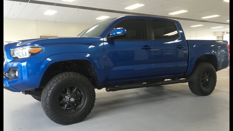

    Just bought it today I did LED lights ordered lift and deciding on tires using the stock rims
    So I had my 3" Front Leveling Kit and Tried to in stall a 2"rear and it caused my rear pinion to bind up. I removed then to drive home but it now sits two inches lower in the rear.
    Front is 39.5"
    Rear is 37.3"
    Has anyone had this issue and if so what's the fix.

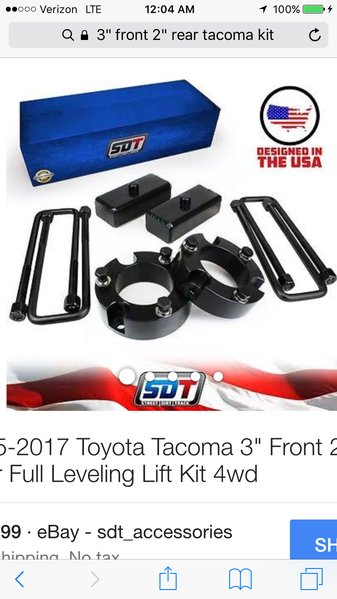

  16. Mar 23, 2017 at 9:06 PM
    #16
    ToddsTRD
    ToddsTRD [OP] Active Member
    Mar 4, 2017
    #212328
    30
    2017 TRD Off Road Silver
    This is the kit
  17. Mar 23, 2017 at 9:07 PM
    #17
    Matic
    Matic The "OFG" Baby!!!
    Sep 8, 2009
    #22436
    26,677
    Tricky Dick
    Easley, SC
    1 owner 2002 TRD, SR5, DC, 2.7. Full OME suspension, STT pro's.
    OME 881 coils with OME nitrochargers shocks up front. TC UCA's OME Dakars with extra leaf in the rear. Warn 8000 winch with 80ft custom braided synth line. Custom 60ft synth extension. All pro tube bumper, Hi-lift jack, Safari Snorkel, Wilco tiregate. 2019 Jeep JLUR.
    Not cool bruh.
    Pportera and smitty99 like this.

  20. Mar 23, 2017 at 9:09 PM
    #20
    ToddsTRD
    Mar 4, 2017
    #212328
    30
    Used the same kit on my 2016 no issues
    SilverII, Leo4x2 and 20tacoma17 like this.
