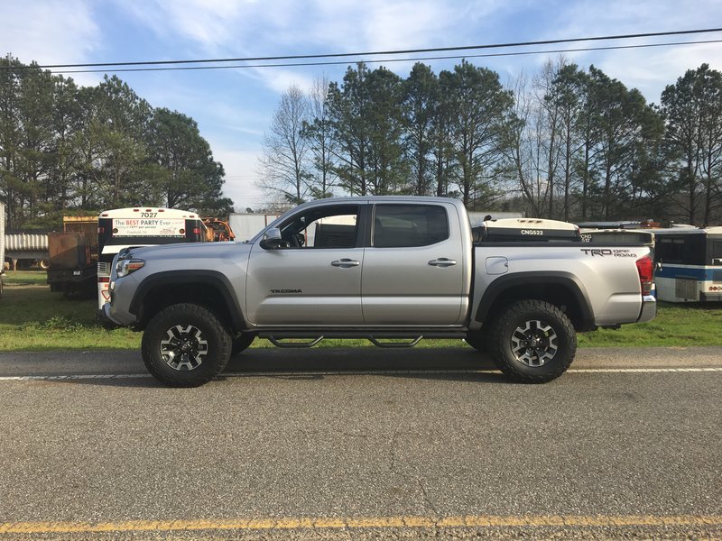

    Just bought it today I did LED lights ordered lift and deciding on tires using the stock rims
    This was earlier after I took the rear off. It's got the CA stance

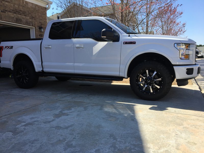

    I installed this kit on my 16 Taco My 16 F150 never an issue

    Are those NFab steps ?

    No it was not same truck just had the shifting issue and sold it.
    No the bars are off ebay called CXT. They are awesome. they bolt right up no issues took 10min to do both sides $198.0
