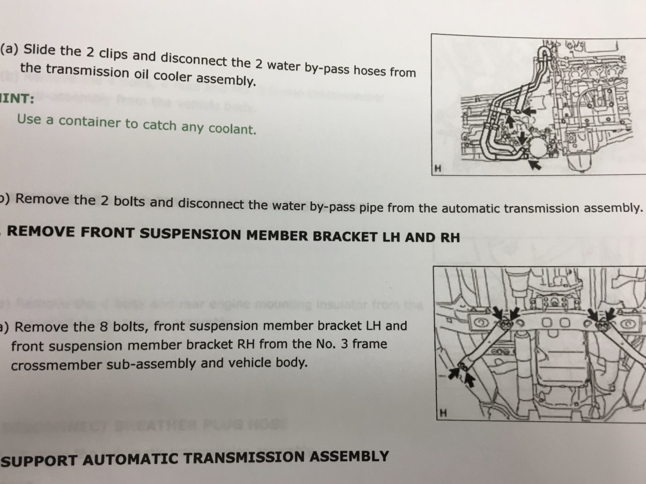

    FSM says remove coolant bypass hoses to the transmission oil cooler assembly.

    That’ll do absolutely nothing if it is indeed the rear main leaking
