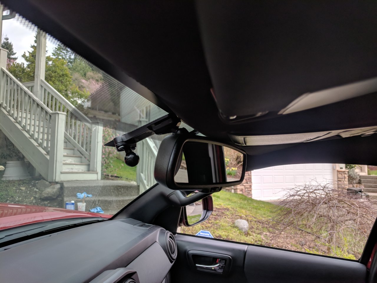

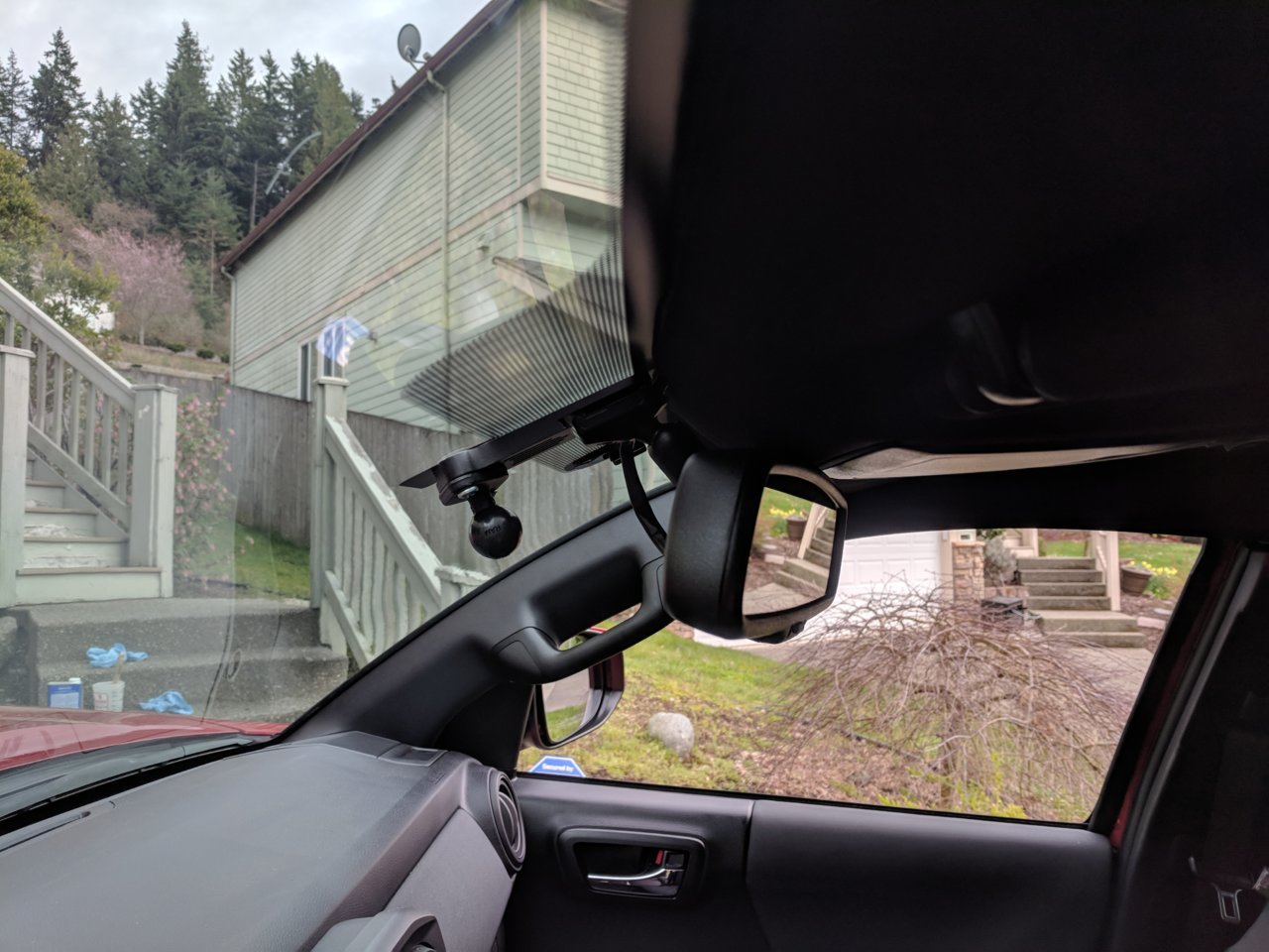

    Fits just fine. I have it pushed up against the headliner like the photos from @cemented posted above. You can adjust it to where ever you want it.

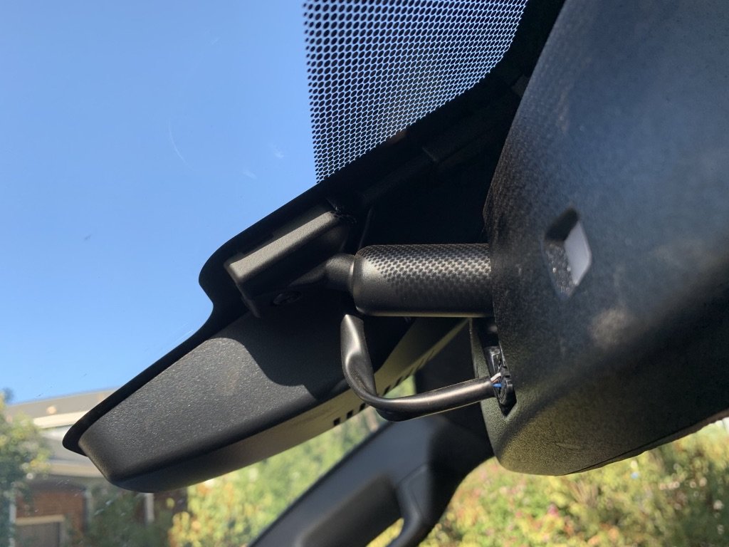

    Well tickle me pink. I didn't even know about the OEM double joint. I moved it up as high as it would go and its already much better. If I need the extra inch I would consider the Bird Dawg riser/spacer. Good lookin out @tonered !!

    Looks like it doesn't work with the OEM powered mirror in the 3rd gens? :annoyed:

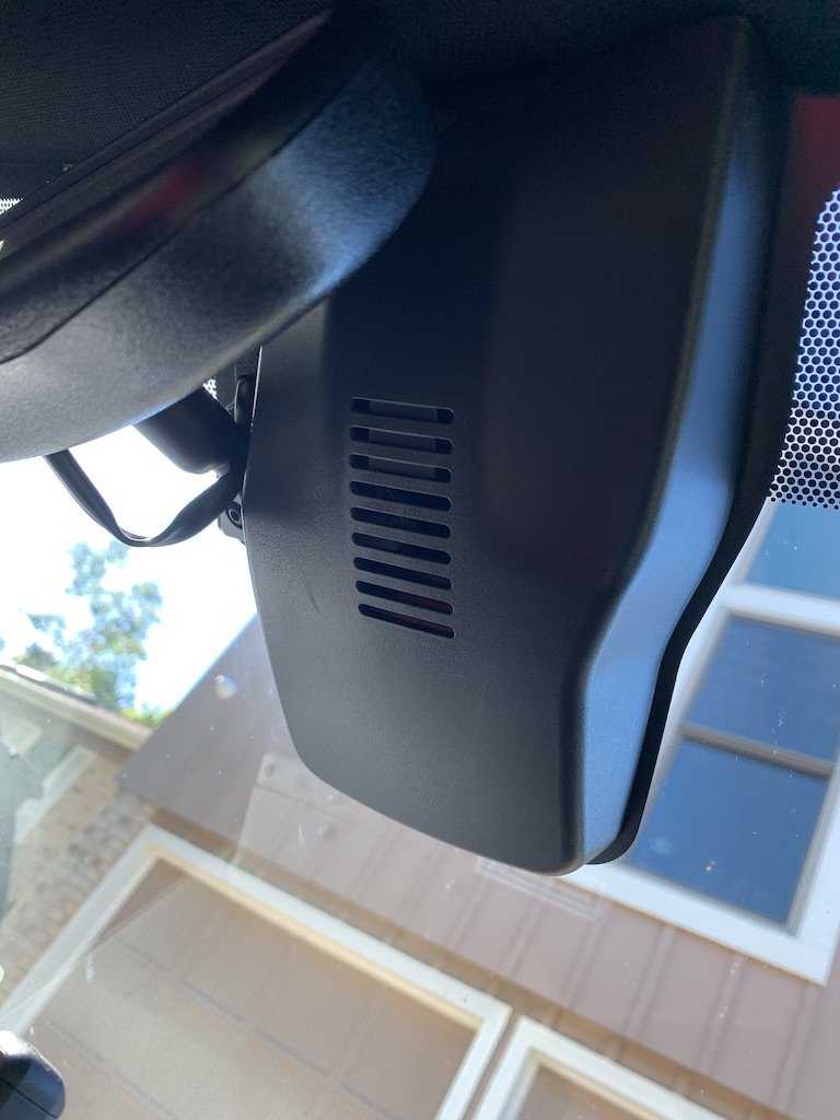

    There is the safety sensor up there that would interfere with the width of the bird dawg plate, it looks like...

    That looks about the same as the 2018s / 2019s. You can see my pics at the top of this page and the straight on pics from @cemented on the last page to get an idea. Folks with TSS-P have fitted it by chopping off the right RAM ball mount lobe.
    I don't know what more I can tell you. If it were me, I'd be all over modding it to work. Or, finding a mirror than can actually pivot out of the way.
    I suppose that I might as well say it. A person or two have reported cracking their windshield when reefing on the mount. Realize that there is now a moment arm there when adjusting the mirror. Be sure not to crank in torque through the plate. Mine has been good for over two years now and the mirror gets moved from time to time.
