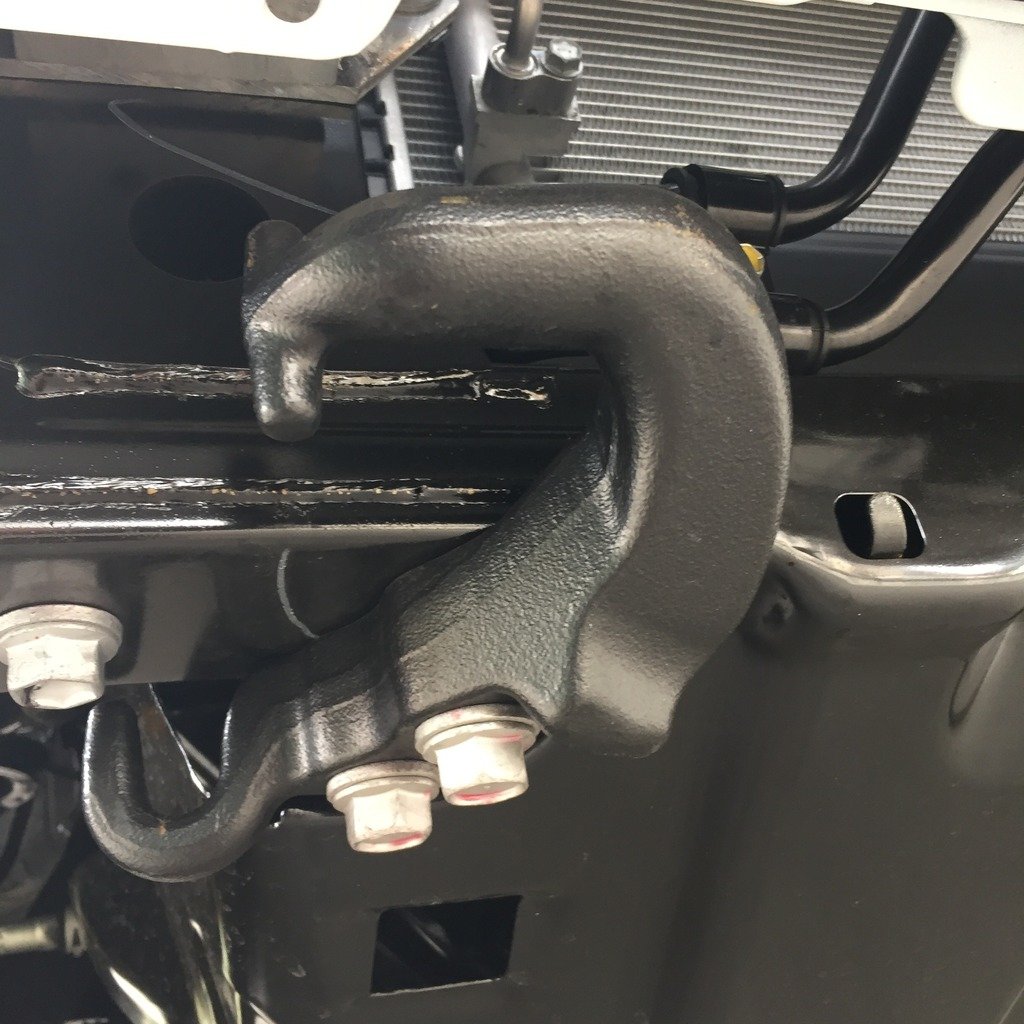

    Lots of great info on here, thanks everyone. I'm hoping the crawl control / electronics of the Tacoma will save me in most situations, but I still want to be prepared just in case or if I run into someone who needs help.
    I'm gonna pick up a maxtrax at some point..
    I was curious about the front hitch point on my DCLBOR, so I went out to snap these pics.. the passenger side is something I've never seen before, but looks heavy duty.
    Thoughts?
    Passenger side:
    836C694B-7D05-4A50-BE24-99B7C5701DB4_zps_5bb41d39256cf7419edf126e8b4a489d4e6f0dae.jpg

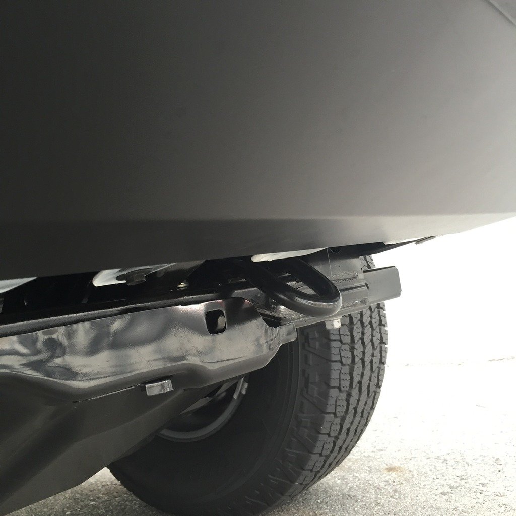

    Driver side:
    B84FA4D4-0A28-43D3-BAEF-663D98C06383_zps_a9185b79bcc815d37f3e26245b51f70b288c6c8a.jpg

    It calls on that and the drivers side hook in the manual as emergency towing hooks. What about the rear though? You cant be recovered or do recovering with the safety chain holes on the hitch receiver can you?

    Right, but why is the passenger side beefier than the standard loop on the driver side? Almost as if the passenger side has another use to it as well.

    Just leave the shackle safely stowed with the rest of your recovery gear until you actually need it. When you're actually using the shackle for its intended purpose the tie wire will make no difference whatsoever.
    Driver's side anchor is only a tie down, not for towing, tugging, or any other kind of recovery. Passenger's side is a tow hook, okay but I wouldn't really trust it in a true kinetic recovery situation. Bulletproof is the only real recovery anchor point I've seen so far and I'm not familiar enough with it to say if I want that either. Anyway, you only really need one solid point on the front of the truck, having 2 would provide convenience but it'd be functionally pretty much the same. No need for a bridle with a proper recovery point.

    @forty2 Thanks for the clarification, what you say makes sense. What I'm reading is the Tacoma doesn't have any solid recovery points up front. Maybe someone on here can test out the strength of the passenger side recovery hook for us?
    Question now is, do I invest in a proper front recovery point system or a shovel and traction boards?

    So is it not a good idea to bridle or sling to the driver side loop point?

    The passenger side is the recovery side and the driver side is the tow truck point when being pulled on to a roll back. But what I don't understand is Tacoma's never need rollback service so why put the loop there?

    Not really. It would be okay for a static pull, but don't snatch from there.
