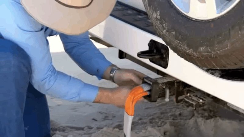

    Been searching and only have found one that gave a trailer hitch class.
    Just think that it is weird that all of trailer weight or recovery energy is held by that 1 little pin.
  3. Jan 17, 2016 at 6:28 PM
    #63
    Mobtown Offroad
    Mobtown Offroad Boss
    Jul 23, 2014
    #134511
    10,797
    Joe
    Harrington, DE
    2002 SR5 4Runner
    It does seem weak when just thinking about it. But it's hardened steel and takes a LOT of force to shear it.

    I just found a spec on Drawtite, they rate their 5/8" pin which is what fits in all Class 3 and 4 hitches their own 31000lbs. That's pretty immense, you also have to realize that their other pin is in a 3/4" holes so it only has +/- 1/16" of play. That small increment would keep very little energy from building up when snatched.

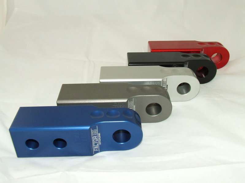

    I like the Factor 55 Hitchlink 2.0. Lightweight 6000 series Aluminum weighs less than 2 lbf. Rated at 9500 lbf with ultimate failure in tests at 51000 lbf.
    http://factor55.com/product/hitchlink/

    So, would you recommend recovering with a snatch strap with just a pin in the receiver as ARB says too, or with a d ring shackle?
    *edit* either will work, but if just using a pin, make sure to snatch straight and not from an angle, that way the edges of the receiver do not start to cut the strap. But very useful to know that you can just use the pin.

    That's all I use.

    Just the pin?

    Yep.
