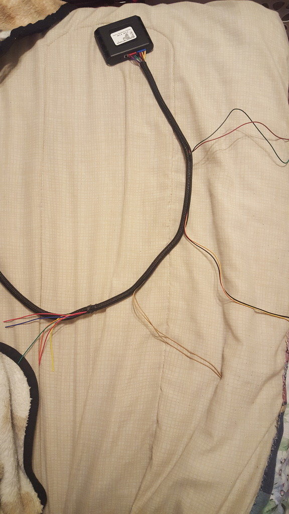

    Before I post in the marketplace, I figured I'd see if anyone here is interested in Nick's pre-voodoo kit. While waiting for the Chicago USPS to finally figure out how to ship it, I ordered and configured my own so I now have an extra one. My impatience is your gain. $65 shipped and will send it priority mail. Run-time is set for 20min but I can change it to anywhere from 1-60min if desired and I'll throw in 2' of the wrap-around tubing pictured below.

    Kyflintlock
    Kyflintlock New Member
