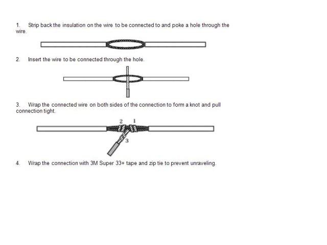

    This will be first attempt to solder onto existing wires rather than using t-taps of some sort - my question is do you solder the new wire (coming from the dball) across the oem wire forming a cross shape wrapping around the oem wire or do you solder the new wire onto the oem wire in parallel? Does this make sense?

    I do a splice similar to this, then solder over it:
    http://makezine.com/2012/02/28/how-to-splice-wire-to-nasa-standards/
    Edit: This is another good one:
    http://www.instructables.com/id/Splice-Cable-Like-A-Rocket-Scientist/?ALLSTEPS
    Also don't forget to put the shrink tube on before soldering...

    I just wrapped around the wire and soldered it. For something like the auto-headlights where you cut the wire, the above will work. For splicing into an existing wire, most seem to what's called a military splice and apparently nasa certified. http://www.gm-trucks.com/forums/topic/155344-military-splice-how-to/. Some also wrap it around both sides like militarysplice_1c9f35ad17e2aecbd92c7537f6d2018443a5bbb9.jpg
    Get some 24 and 26AWG wire and practice practice practice. The dball wires are 24, ecu wires appear to be about the same size and the obdii connectors are the smaller ones so be careful when stripping those. Don't even bother trying to get wire strippers on anything other than the dball wires. Use a good sharp x-acto knife and scrape away the insulation while keeping the blade as parallel to the wires as possible. Some also score two circles around the wire the desired distance apart and then split the insulation between the scores and peel off.

    Thanks for all the info guys. I am not new to soldering at all, but usually I am soldering connectors onto wires (xlr, 1/4, rca, etc) and wires to wires, but I just haven't had to do it where I have to strip the jacket off a wire without cutting the wire so I will practice this method.

    How do you insulate? You can't use shrinkwrap can you?

    For this install I just cut the wires and put heat shrink on them. If I need to remove it I'll just have to solder the factory wires back together again.

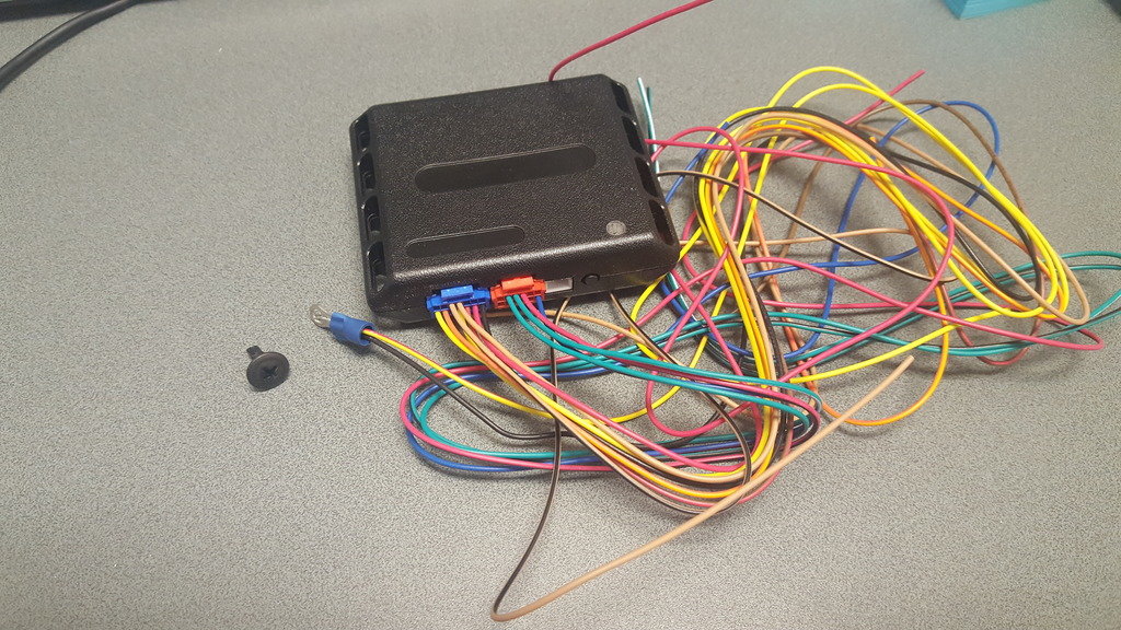

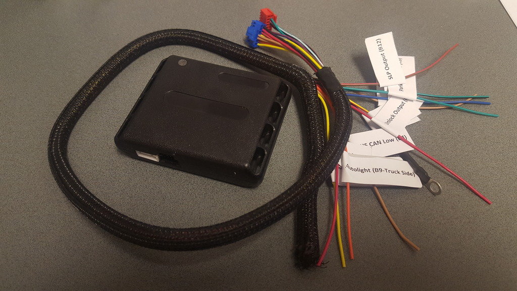

    Not quite $45 but I'm selling one for $65 shipped for anyone who doesn't want to go the ebay route and are looking to save a bit of money on a pre-configured kit. It's the initial pre-voodoo kit that I bought from Nick for $70. I ended up deciding to do it on my own so I have this one as a spare. I redid the ground terminal and heat-shrinked it since insulated terminals look like crap, labelled the wires and will also include 2' of the wrap-around tubing I used in my install.

    Damn - already ordered mine and it has shipped. Like how you placed those labels on them
