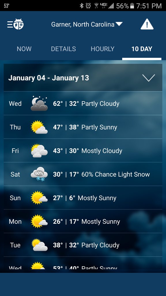

    oh shut it. On the bright side, it looks like the remote start is about to come in handy here and in a lot of the SE.
    gpb[QUOTED] likes this.
