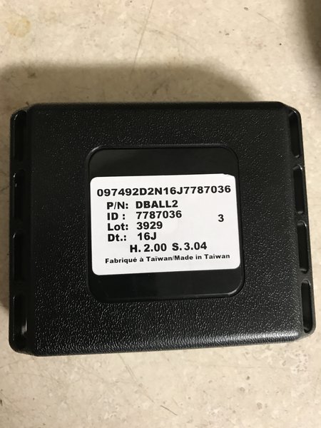

    Just finished installing my AutoStart system from FullMotionHT, the install went perfect my only scare was cutting the auto headlight wire, I use Posi-Taps for the wire connections, Also installed the Smart Start module Clay even activated it for me and tested it out from his shop. the unit works perfect so far. Only 4 wires to mess with it would be just 2 if I didn't have the Auto Lights. Not trying to take anything away from KB Voodoo but for those that's on the fence with splicing all the wires this is the unit to get.

    I just finished the install on the same system today. Full disclosure: I originally recieved the kit last Sat and installed it that night but had a bad wiring harness. I called Clay (ph# included with the starter) and he answered right away. He sent out a new harness the next day. I received it today and it works perfect. This is a rediculously easy install! My truck does not have the tech package so no auto headlights for me so the parking light switch wire tap is optional. Really only one wire that has to be tapped and the rest of the harness plugs into the OBD2. The OBD2 is sill fully functional and wires/harness and device are easy to hide. I've only tested it a few times but so far it seems to work just like the others. It's a dball2 unit. Worth the cost to me as it is super easy to install/uninstall
