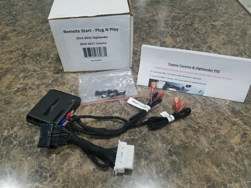

    I don't know all the ins and outs of the remote start stuff but this system gave me what I wanted at what I feel is a fair price. I've used it for a few days now and it seems to work just like the other factory fob setups. The bonus is I can install it or completely uninstall it in 10-15 min. That alone is worth an extra $100 to me. If I'm not mistaken I can also install smart start or other add ons being that it's a dball2 device.

    The picture posted by Paul is the kit without Auto Lights, and it was before the last firmware update. The parking lights are now covered over the data stream, so in his applications, He'd literally use the OBD2 harness and the SLP wire and thats it.
    In David'S applications, his Taco has Auto lights, and he already had a Smart Start in hand for the install. On his harness, he used the OBD2 harness along with 3 wires (SLP, Lock, Unlock) to hook up and the auto light interruption. He called me after he was done with the install so I could get his Smart Start set up for him and it didn't take him very long to do the install. All the kits now include the new harness.
    We solder all of our wires at the shop. We include the t-taps and connectors on the wires in the event someone doesn't know how to solder or doesn't have access to the equipment. If they do, great... chop off the connectors and solder the wires. Either way, everything needed is included.
    Heres the road map to the number of vehicle wires you will have to splice into for your specific application:
    Vehicle w/out auto lights > T-harness and ONE wire
    Vehicle with auto lights > T-Harness and TWO wires
    Vehicle w/out auto lights & Smart Start > T-harness and THREE wires
    Vehicle with auto lights and Smart Start > T-Harness and FOUR wires
