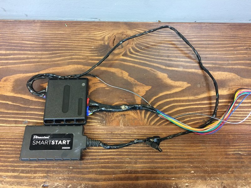

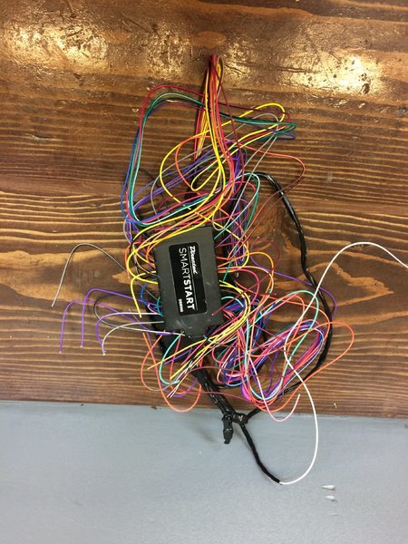

    Some of you are messaging me about whats prewiring
    The bypass had some 56 wire on it. You only need 9 (11 if auto-light equipped )
    So before
    After: (Smart Start not included)
