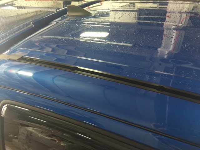

    Rhino has a track that goes into the rain ditch under the weather strip that allows you slide your cross bars to where ever you want them. Thule, rhino and yakima are all adaptable with this track system.Tacoma_Ditch_Track_2016_2.jpg

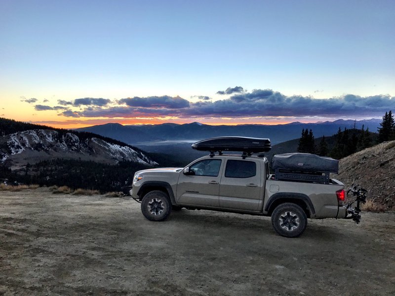

    I have a Yakima StreamLine system that uses feet and crossbars, but if I had it to do over again I'd go with a Prinsu or do the Rhino Rack track system. Although it's been reasonably solid and problem free, it is a bit of a pain to put on and off and isn't as good of an attachment style as using the tracks or a Prinsu style rack.

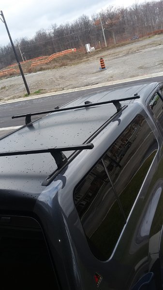

    If you just need 1 cross bar on the cab, this is what I did...hard to see but i added Thule landing pads to the factory drilled holes above the rear doors. Now I can spread the cross bars to the cab roof if i need more width20161205_141354.jpg
