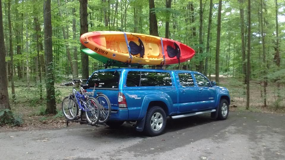

    This is my old truck but my new truck has the same set, I just don't have pictures. It is a Thule rack and the larger kayak is I believe 13ft.
