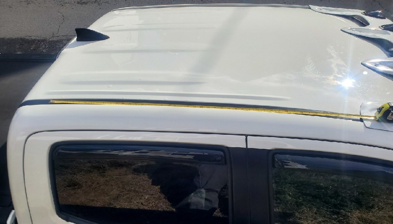

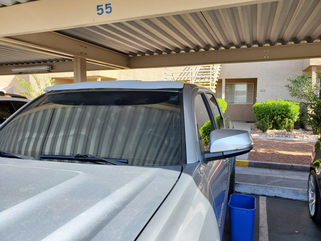

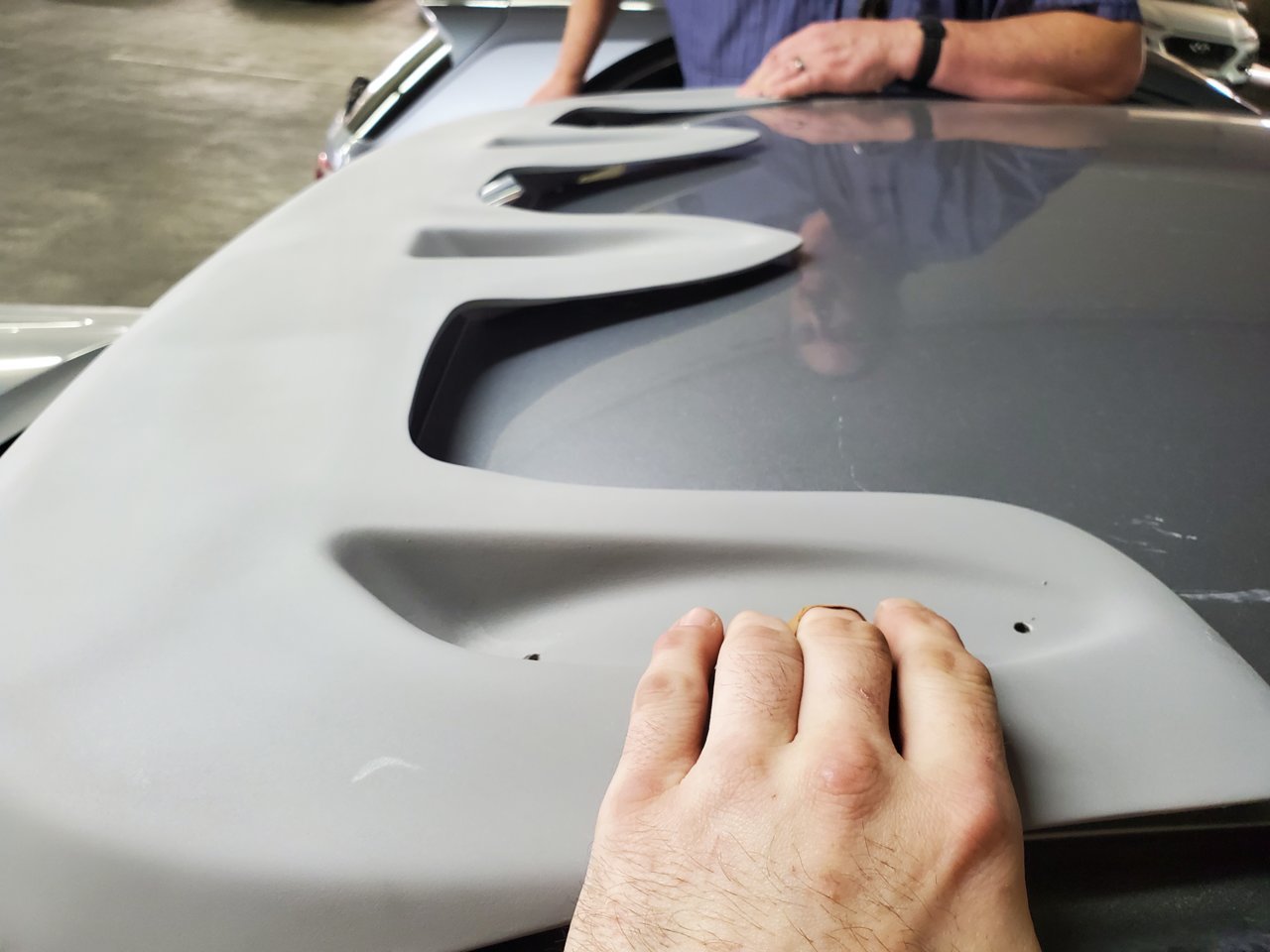

    I'm a new member long time stalker and I recently posted some pics of my truck on here and on Facebook and I have gotten a lot of questions about my visor. So I figured I would try to make it easier if someone was interested in one to post what I went through and ended up with.
    I found a few websites selling visors for the 3rd Gen but it seems that only one actually makes them called JSP America.
    JSP America claims they make them and sell them to the other websites for resale.
    I also believe they bought all the old LUND visor designs because their part numbers are the same as LUND's was.
    The salesperson also told me to order from their eBay store because that was the best deal.
    https://www.ebay.com/str/GoGo-Racer

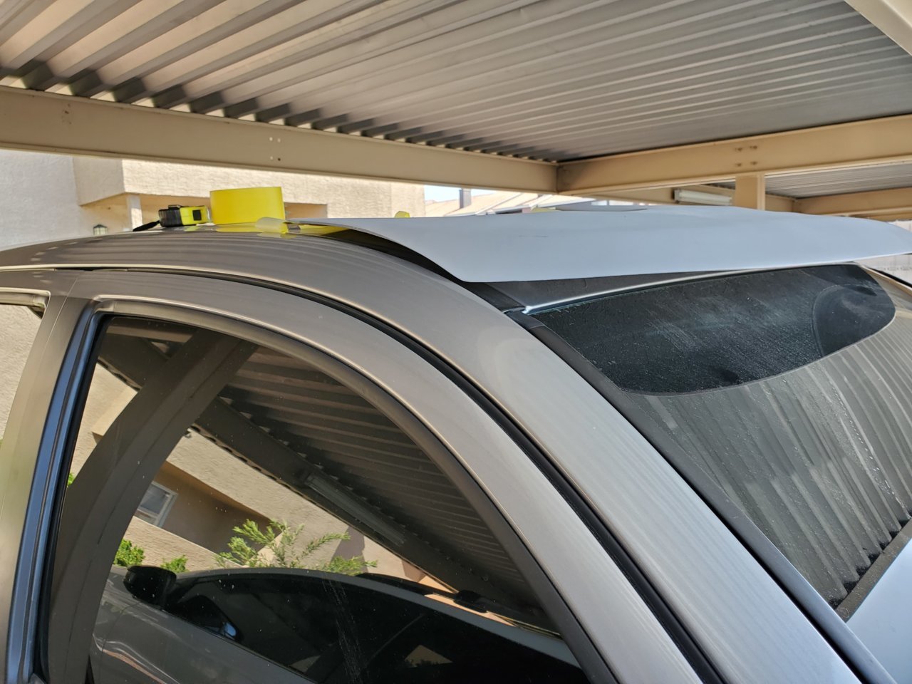

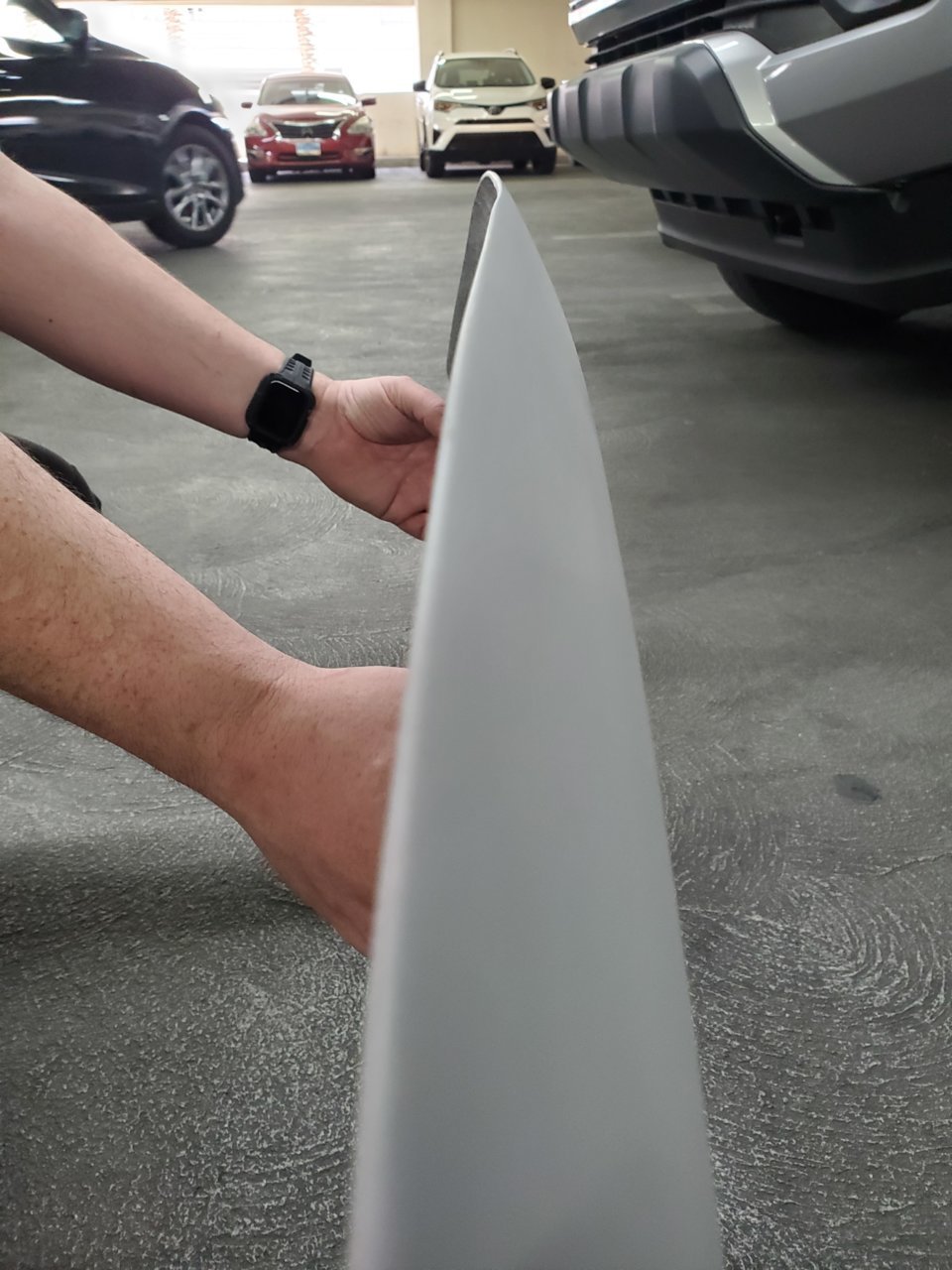

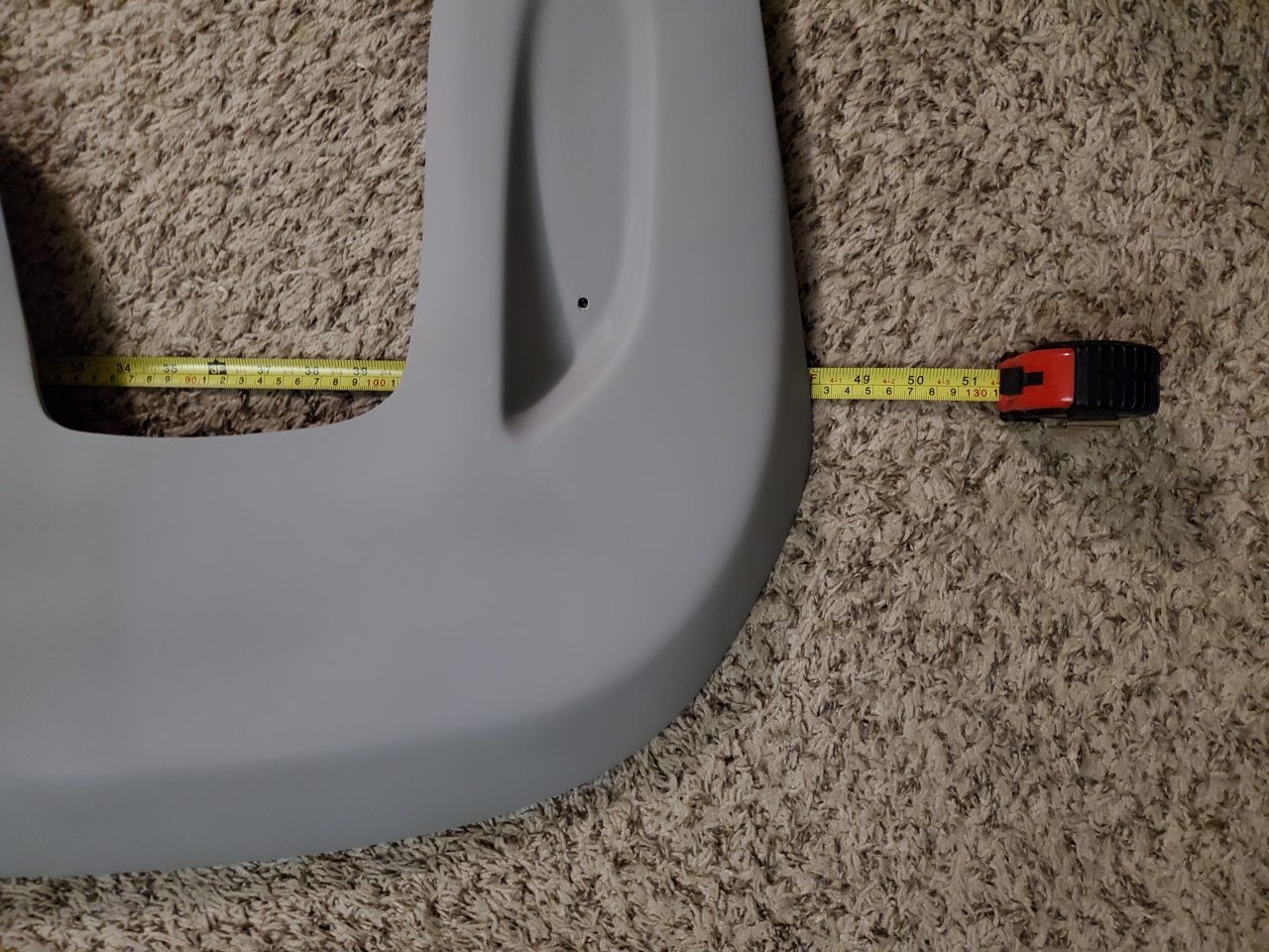

    1st Try
    So I ordered the JSP 3rd Gen Visor part number 523002 and it DID NOT FIT :(
    The 523002 was only 48" wide, same width as the Taco cargo rack from 2005 to 2020.
    I called JSP and I had no problem returning it and they said they are going redesign the 3rd Gen visor.
    JSP 12354
    But I didn't want to wait so I ordered the JSP 2nd Gen Visor part number 12354 off of eBay $229.95.
    https://www.ebay.com/itm/JSP-Truck-Cab-Sun-Visor-2005-2015-Toyota-Tacoma-Primed-12354-/281800915981
    Lights
    I wanted dark tinted roof running lights with Amber LED replaceable bulbs.
    So I ordered Partsam 5pcs Smoke Cab Maker 264159BK
    https://www.amazon.com/Partsam-264159BK-Running-Compatible-1988-2002/dp/B073XZL7VM
    If you decide to buy these lights, they come with cheap real soft rubber light sockets that the bulbs will melt the first day :mad:
    I replace the light sockets with some hard plastic ones. I went to Advance Auto and got them, I haven't had them long enough to see if they are any good or not.

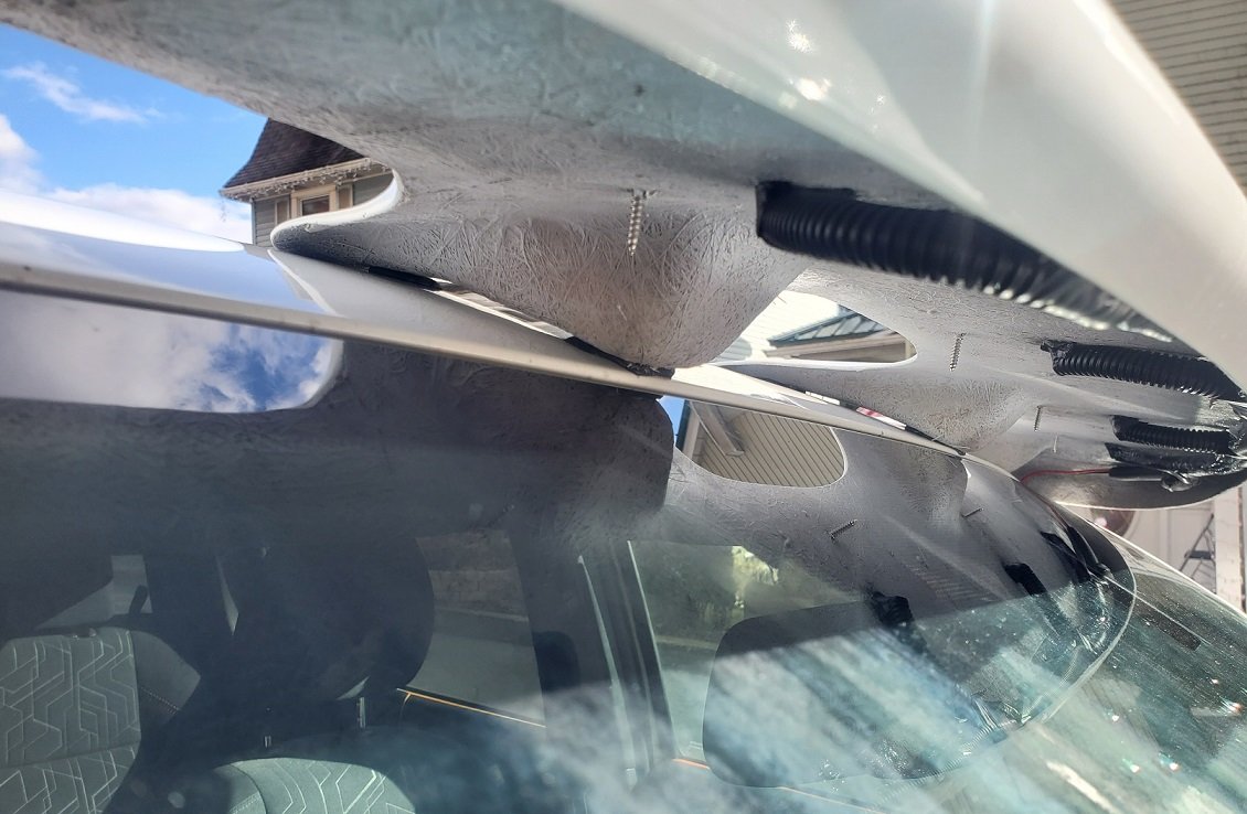

    Install

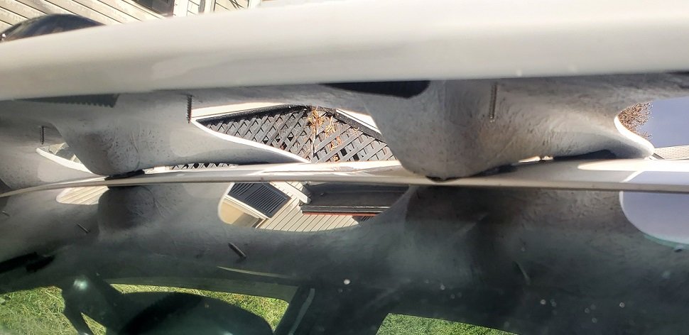

    The Visor comes with 8 self tapping screws & caps which I had the caps painted too.
    I didn't see them install it but I would guess they drilled some small pilot holes.
    They ran the wires under the windshield trim then under the hood so that's one less hole in my roof. They tied the wiring into my drivers side running light.
    Where the screws are and a small area around the screws is the only place where the visor touches the roof and that's where they put silicone or some kind of sealer.
    I paid $449 for paint and visor + lights & wiring installed.
    Yea I know, them screws came with the lights and a little to long :facepalm:I'm going to replace them.
    Con Not sure why they designed it like this but where the front screws go, that area holds water when it rains. :confused: Maybe it blows out when I drive, I'll have to wait an see. Might be able to drill a little pin hole to drain it if it doesn't blow out.
    Roof Rack?
    I had some questions about roof & cargo racks. I don't know where the front holes are under the molding strip, but the visor covers the front seam of the molding strip.
    The visor is 46" from the molding strip seam towards the back to the visor.
    Noise
    I don't hear anything from it, but my tires are pretty loud.
    Happy Time :bananadance:
    So visor, lights, paint, new sockets, and installation I got around $700 in this visor.
    I'm sure others could get it done for cheaper but I am real happy with the outcome.
