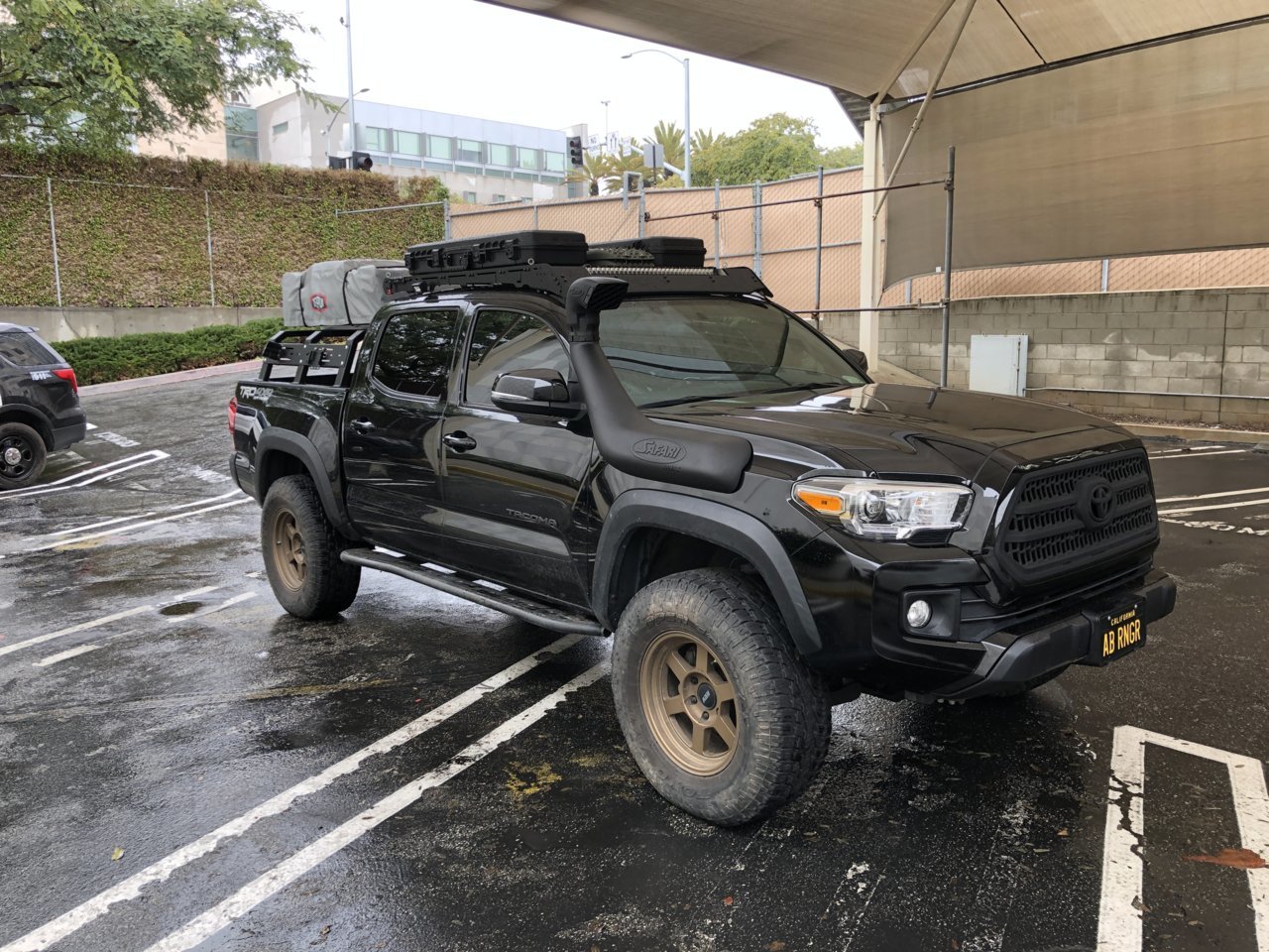

    The bulkiness has a purpose. I think it’s supposed to have 10 percent improvement in airflow than the older ones. I just got mine and it looks great.

    It just seems like it'l suck in more dirt facing forward. There's no real ram air effect going on, the engines aren't designed for that.
    But yeah I do like the way they look, when it's swept back it's less of an obstruction.

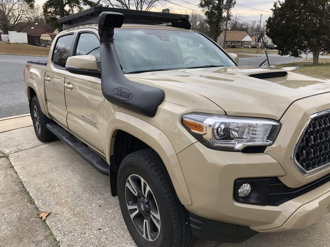

    So I followed your instructions perfectly and everything turned out very well except for the tape holding the snorkel onto the A-pillar. I used the same tape as you and it keeps coming off. Any suggestions?

    I just ended up drilling holes. Now it’s super stable.

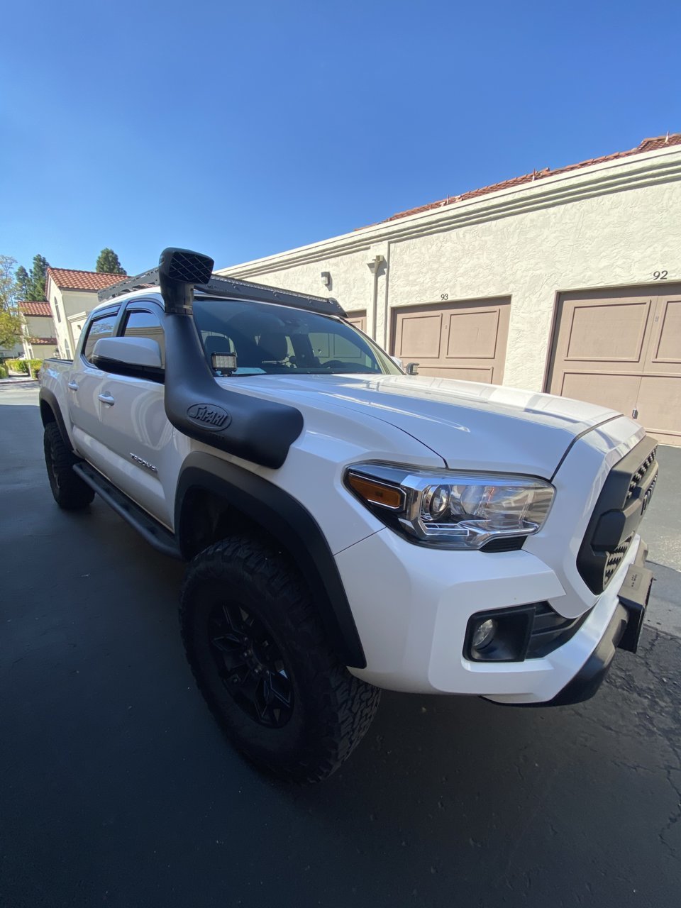

    I want to thank - Hodakaguy ! I followed this write to the tee, job completed - start to finish, 4hours, 40minutes. Looks like a professional did it.
    Definitely would not of been as easy without reading this article, and the step by step pictures, great job !!

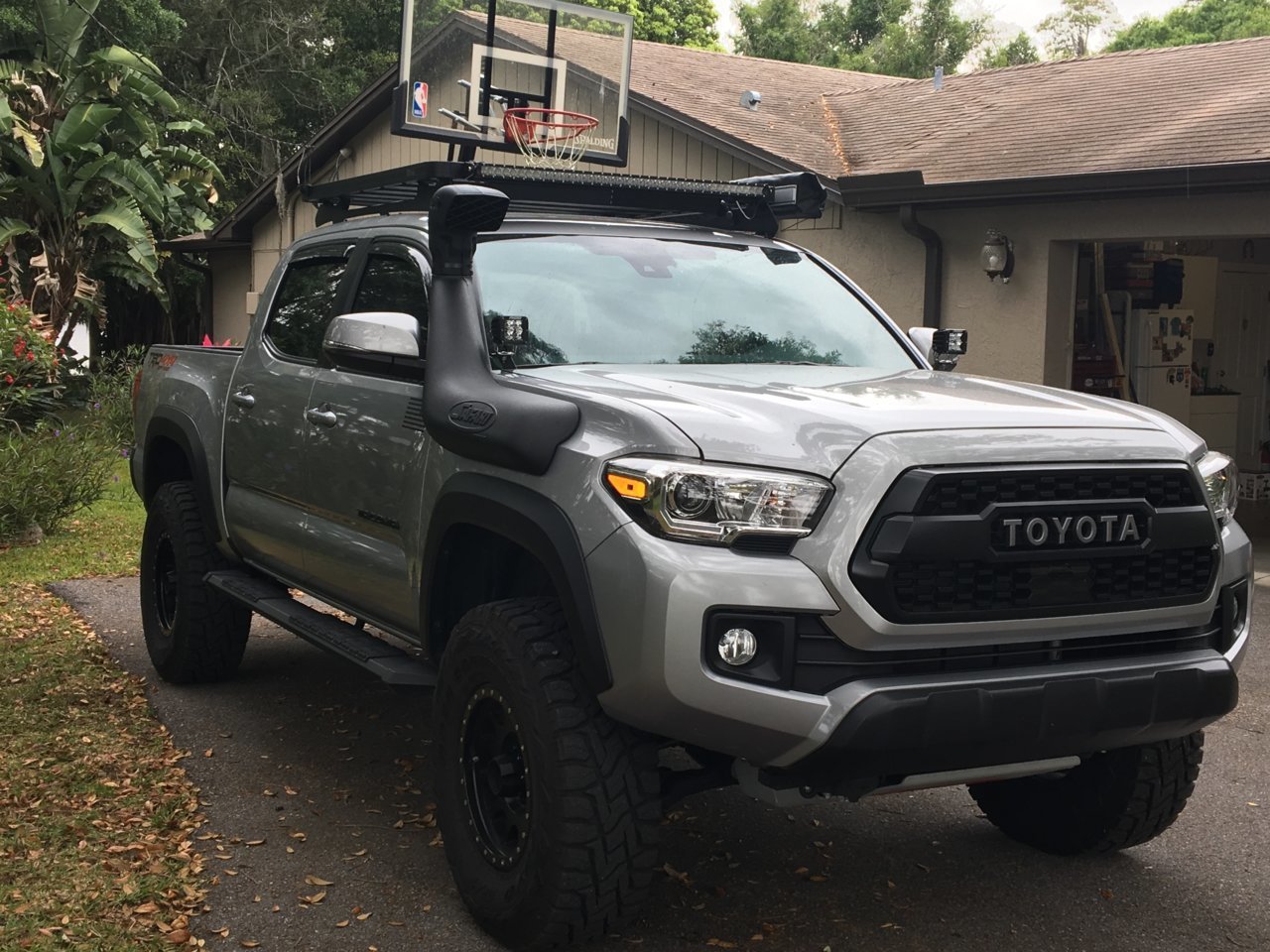

    Write up was spot on! Took about 2.5 hours. I painted the bare metal and then hit it with plastidip so 20/30min was drying time. The bolt above the tube that goes to the airbox was a bitch!!! But all done now! Thanks

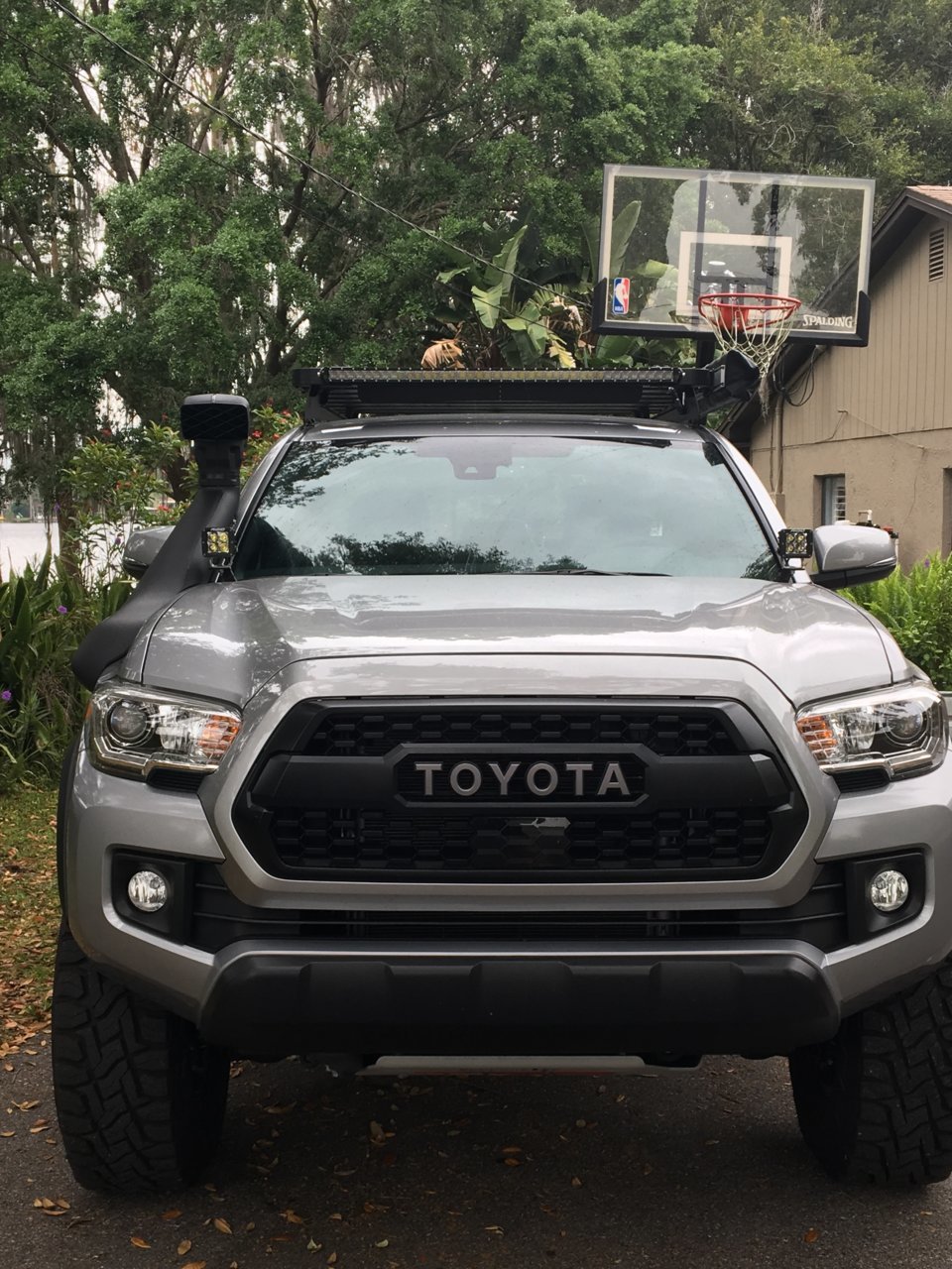

    Greatest write up I’ve seen so far! Awesome. Takes balls to cut into a new truck fender.
