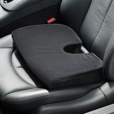

    Just get one of these, saves your ass on the long rides and raises the seat a couple inches

    I don't know if I could stand looking at that every day. Makes me feel like I'm 60 or something haha

    When you’re 60 you’ll need it to help your prostate
