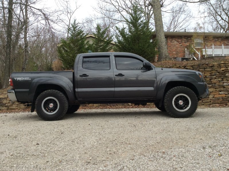

    I just installed some 2016 TRD OR coilovers with 3,000mi. on them. I got 1 1/8" on drivers side and 7/8" on pass. side. They leveled out the "Taco Lean" exactly. The coil with the red and green dots goes on drivers side. I'm at 21 1/8" both sides now and 21 1/2" at rear with my stock spring setup. Very pleased!!!

    Awesome pics! Are you running 265s? I just bought some 1/2" toytec spacers from another member and I am going to couple with this and then do a full leaf pack out back...should make for an awesome relatively mild height and budget lift.

    Yea 265 75 R16 KO2's
    I thought about some 1/4" spacers but decided to keep some rake. If you can find low mileage 2016's you should be able to just add a 1/2" to my #'s. I found that my stock 2013 coilovers had settled over the 3 yrs. I've had the truck.
    Edit: You should do a little more research on your heights. The 1/2" spacer will probably get you closer to 1" added to my numbers.

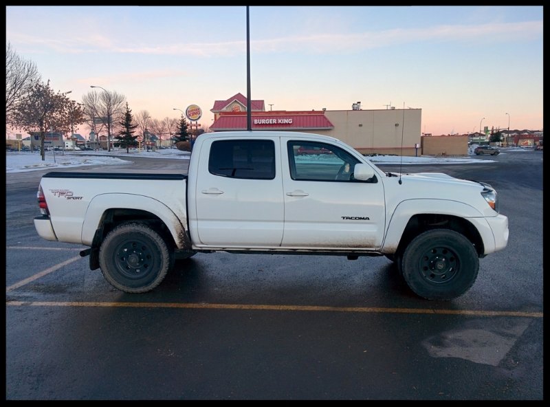

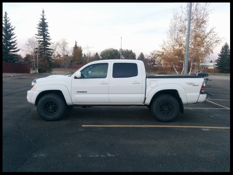

    1" lift from 3rd gen suspension, 265/75/16 ATs
    Before:
    After:
    Got just a bit over 1". I'm expecting it to settle to right around 1". This is also with 265/75/16s.

    Your after pic looks good! I was really getting tired of seeing the 75's stuffed, the 1" made all the diff!! On the vibe, have your front tire balances checked. I had it as well and ended up having to get them Road Force balanced. It solved my problem. Still have to get mine aligned. Can you post your alignment numbers? Thinking I'll ask for 0/2.7/0 ??? Not sure how ASE #'s convert to :canada:
