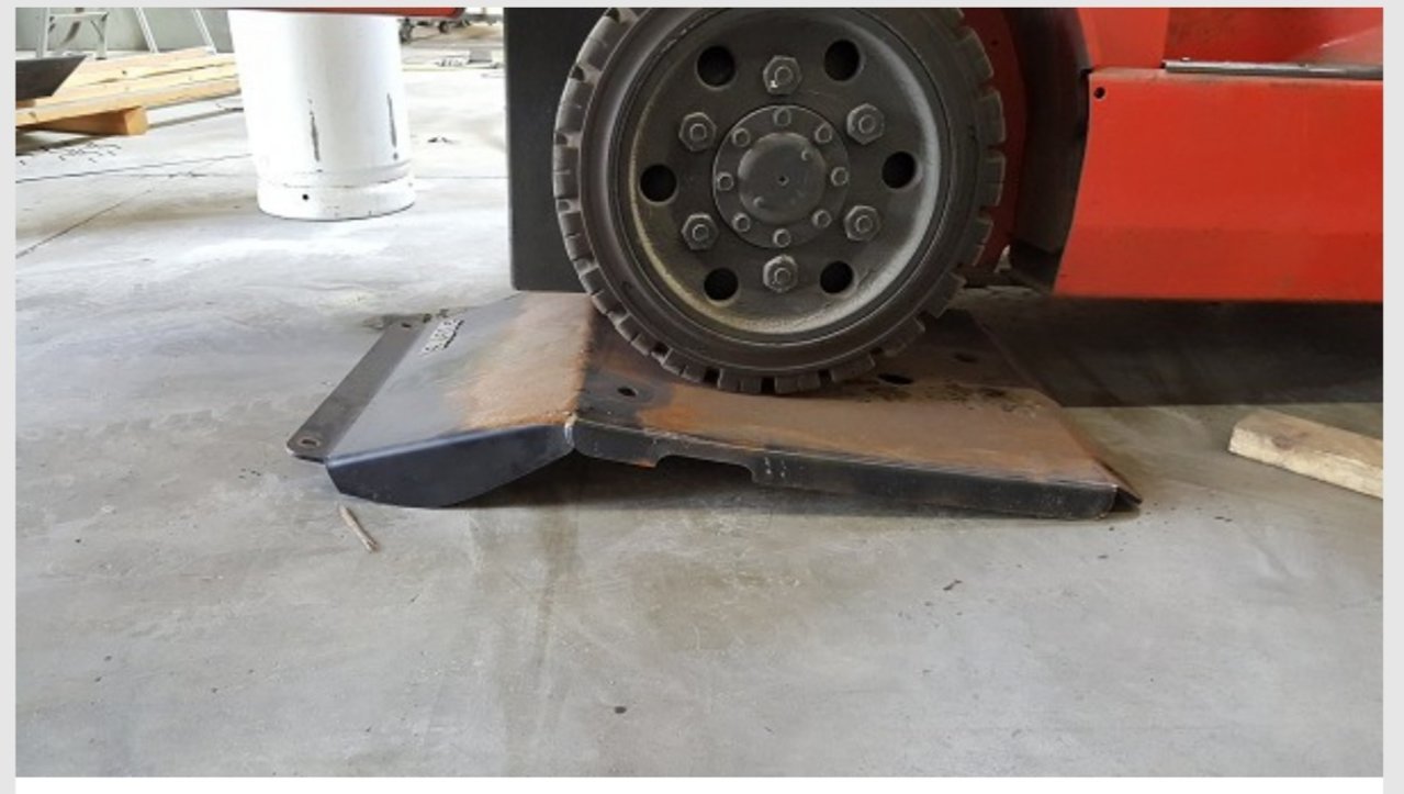

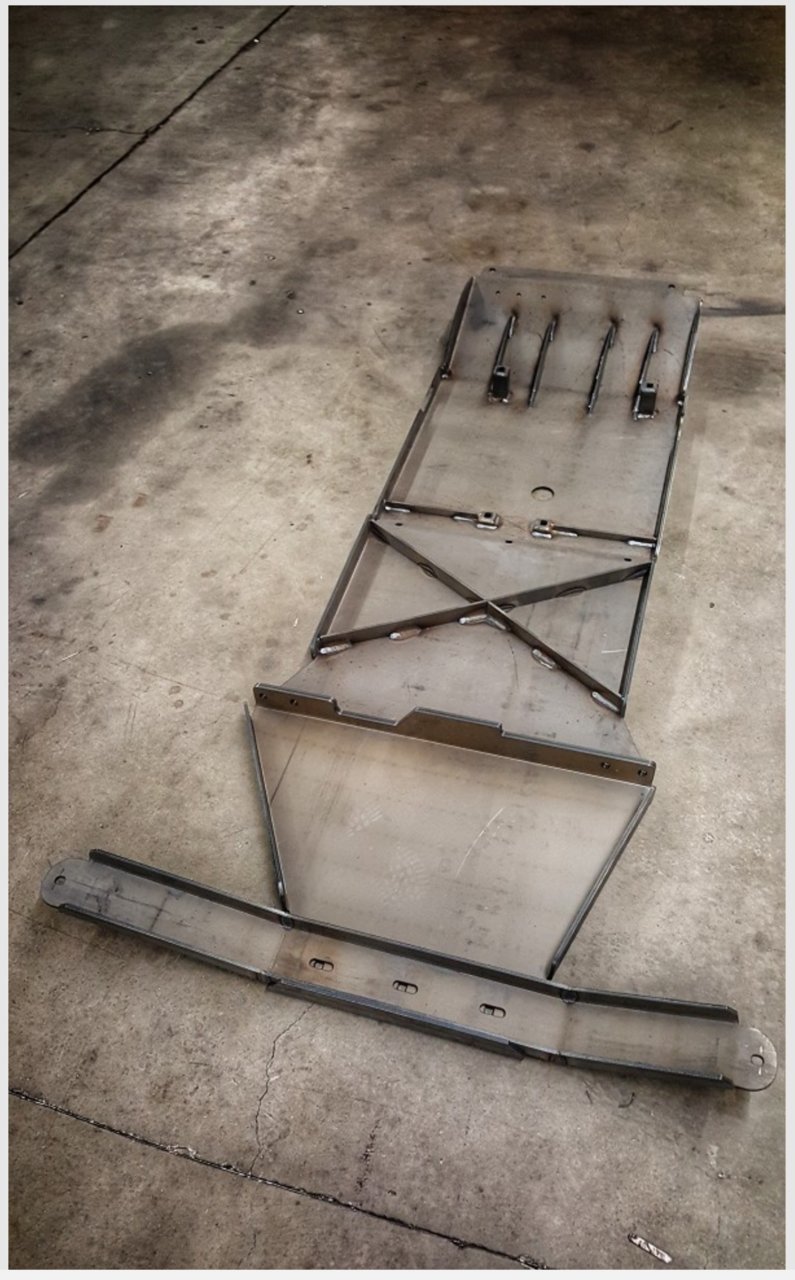

    I'm a big fan of BAMF since I've bought their 3 skids, front bumper braces, rear hangers and shackles which are all 1/4" steel. Their steel skids are not going to bend, see pics below and they gusset and cross brace the backside. Their front skids have two 1.5" risers to the frame which are also 1/4" steel. The total weight is equal to having another person in your truck. I bought bare metal skids and primered and painted for less than $20.
