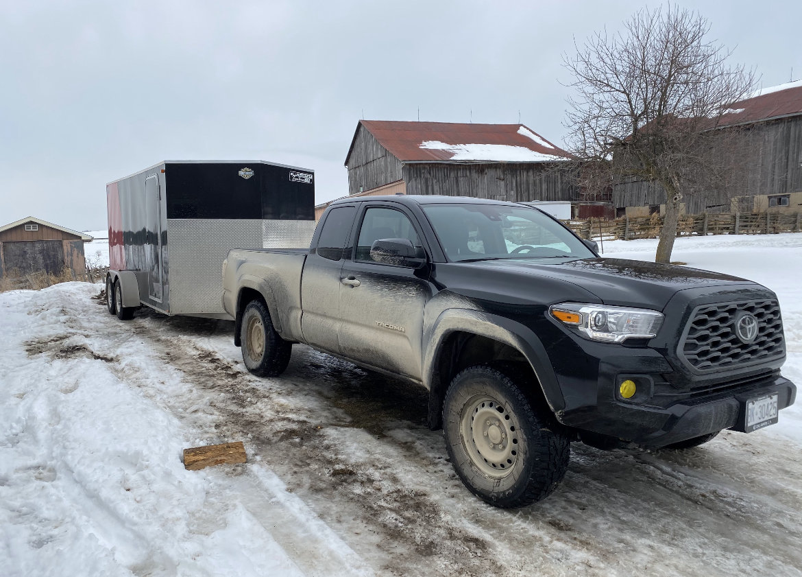

    I use a trailer personally. Just much less of a pain in the ass. Mines all aluminum, 1800lbs empty. Has two 4800 lb axels (way overkill, I know, but thats just how I roll) and it’s actually not a sled specific trailer lol. Just a general purpose enclosed trailer. I haul everything from furniture to atvs to sleds in it. It has a track system for fully customizable 8k lb tie downs. It’s just so much easier to ride up a foot tall ramp into a closed trailer that I can lock shut and have everything protected by the elements. Doesn’t make sense to buy a deck imo.

    2 sleds, a 99 vmax 600 and an 01 venture 600. Vmax is a 120ish track and the venture is roughly 140. Truck feels fine loaded, I haul much heavier than this. Gets about 13mpg. This trailer is about 18ft- if you want long tread sleds I’d look into a longer trailer (23-24ft) and the truck will handle it just fine as long as you get an all aluminum one.
