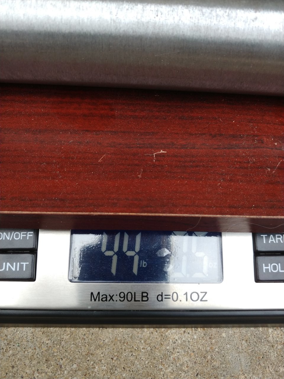

    just to update for anyone interested.
    i received my SDHQ sliders today. they are raw steel and need to be treated. but i did weigh them, and they are indeed super light! welds and metal finishing is awesome, and chrome moly all the way.
    one side:
    all hardware:
